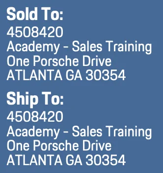

That appears to be the case. Note where it was delivered.
The selling dealership, as a CPO, should have refurbed these brakes. Again I'm going to assume a good-faith mistake at this point, and hope they make things right.
Can you ask for the CPO detailed report from the dealer who did the CPO, and see if one of the inspection points which the dealer claimed they did says brake inspection. If so, have them pay to re-CPO the car by the dealer you trust, since obviously the CPO they sold you was faked. This would of course include the new brakes you had to pay for, possibly other items you don’t know about yet.
So I was right all along :)
Same case for me, car was used for Porsche Trackdays. Yours do not look as bad as mine, but still the pads are cracked, and that's why it was making the noise. It's moving around there.
Great to hear that the dealer is taking care of you though.
Yep you were quite prescient! Since you were in the same boat, have you experienced any other issues with your tracked CPO car? Anything else I ought to have them check?
