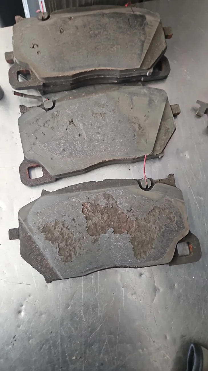

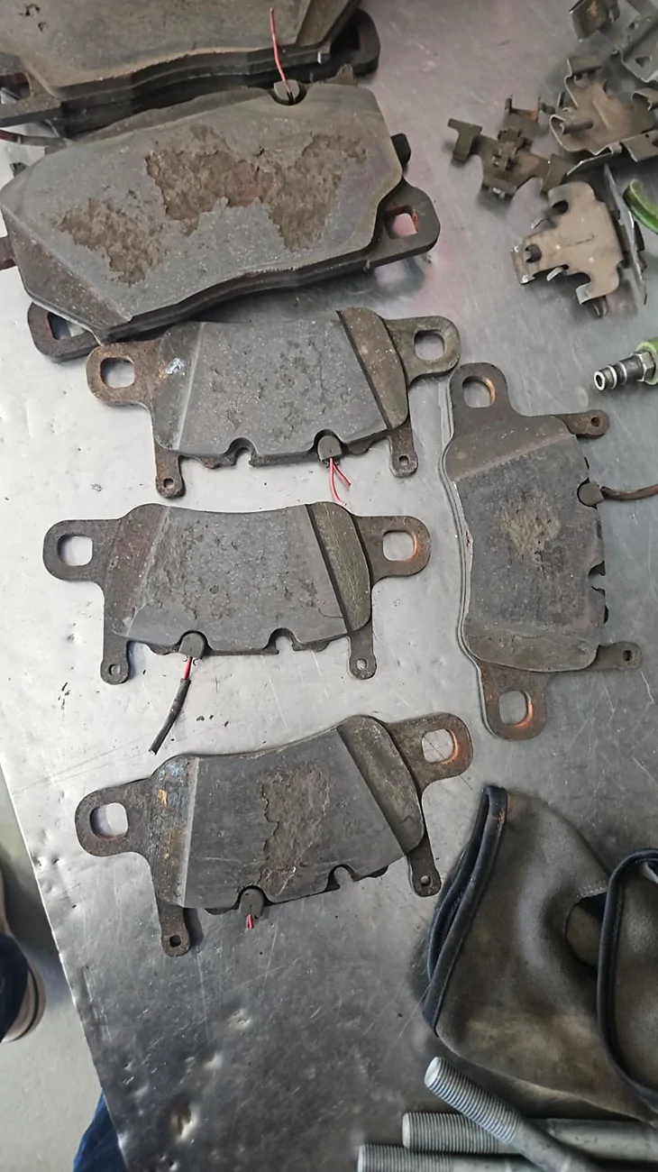

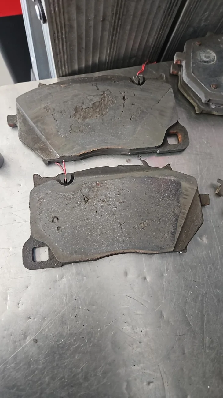

I had the same on my J1.1 Turbo S, and I discovered this:
Porsche Taycan PSCB: Slight scraping sound from front left wheel when in motion WhatsApp Image 2025-12-08 at 00.47.30
Porsche Taycan PSCB: Slight scraping sound from front left wheel when in motion WhatsApp Image 2025-12-08 at 00.47.10
Porsche Taycan PSCB: Slight scraping sound from front left wheel when in motion WhatsApp Image 2025-12-08 at 00.46.53
No more sounds after replacement. There was visible cracking with the wheels off on the sides, but after taking them off it was so much worse.
