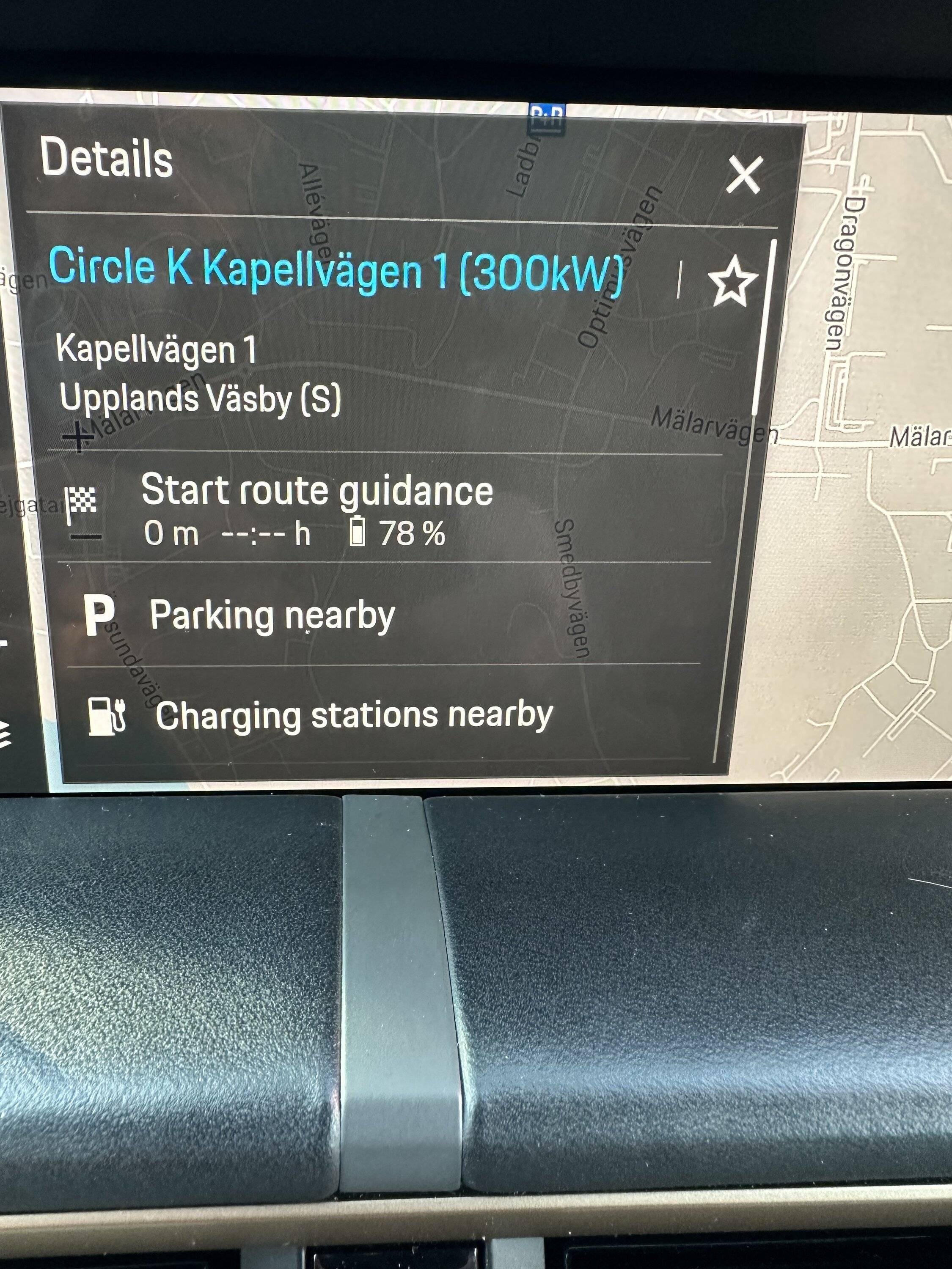

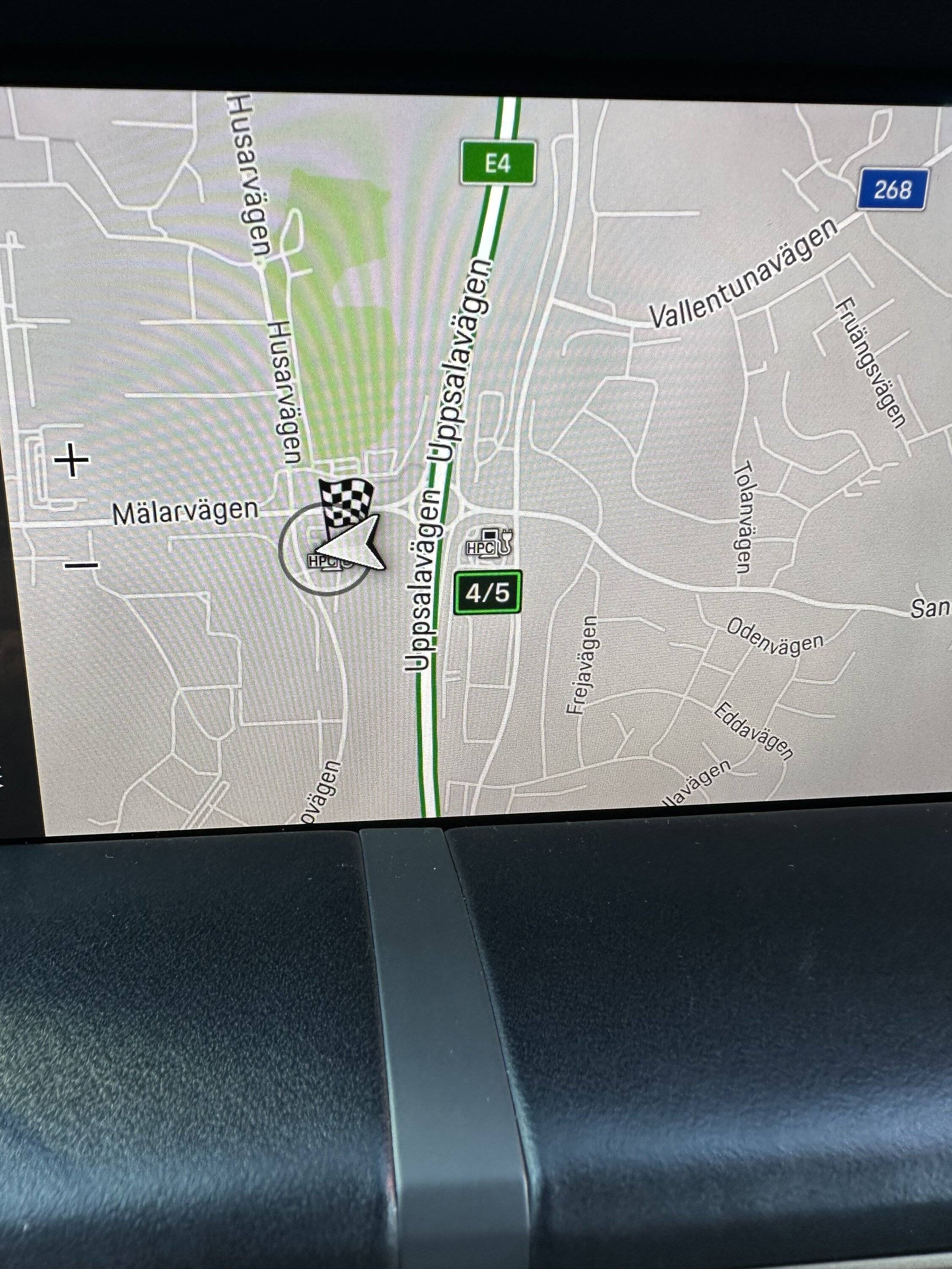

I have a question about all the HPC stations displayed in the PCM? I needed to top up my SoC for a longer trip on roads where charging stations were a bit spare. I could see quite a few close by and choose one at Circle K, stated as 300 kW in the PCM. There were a few more around but varied in speed from 50 kW to 175 kW. I could also see the number of free chargers and total number in each place.

Since they were displayed with details in the PCM, I assumed that they were part of the Porsche Charging Service and that my card would start the charging process??

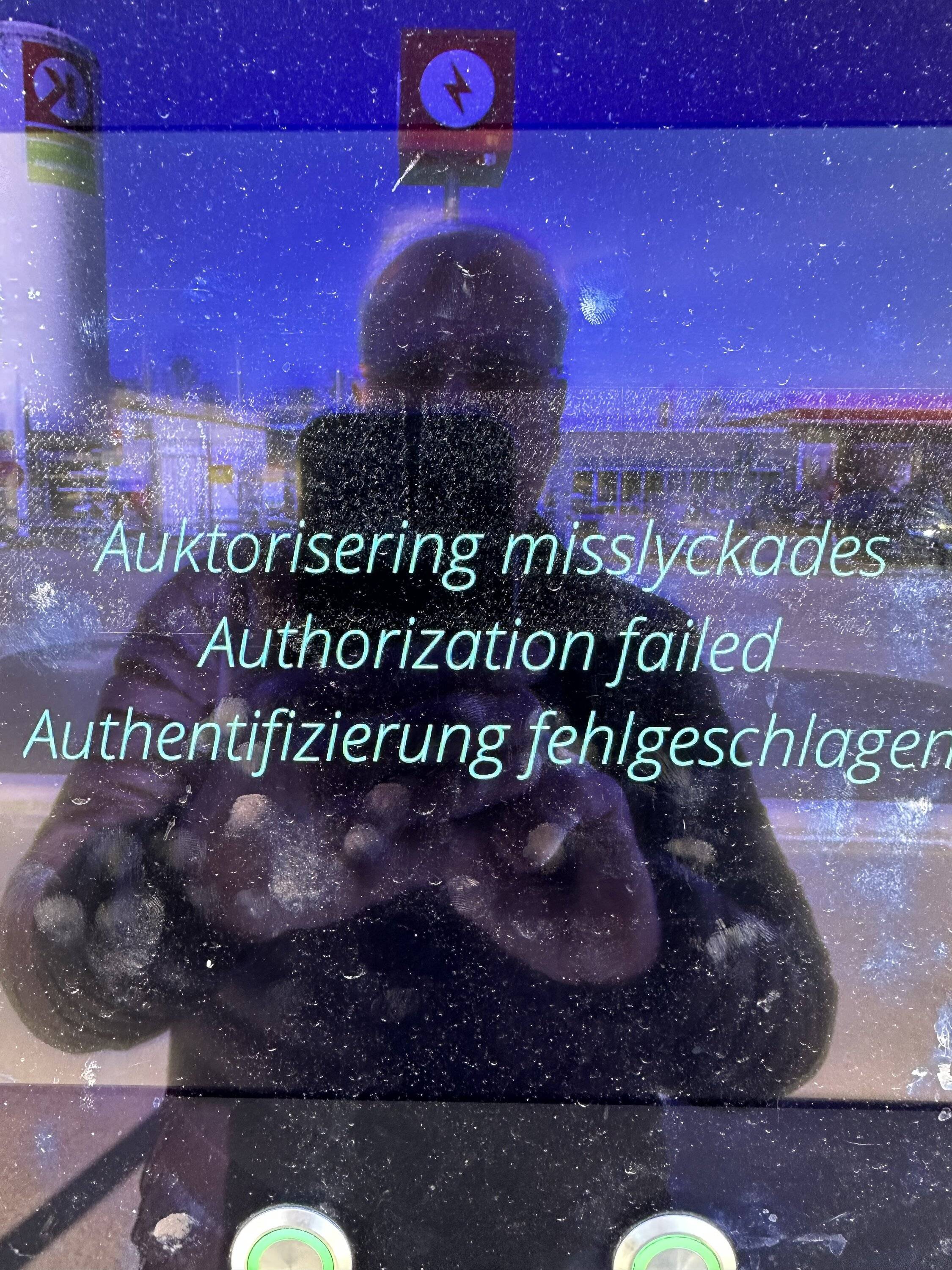

But NO the Card would not authorised and no charging would take place. Phone call to the Porsche service but they were busy and after waiting for about 10+ minutes I gave up and looked for a Tesla SuC.

So my question is
1. Are the stations that are displayed showing ALL stations where you can charge. Or?
2. Are the stations displayed supposed to be included in the Porsche Charging Service??
If it is the first alternative it would be nice to have a filter setting to exclude that view so the display is not so cluttered with that Info. The display can be so cluttered with chargers, that it is difficult to find an Ionity station that can be used.
In this instance I searched for this charger in the PCM and navigated to it. But I have also experienced the exactly same thing by the car directing me to a Charging stop when using the Charging Planner in the car. And then arriving with 3% and the card is not authorised, raised the blood pressure a bit? And I had set the planner to prioritise the Porsche Charging Services
Has anybody experienced the same issues?
Do we know what is displayed??
