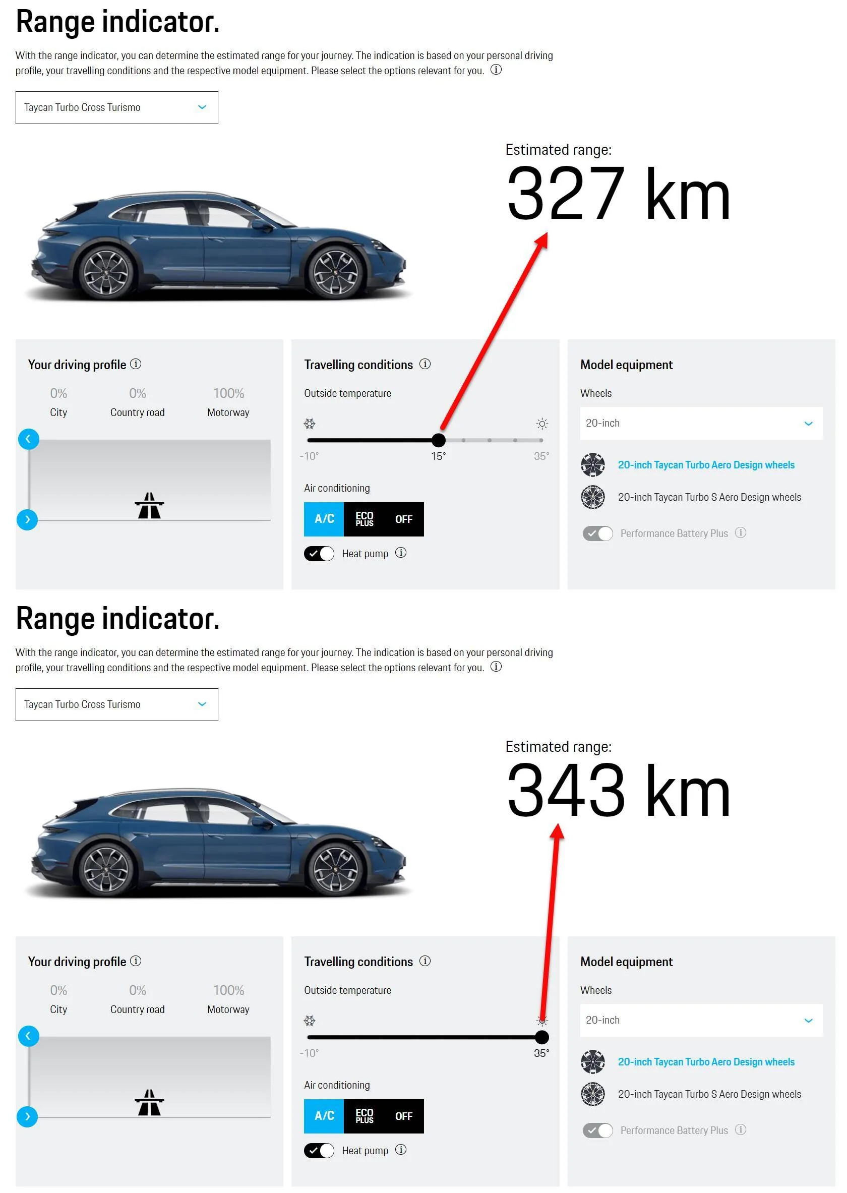

The range calculator shows approximately a 30% reduction in city range between A/C off and on at 30C ambient fwiw.
