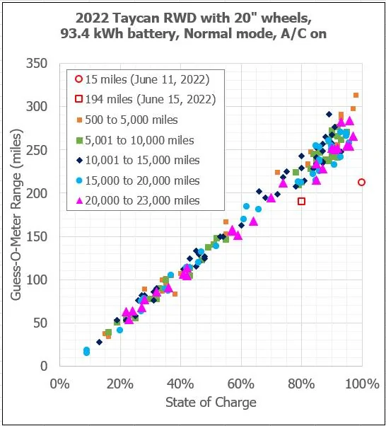

My guess-o-meter reads between 215 and 255 miles at 85% SOC with the air conditioning on in NORMAL mode. Add 20 miles when the A/C is off.

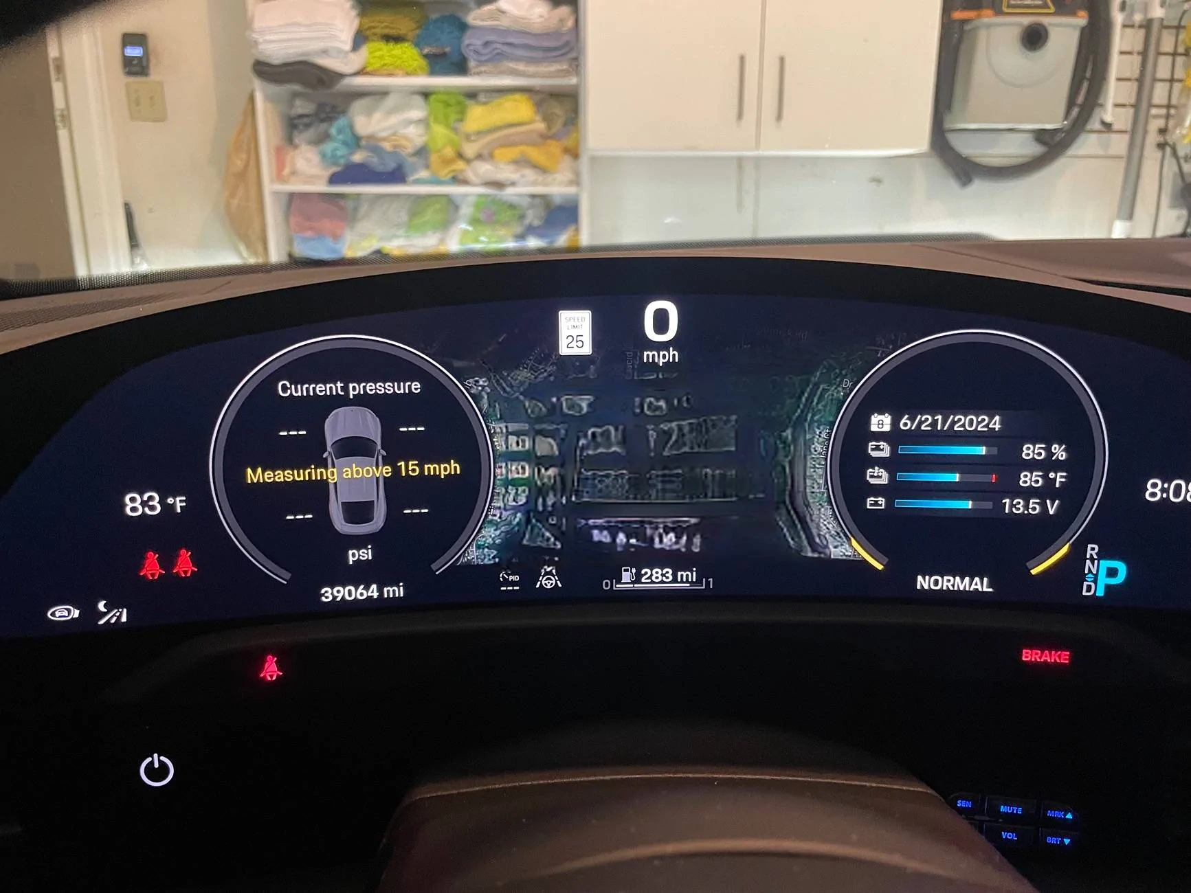

283 @ 85%. New battery, high ambient temp, and very mild driving...

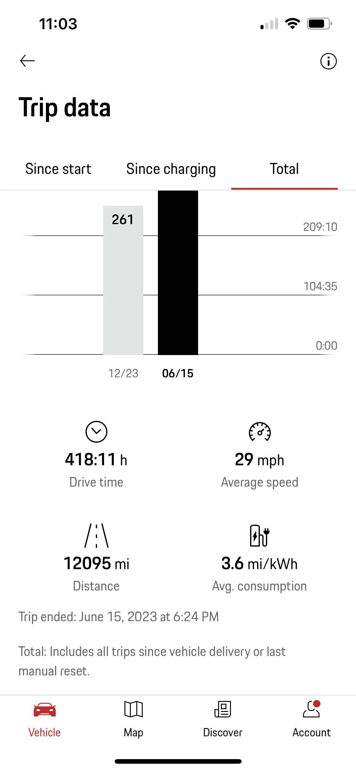

As we've stated in previous threads, this number isn't realistic. I'm not sure what the algorithm is that Porsche uses, but based on my mi/kWh used, the 285 is more like 250. Still quite good, but I'll guess that actual mileage at 100% on a long trip at 70mph in range mode at summer temps would be somewhere around 280.
11,073
6,854
Only consumption numbers (miles or kilometers / kWh) are the real measure as we've said many many times before.
