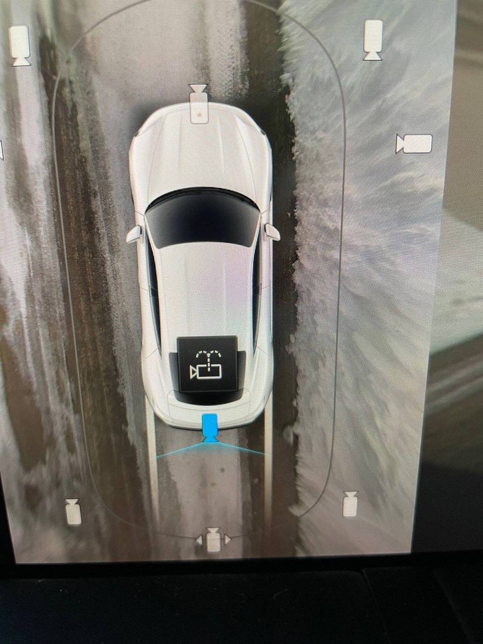

So when I reverse, I get that icon to wash the rear camera. If I press it, it acknowledges the press, but there is no fluid. I tried to find it in the owner's manual and some searching, but is there something I'm missing?
Thanks.
I had the same problem on my 2021 Taycan. In reverse, I pressed the icon multiple times, heard the rear wash motor engage, but no fluid was released. I filmed and took to the car to the dealer. they replaced the faulty washer unit under warranty and it works just fine now (plenty of wash fluid is sprayed across lense) and on the first press.

First of all, does the pump make a sound? You should hear it trying to squirt water even if none is coming out.
If it makes sound, the orifice from which the water comes might be blocked by road junk. Take a needle, and try to unplug the whole. Obviously, the nozzle should be there... if it's not, there's your problem.
Third. It is winter. Assuming you didn't put winter cleaning fluid in, it may also have just frozen.

Nozzle is there and looks clean, the pump makes a distinctive two short sounds, I pressed it 4 times and nothing comes out. Guess I'll add it to my next dealer visit.

My button is on the screen when you hit the backup cam. After several days of trying multiple times (like 16 tries every day for 3-4 days) I finally got some spray. Must have been blocked somehow. It wasn't cold enough to be frozen, but the area was cleaned several times. Hope it works normally now.

I did try last night pushing the wiper control stalk but it doesn't push back :) . Mine is the saloon design, is it on the central console screen? what does it look like?

When in reverse, there is a little camera icon on the lower screen with a little spray pattern. No idea isf it's optional or region specific. It actually works decently now. I mist have tried it 50 times and now it seems to be working normally.
