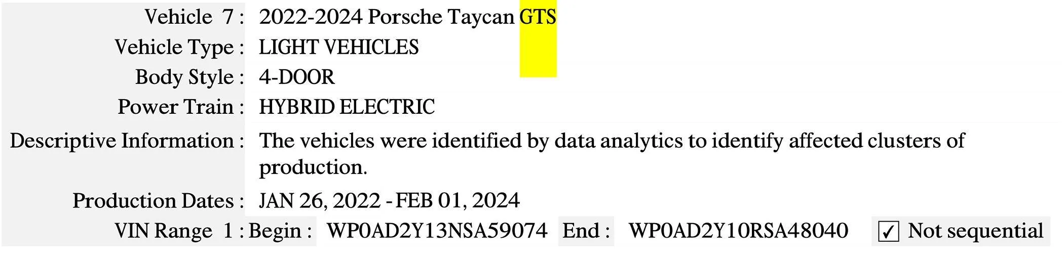

Do I read this as my VIN of WP0AD2Y10PSA47211 being included in APB5?
Hard to say with them being non-sequential. I took delivery in November 22 so it seems like my car would be in that range.

For APB5, the Porsche recall report said:
Porsche Taycan Recall: High-Voltage Batteries May Short Circuit (ARA5) - March 20, 2024 1715964506240-hf
For ARA4 and ARA5 planned owner notification date is May 17, 2024.
Dealers are notified earlier, so best to have dealer check VIN.
Unless your vin is the first or the last one mentioned above, note the ticked "Not sequential" checkbox.
