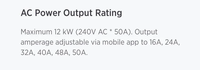

My instructions for the Flex says it can be hardwired for 100a/80a.
Yes (up to 80A circuit), but the Chargepoint is still limited to 50A output, regardless of the circuit breaker you choose. That's also listed in the install guide.
Chargepoint manual
192
7,007
10,478
Charepoint Flex is _NOT_ a 19.2 kW EVSE - it is maximum of 12 kW (which is still awesome) but it is not a full 100/80 amp 19.2 kW EVSE…
right there in black and white - you can have a bigger breaker it’s still safe - but maximum output is capped at 12 kw - or 50 amps - 50 amp charge rate would technically requires 62.5 amp breaker - but don’t sell/manufacture breakers that size - so you use a 70/80/90/100 amp breaker - but max output is still 12 kw - not 19.2 kw
clipper creek, ford pro, and porsche wall chargers are only 19.2kw EVSE i’m aware of right now in north america - there may be others.

Ah thanks for the clarification. Odd they advertise the Flex, very misleading. Basically, it can be hardwired, it can be on a 100a breaker, but it still only charges at max 50a. That's too bad, I thought my Flex was future proofed, though that's not the main reason I purchased it. I'm also courting a pre-owned car with the 19.2, and liked the idea to convert to 80a, though my use case for needing the 5.5 hr charge time at home is limited.
