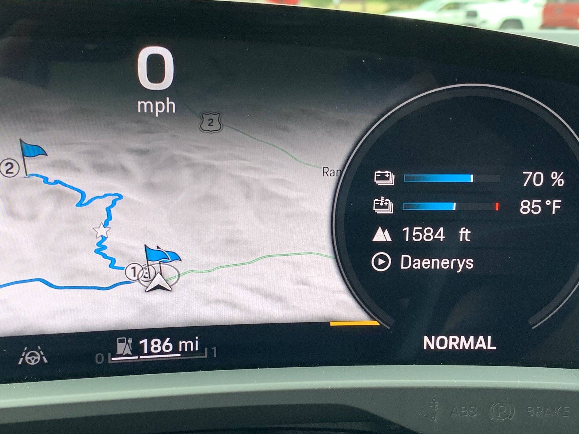

Real world case. No hypermiling, just normal driving.
Start: elevation: 1584 feet, SoC: 70%
Top of Mt Washington: 6154 ft, 55%
Bottom/End: 1584 ft, 61%

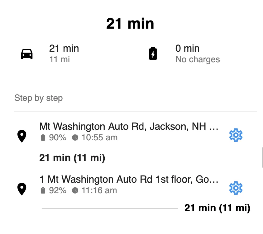

@louv - bit more specific - I"d love to see ABRP's estimate - I know you have real data
too many mt. Washington's in the US for maps to help me without some specifics
thanks.

ABRP - says a LR Model 3 with 18" Aero wheels will pick up 2% on this route…
Porsche Taycan Regenerative Breaking ... A Hypothetical Question Screen Shot 2020-09-18 at 7.55.27 AM
