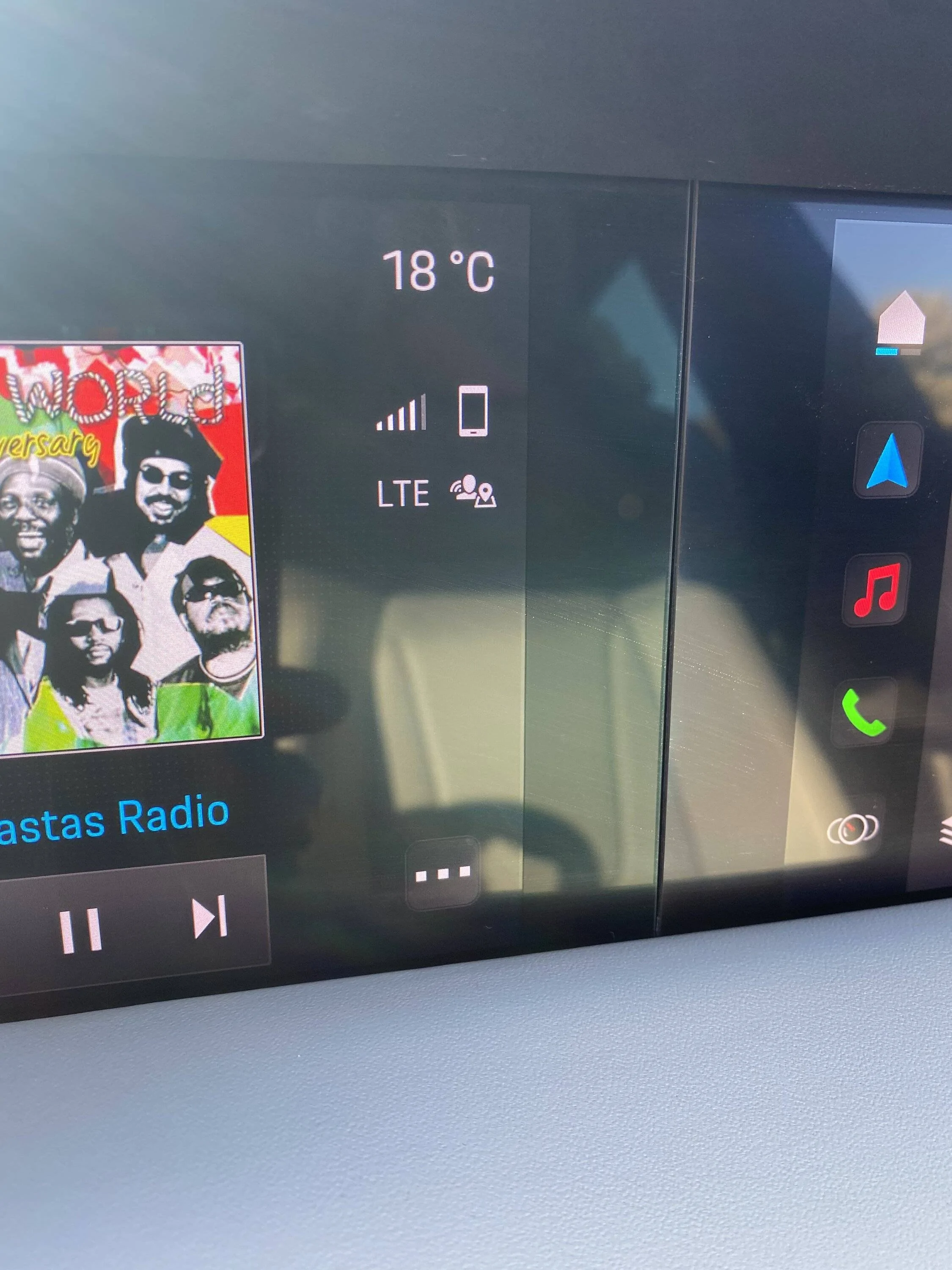

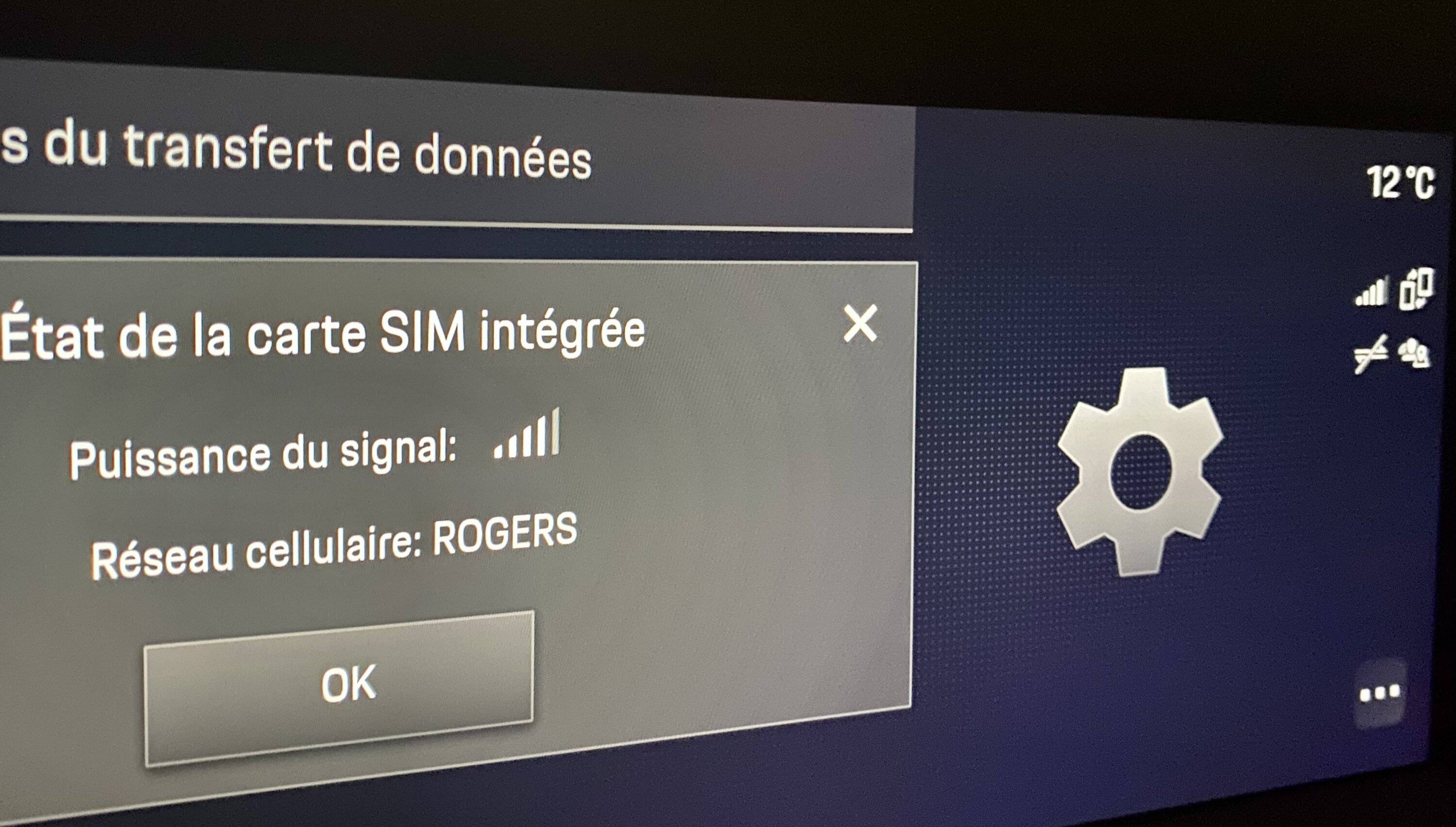

Here’s the topo and a clear picture of
My issue
Good integrated e-sim signal strength whereas the LTE sign changed to the double horizontal opposite arrows of NO connection….

The crossed lines is the LTE connection as you say. That is the built in e-sim and your field strength is shown for that e-sim in your car, as you describe.
There could be an issue with the network for data communication from the car. The capacity of the LTE network my not be sufficient and then the LTE sign will be crossed out. Has there been a chnge of network provider, or has the concentration of cars in the area changed dramatically (for instance roadworks with long queues??) You have the field strength but not the capacity.

Absolutely no change since the uPdate, same region, same area
I have absolutely NO problem with establishing connection with the car. MyPorsche app retreives successfully info from the car and I can send requests any time. When I loose LTE signal for the integrated e-sim card, it is only intermittent while driving, lasts 10-15 seconds and then I loose Internet Radio, and Apple Music Icon greys out. It returns after a short lapse (10-15 seconds as I say) but may recur 4-5-6 times within the same 30 minutes drive.....
