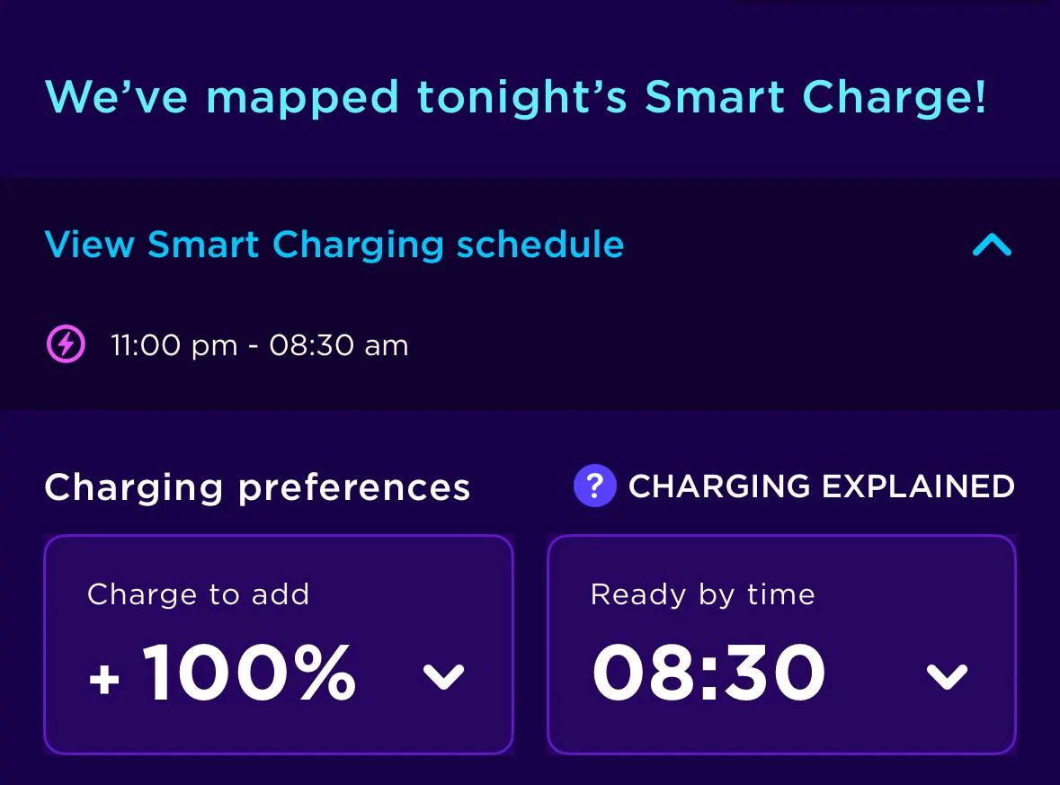

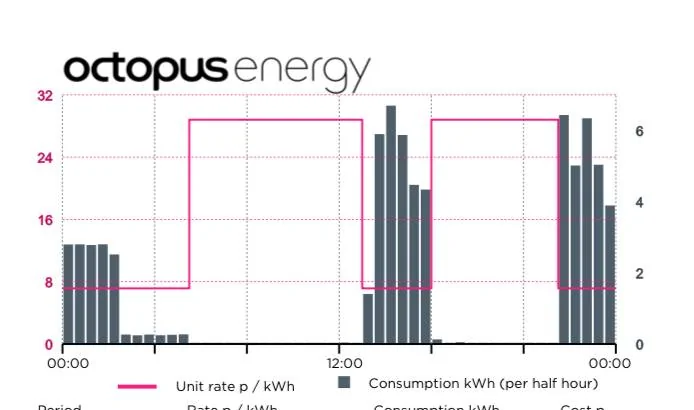

This is why I like to set the integration with the EVSE rather than we car. When you do it this way, you select in the Octopus app what percentage you want to add. Just leave it at 100%. Then whenever you plug in Octopus will try and schedule you a big long window at the cheap rate. There isn’t a way for it to know your current SoC so it can only assume you want to add the full 80+ kWh. I’ve plugged in at midday before and had low rate scheduled from midday to 4pm then 8pm right the way through to 8am the next morning.

I then just use a profile to limit the charge level to 85% in the car.
