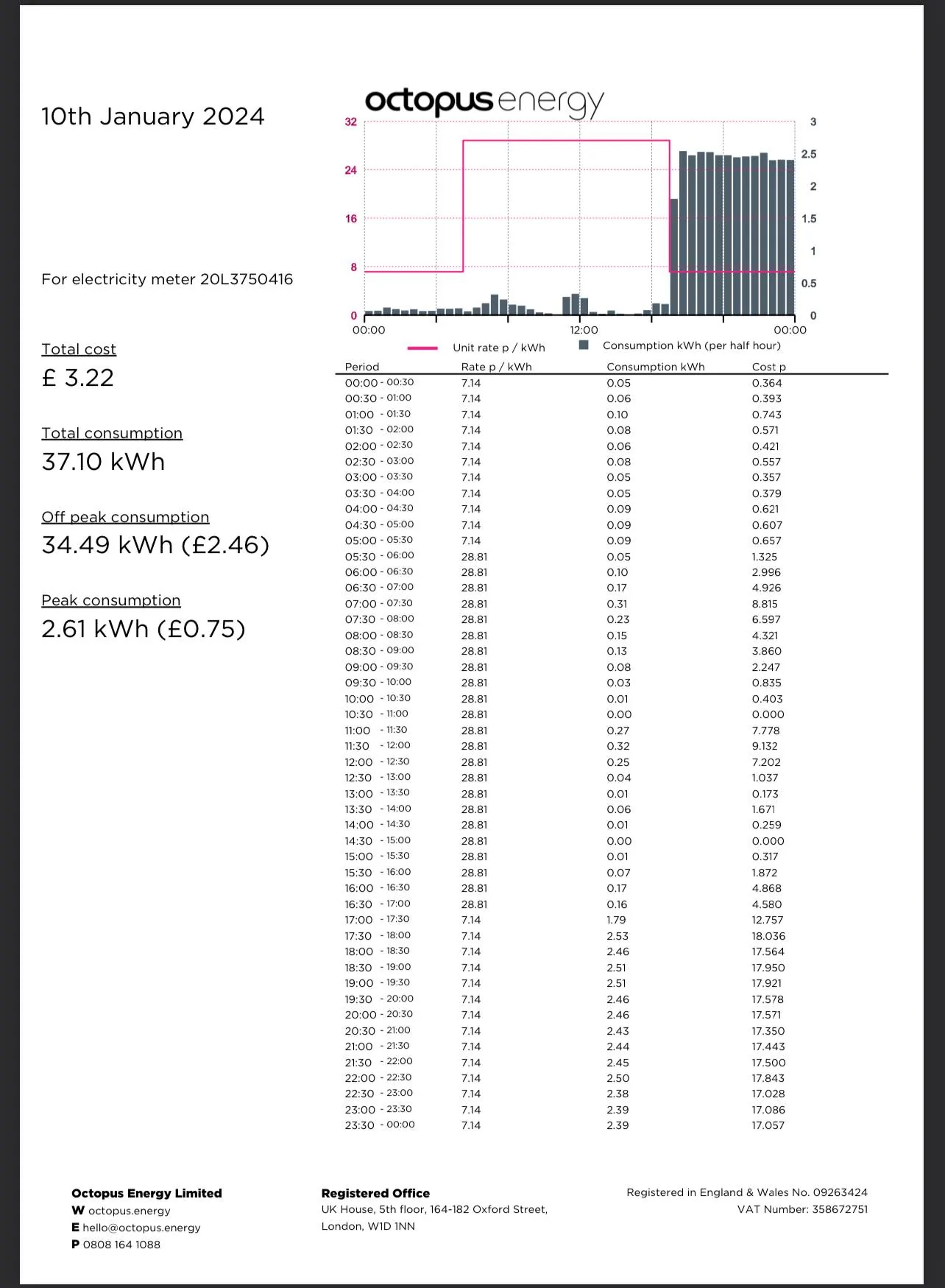

I am on octopus energy. I got home at 17:00 and plugged in. The octopus app automatically set a charging time of 17:00 to 05:30 as I had set I wanted 85% by 0530. As octopus is driving the charge I may think I am being charged the day rate from 1700 to 2330 but when I check my detailed bill for each day in fact I am being charged the cheaper night rate from 1700 all the way to cut off at 0530. Have a look at the detailed pages of your Octopus bill and you should find the same. The 25% minimum is thus a red herring. If you look at the table in the attached image from a previous day you will see the cheap rate kicking in at 1700 when I plugged in
What state of charge were you at when you plugged in? And what speed charger are you using.
That's some great extra hours :)
Today I was around 30% when I plugged in. The zappi is max 7kw single phase. I am drawing 4.5kw /hr right now. The picture of a previous charge where I started with a bigger unknown percentage was drawing at around 2.5 per hour. The main point is it is all cheap rate irrespective of time of day.
That bit I know. I was just wondering how you ended up with a 12hr window.
