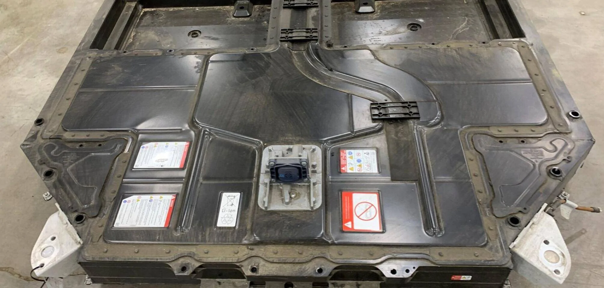

I think I have the answer for you! Testing the battery pack for ABP2 requires a technician to attach a plate in place of a vent (no doubt with a one way valve). It's the black component on the back of the gray assembly. I was told there was a non-reusable part so I started looking at battery packs on eBay to see if I could figure out what it might be. My dealer is saying 2 weeks until the part might be in.
Porsche Taycan 'Replacement Valve' Any ideas? 1695247992212
That component should be relatively easy to get to as it appears to be immediately under the trunk. The adapter on the other end will require removal of the center console to get to.
Bravo (and thanks for such a clear explanation)! Sounds like you are indeed correct as the dealership just volunteered some more info, saying the replacement valve is related to pressure testing the battery as part of a standard quality check before handover. No surprise then that these valves are now in short supply...oh well, what's another 3 weeks hey!?
