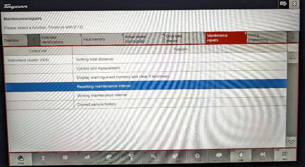

I was able to use the PIWIS again and got it figured out this time. You have to select diagnostics, connect to the car, then select “Instrument Cluster (004)”, then finally “Maintenance repairs”:
Porsche Taycan Reset Service Reminders / Update Last Service Date with PIWIS III 1

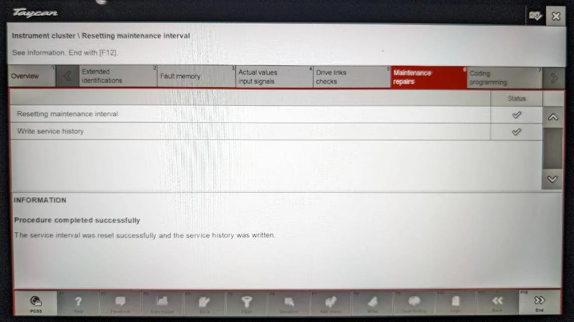

At that point you will be presented with the “Resetting maintenance interval” menu:
Porsche Taycan Reset Service Reminders / Update Last Service Date with PIWIS III 2
The key to remember and only non-intuitive part is you have to first select “Instrument Cluster (004)” to get to where you want to be. If I may editorialize a bit here, I would have to say I am disappointed at the fact that we as owners do not have access to reset the maintenance interval from the dashboard without a very expensive and proprietary piece of software that is not generally available outside the professional auto repair community. Most of our previous vehicles allowed the owner to reset all the maintenance reminders from the dashboard with no special tools. One of the promises of EVs is reduced routine maintenance, but inhibiting the owner’s ability to reset the service intervals and reminders, especially for very simple procedures like what’s involved in the 2 year service is a very bogus move! This is something we are going to keep our eye on when considering future purchases.

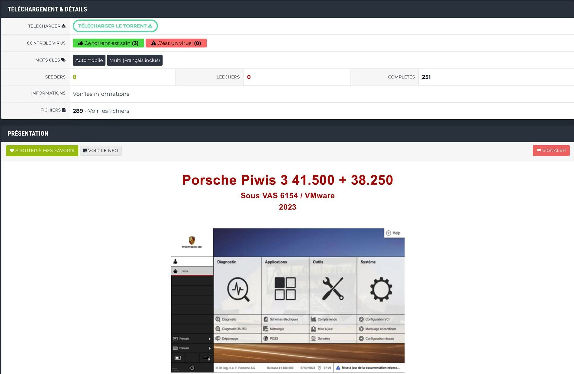

You can get a PIWIS III for free on a French torrent site (community approved). You just need to have access to a W10 laptop, a VM (virtual machine) software and NEVER EVER connect your laptop running your VM to the internet.
