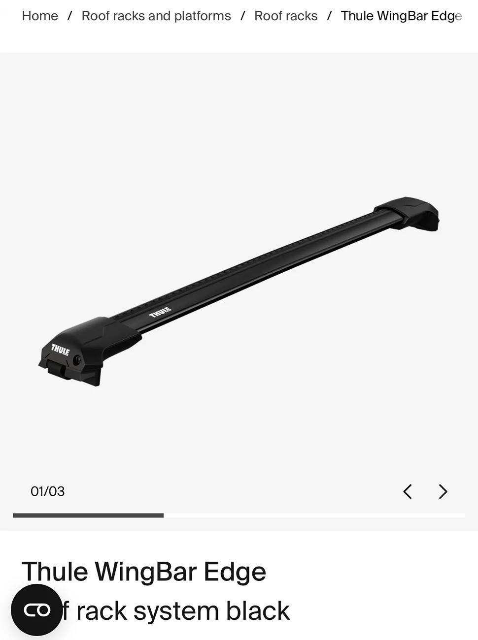

I’m thinking of getting a roof rack for my CT, mainly for use for skis maybe a bike so I plan on taking it on and off.
Is there any reason to go with the OEM vs the Thule black one? Does it affect range? I noticed there are screw holes in my roof bars that come with the CT what are those for?
Porsche Taycan Roof Rack For Cross Turismo IMG_5604

This has been discussed at length in earlier forum threads. The OEM bars have metal-on-metal clamps that engage with the holes that you mention. Further, it's easy to put them on the wrong way around (180° rotated) and then the metal clamps, in the wrong orientation, clamp down onto the aluminum roof rails at the wrong angle and mar the surface.
The Thule bars attach differently, with a rubberized tension belt. They are slightly more aerodynamic too. I own them and am happy with them.

I use the OEM bars.
The bar sits higher than the Thule model in your image. This is likely a good thing given the cost of the glass roof.
I've had aero bars before. They look better, but you need to remove the bars to fit a t-track bolt which can be a pain at times.

I have the Thule bars and they work fine, don't see the point of spending more for the OEM. I've done a few thousand kms with the roofbox on and haven't had any issues.
