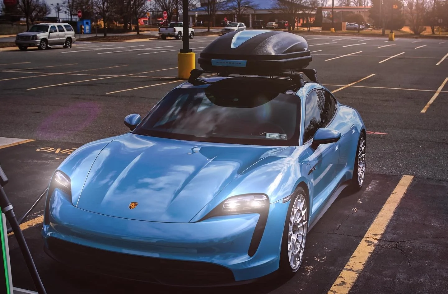

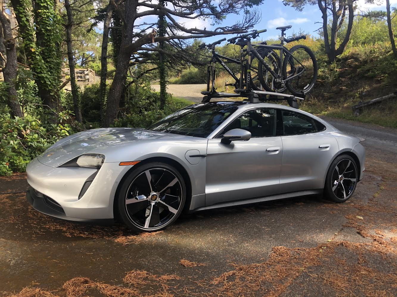

I purchased the Porsche Crossbars for my 2020 4S, as they were the only ones that fit at that time. I've used my previously owned Thule bike racks that work great. Porsche utilizes a Thule system, so the Thule components work fine with the Porsche crossbars.
crossbars.

Thule system works very well and approx 30-40% cheaper without a Porsche sticker.

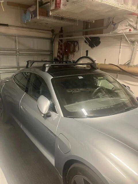

The Porsche roof racks are well made/desiged and work seamlessly.
I bought them for my 2020 4S in 2020 and use them regularly for a variety of things

Porsche Taycan Roof Rack for sedan? roof rack
2020 4S with Porsche Roof Rack

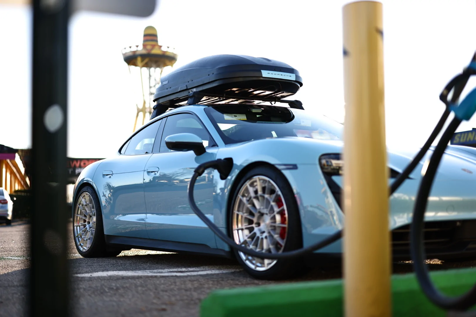

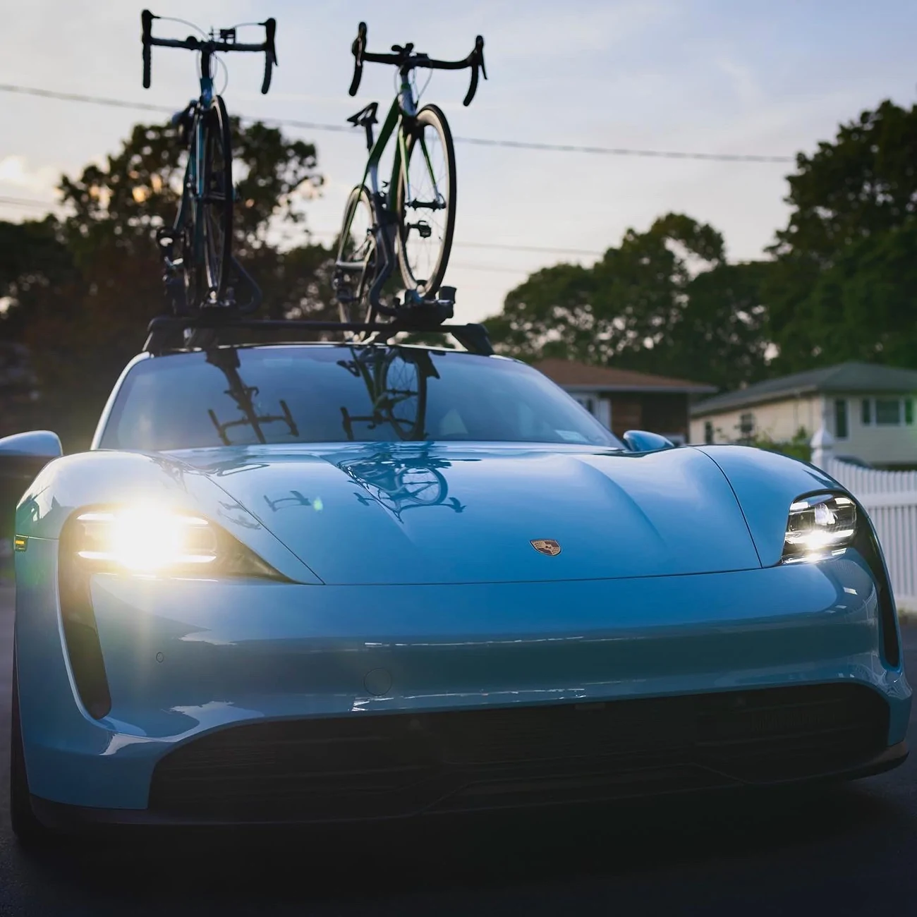

crossbars.
i learned the t-bolts for the rail sometimes vary in size depending on how old the Thule accessory is. Just FYI, this would mean t-bolts may be too large for the rail, or slightly too small and therefore creaks/rattles when there's stress on the unit.
that said, I do the same thing. I modified and shaved my T-bolts from my prior BMW accessory down to size for one bike rack and I am also using a Thule system from 10 years ago for a different bike rack. Still not 100% perfect for me, but good enough until I installed the rear mount on my wagon.
