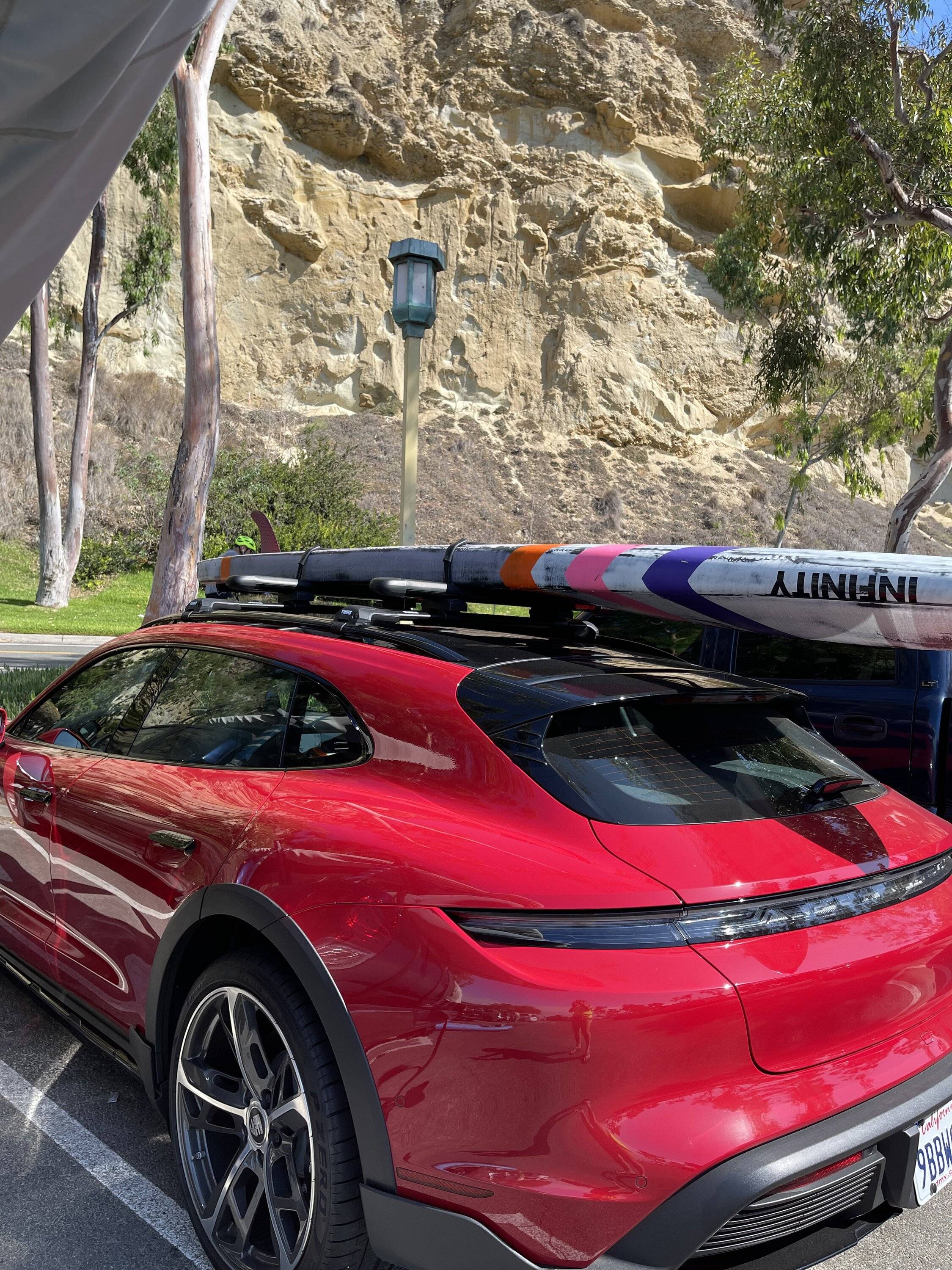

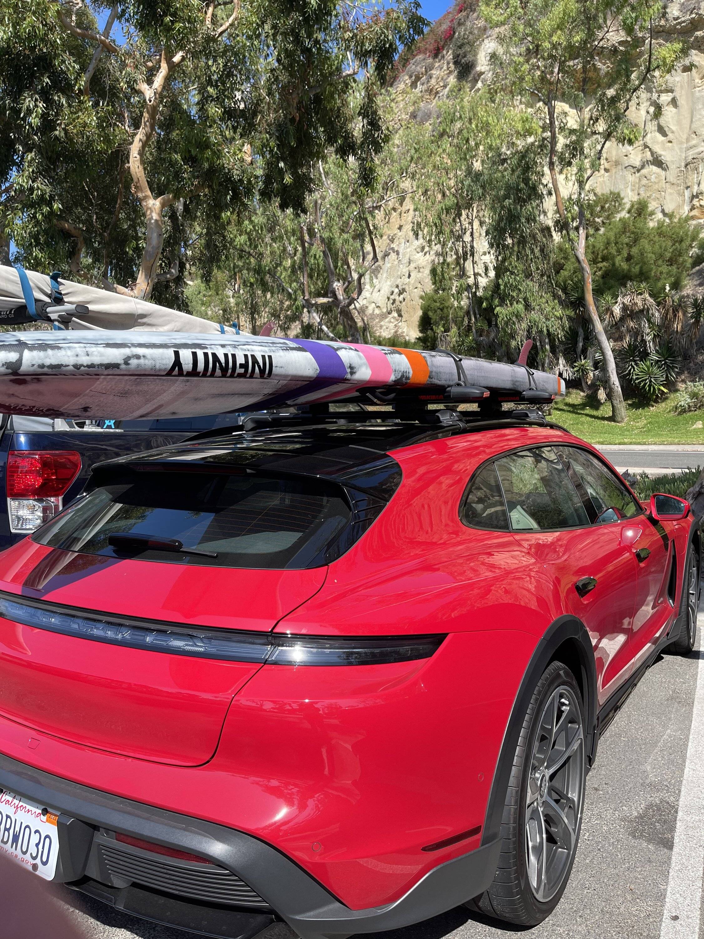

I waited almost 4 months to get a Porsche roof rack for my Taycan CT. I finally gave up after they announced a 3rd delivery delay and spoke to a local rack place about getting the Thule equivalent. They got me fitted right away, I LOVE it!
Porsche Taycan Taycan roof rack and accessories A4727FCD-326B-4207-98D6-5423F2A61FFF
Porsche Taycan Taycan roof rack and accessories 0923A915-538D-4A5F-81C8-4189D14DF154

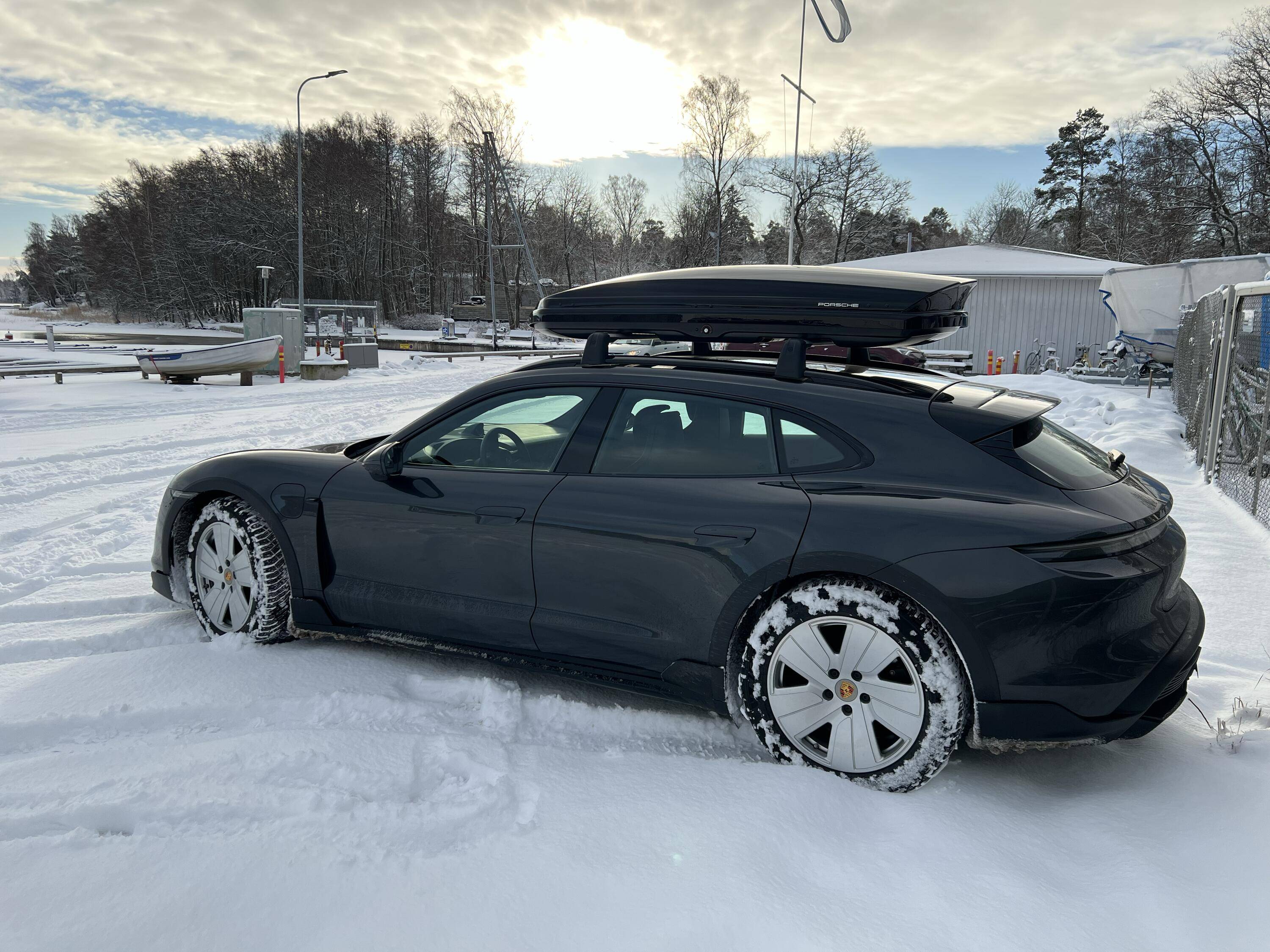

My winter setup with Taycan roof rack and Porsche 320 liter roof box
Porsche Taycan Taycan roof rack and accessories tempImageJUE0u

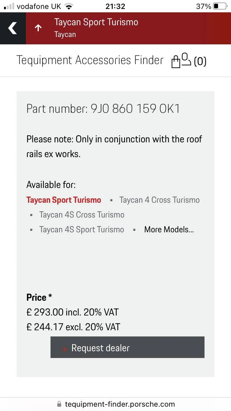

My new Taycan CT has arrived and I specced it with no roof rails and I am wondering if the rail-less bars from Porsche Tequipment will work on the wagon? My car does have a pan roof so it looks like it may be available.
Thanks in advance,
Porsche Taycan Taycan roof rack and accessories D183F079-17D8-4B3F-BABC-07EB71F80621

Hello all,
Thanks in advance,

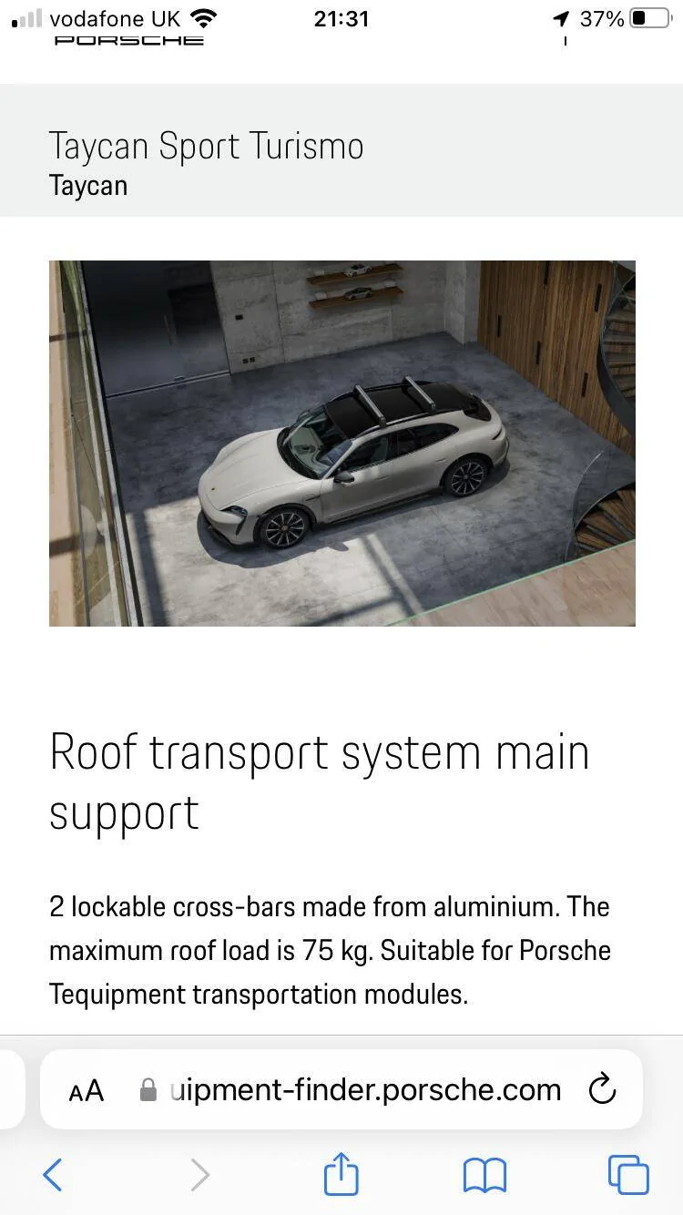

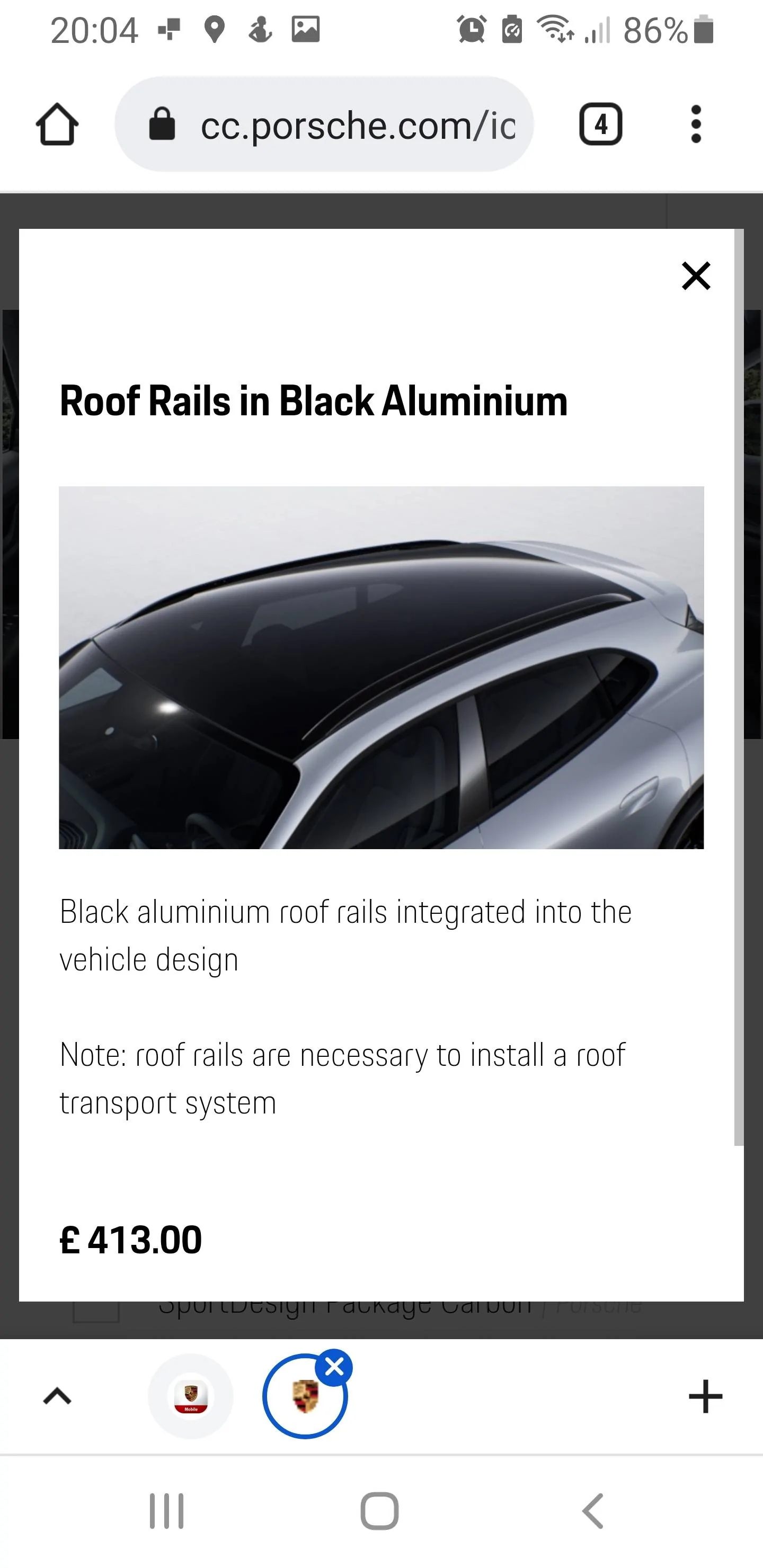

Not sure that it will unfortunately.
You need the rails which I think can only be factory fitted
Porsche Taycan Taycan roof rack and accessories Screenshot_20230313-200438_Chrom

Do you have two flaps each side at the edge of the roof? If so you should find fittings underneath and may be able to use the saloon bars.
If not, you are looking at suction pads.
J
You only get the 4 flaps with the glass roof on a saloon/sedan.
NO flaps with glass roof on ST or CT.
You definitely need the rails to fit bars.
Porsche Taycan Taycan roof rack and accessories 5B2D1969-5362-4A23-AA46-5DFD84DB44AE
