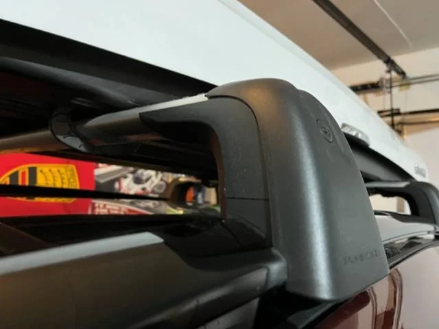

The useable length of the bars of the OEM system are 85cm (front) and 75cm (rear), respectively. The top of the bar is a bit longer, but the tower extends underneath the bar quite a bit - I’d say a good 5-8cm on each side (see photo).
Having said that, I’d think 3 road bikes would fit - 2 fork-mounted at the front, and the middle one towards the rear. (My bike’s handlebar is 40cm wide.)
3 mountain bikes - no chance, especially if they’re on the burlier side, you’d probably exceed the 75lb load rating (and the roof bars seem to be on the soft side, +glass roof).
Have a look through past threads here - the CT has the built-in channels for mounting a rear platform-type carrier. Porsche sells one for a few grand, and @basiclywilly has a great design for much less (and I think he’s taking orders for another run now).

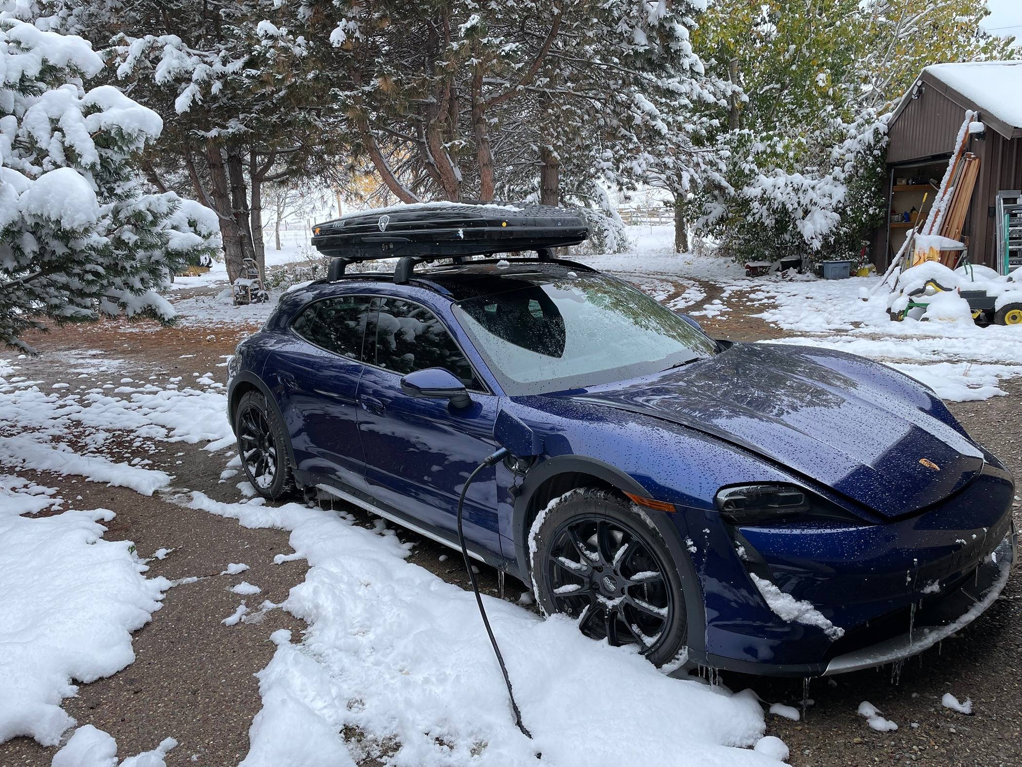

I did get the Porsche rails and 520L box over a year ago, but never took it out until today. I have a standard journey of about 160 miles reasonably flat. A week ago about the same time of day. I got 355Wh/mi and today with roof box I got 420Wh/mi so an 18% hit on range. Speed was fairly uniform 78mph on each trip. I have toned it down for science. :cool:
Anyone ele have efficiency data with a box?
