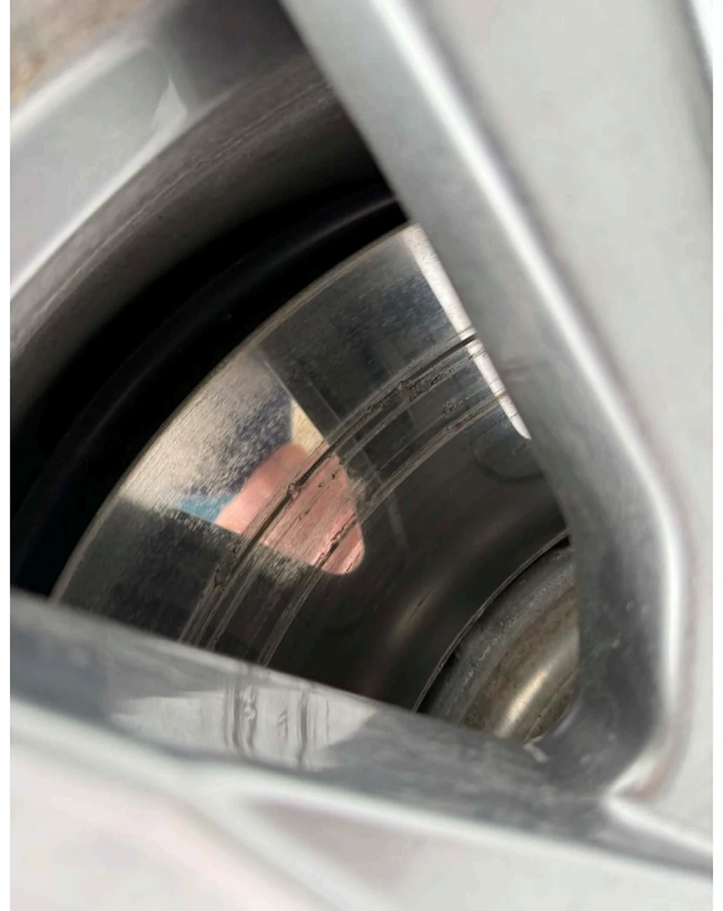

I ran my finger nail across the surface and it does appear to be some sort of deposit.
The Tungsten Carbide coating should resist lots of materials with the exception of diamonds or similarly very hard minerals. I can't imagine that salt or road grit would damage the coating.
Porsche Taycan Rust on wheel hub normal? Screenshot_20260102-083932
Any rock or stone debris that gets caught between pad and rotor will damage the coating like your rotor clearly shows.
Your pads are damaged too btw.
Is that the front rotor?
In my country that car wouldn't pass any APK (annual safety inspection).

Front and rear drivers side show marks.
