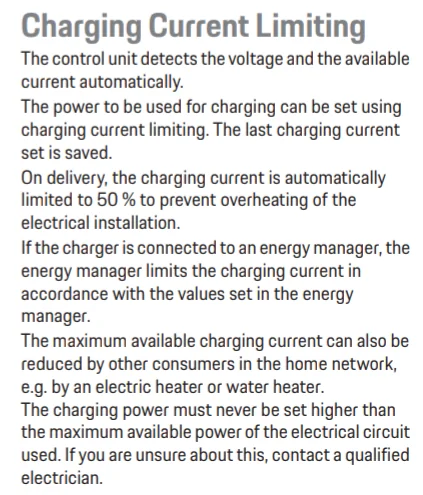

Page 13 speaks of setting the current limit but in such vague terms I cannot add much detail. I assume it will be obvious in the menus. Screenshot attached.
Yes, I do have the manual but consider this forum more easily accessible and getting explanations in more detail by people such as yourself which I find very informative and personal coming from people much smarter than me, rather than reading pages in a manual. This all began with reading in the manual the 1st day about using the “14-50” plug. - which it did NOT come with. Then came here for answers.
Thanks again!
