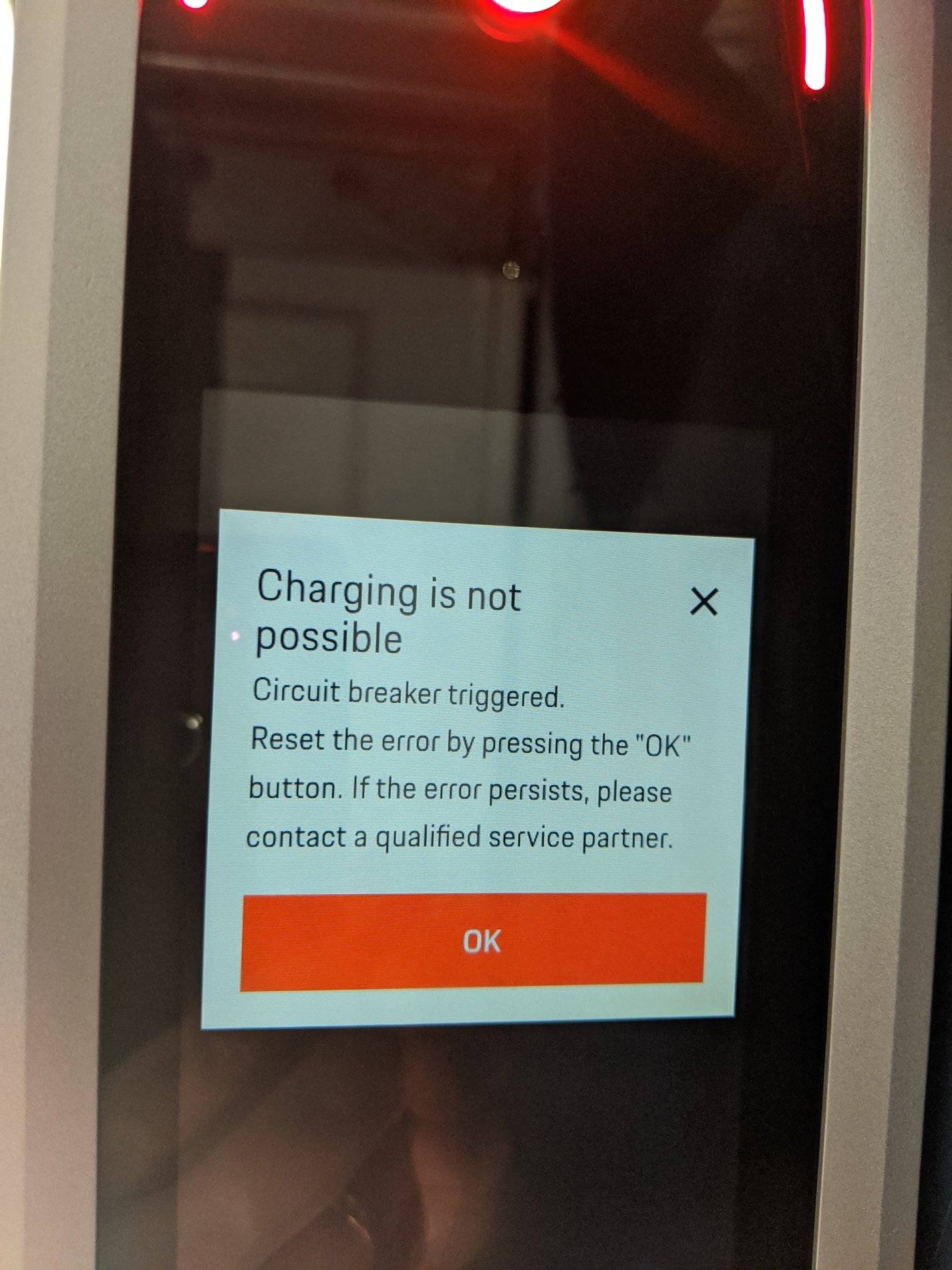

What flaws did you see?
The process was just odd with a QR code and everything. It's a one time thing, and I'm blowing it out of proportion. I was also frustrated with how poorly the phone app is working, thus I'm skeptical about the charger right now, too.
The second day I ran into this message. Powering off/on the charger didn't help. To resolve I ended up removing the charger from the car and plugging it back in.
Porsche Taycan Setting up for charging in garage IMG_20200531_222637
Did you try your Tesla charger with the Taycan? The M3 has the same connector, right?
Nope, they are different connectors.
