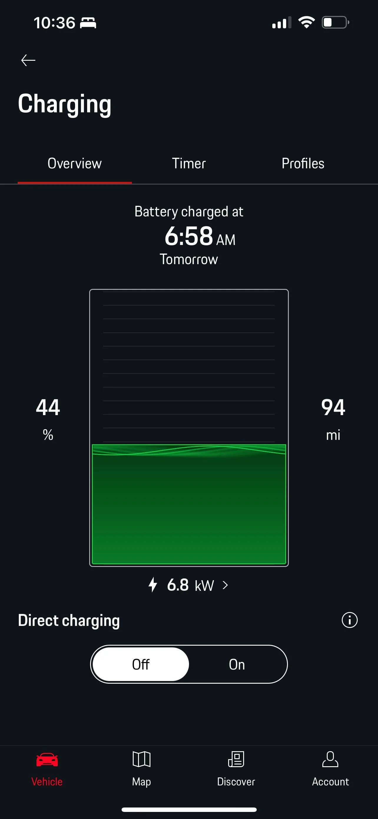

I have owned my Taycan for a couple of months now and sense the charging is very slow at home vs the previous Tesla cars I owned. See below and maybe you can help me understand. I have profile 85% selected which equates to around 185 miles. I am charging from 44%/94 miles using 6.8 kw.
185-95=91 miles to get to 85%. That should take about 4.5 hours at 20 miles per hour (usually quoted charge rate for 7kw). Photo taken at 10:36 and charged predicted to finish at 6:58, about 9.5 hours later rather than 4.5 hours I expect. Any thoughts on why. I am using a Tesla wall charger and car is displaying 6.8kw which I would expect. Frustration is that it spills onto high cost tariffs than night rates between 12 and 4:30am

Thank you but the car is set to the correct timers (between 12 and 6am) and the profile is between 20 and 85%. It is charging at 10:36pm because it believes it needs until 6:58am to get to 85%. That is what makes no sense.

Do you have any timers with cabin pre-conditioning enabled? Car may be trying to optimize both timing and energy usage for that.

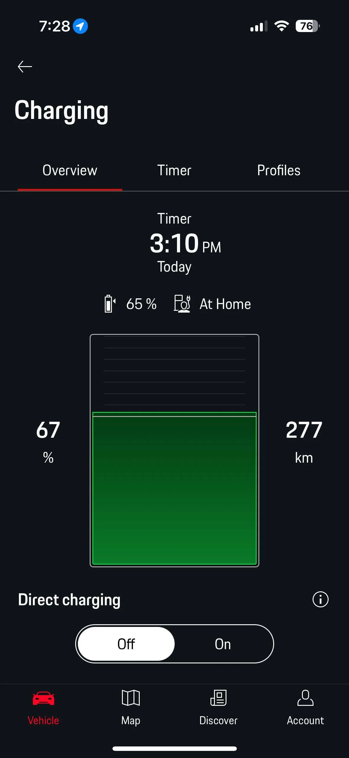

It doesn’t look like you have the timer or profile properly configured/set. If it is charging based on them, should see them show up on the screen
Thanks - I will try to reproduce your screen. Was the timer setup in app or in car?
