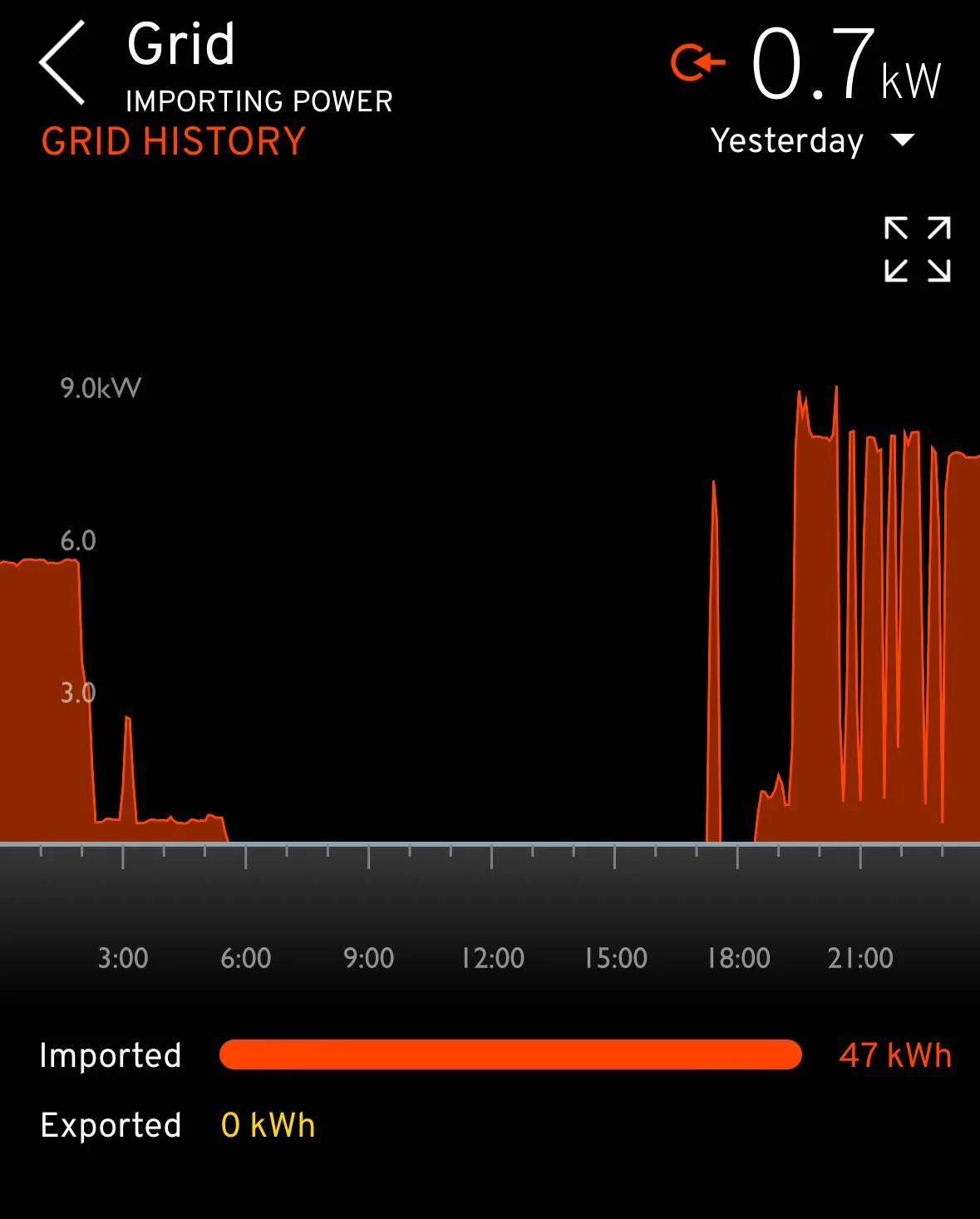

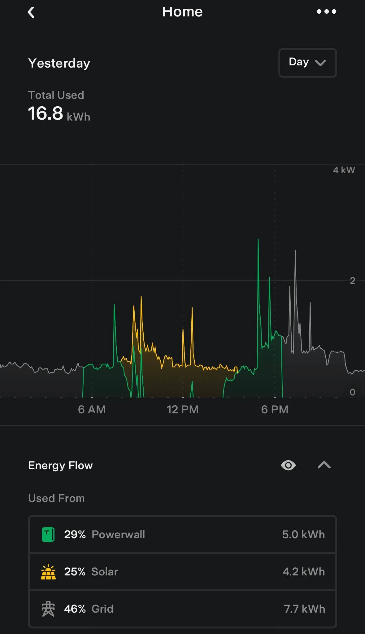

Yep, and Zappi is very very good at that. However, Octopus Intelligent tariff gives you 6 hours of 7.5p/Kwh overnight plus 15p/Kwh for export. So it’s better to export your solar and charge overnight currently. Plus, it can give you extra hours at the low rate to charge. Yesterday I got the 7.5p rate between 18:30 and 08:00.
I have a Tesla Powerwall too, so 99% of my use can be on the low rate :)
I’ve wired my Zappi to be ‘grid side’ of the Powerwall - so the battery will never be used to charge the car.
use yesterday according to Powerwall:
Grid use according to Zappi:
Your graphs look similar to mine although my batteries are DC side. I got my bill yesterday… 10kWh daytime usage for the month and 788kWh for the night time. Great tariff!
