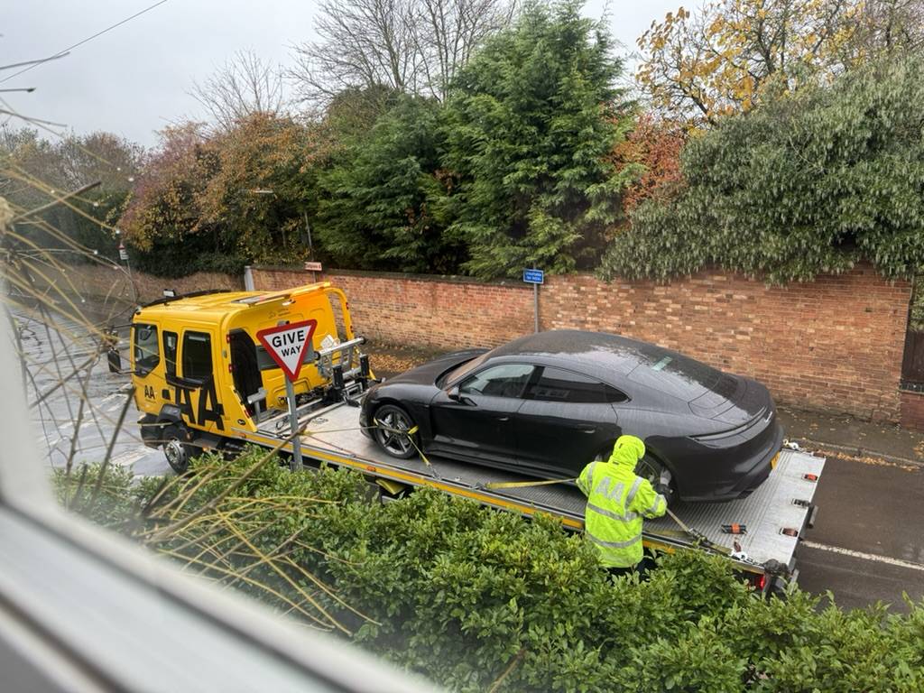

Car has gone in now negotiating temp car with car hire firm. Offering A class. How do I negotiate for a proper premium car?

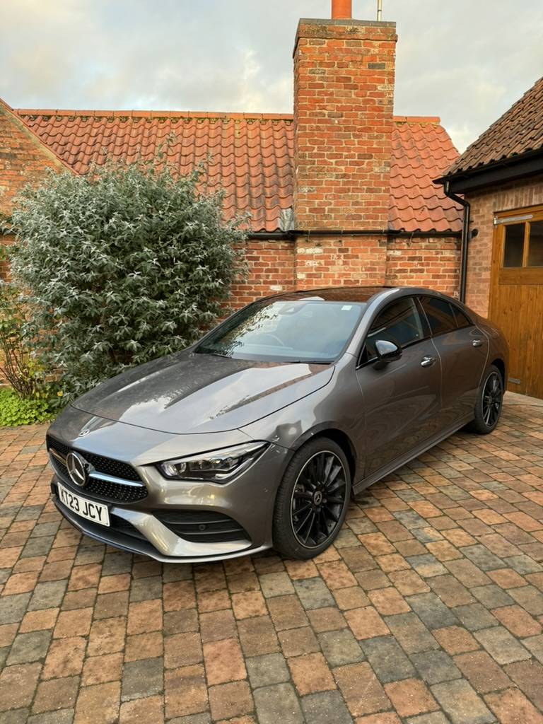

I've been in a Merc CLA for the past 2 weeks (and counting) for the same reason. Hoping to have my Taycan back by the end of this week. Biggest first-world problem is missing my heated steering wheel and the ability to pre-heat the cabin in a morning!

Mercs of old were a premium car - Mercs of today (especially those accident damaged by a previous hirer) are certainly not!
