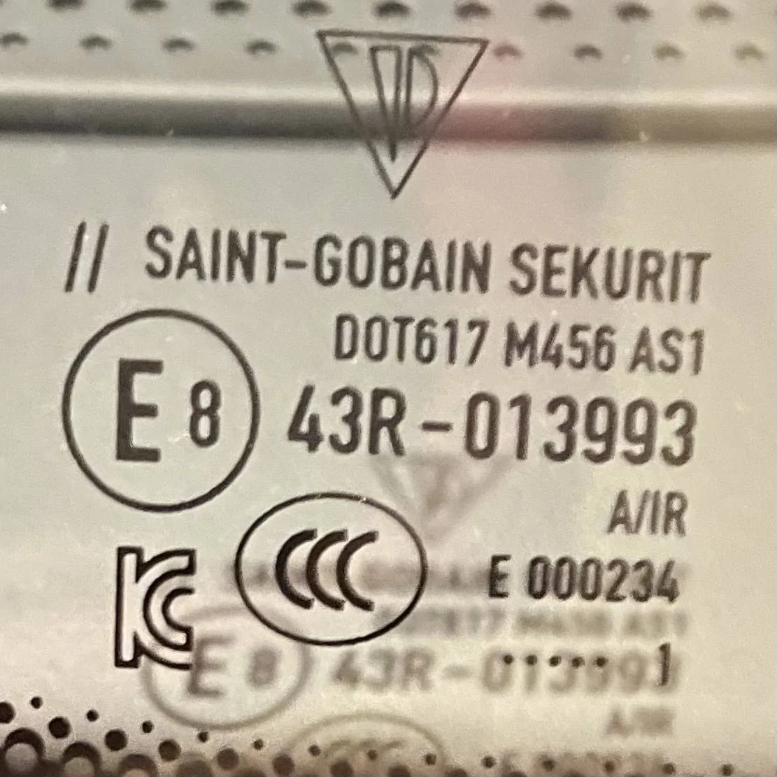

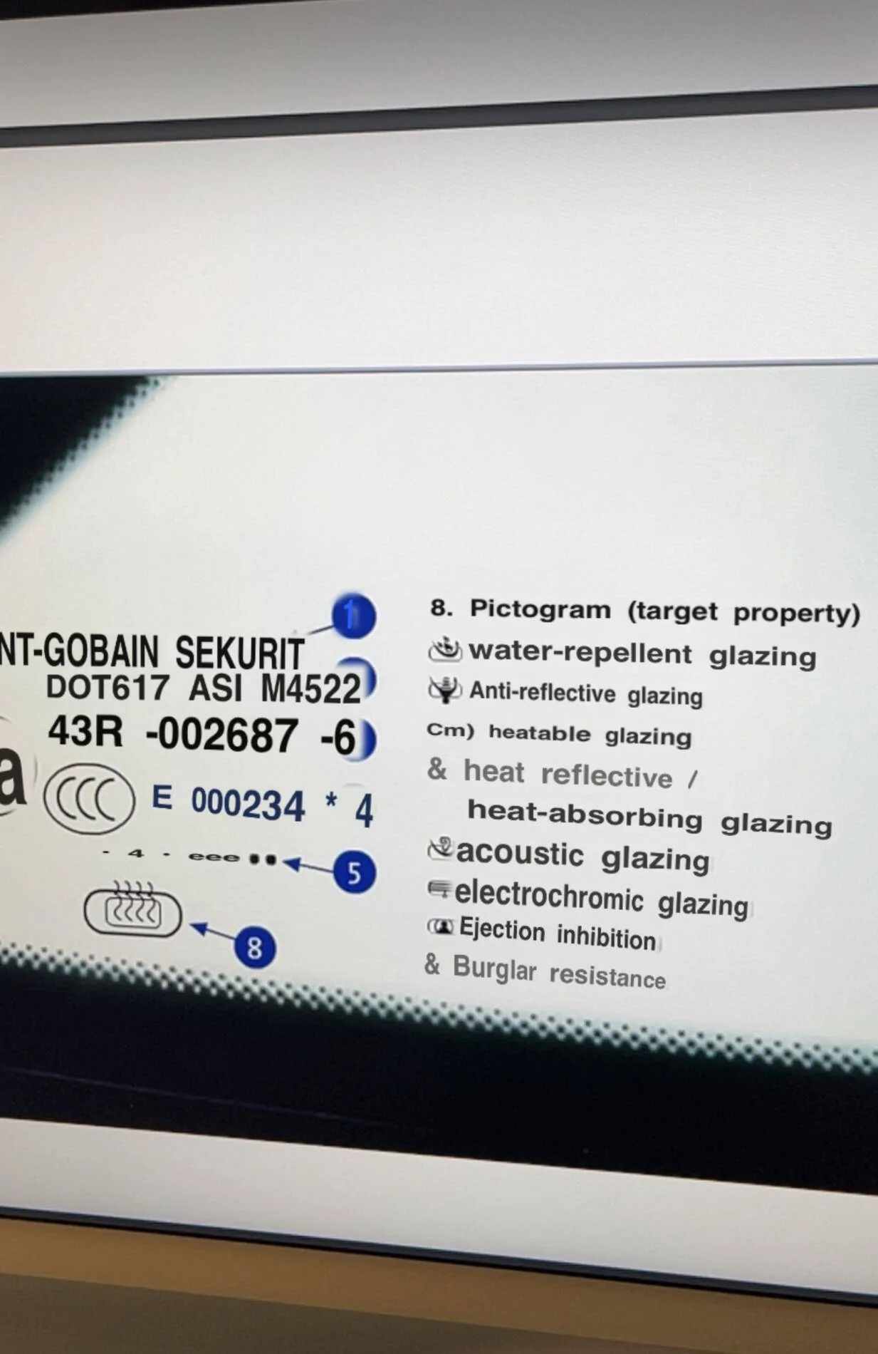

That's interesting. I didn't post an authority for the side windows only statement because I - like @ct-andy - was told this by my Porsche dealer. It is certainly possible, as there are many vendors who sell acoustic windshields to manufacturers (such as AGC). There is a way, supposedly, that we can tell (e.g., here).
We have a unique advantage, however, as we can compare cars (hopefully). My car DOES have the thermal and sound insulation option. In the lower left (passsenger) corner of the front windshield, there is a parts code. If someone (in the US) who does NOT have the thermal and sound insulation option can do the same, then perhaps we can settle this for certain. I will say that the A/IR code that I have circled in red suggests the possibility that, contrary to what some of us have been told, the windshield in the thermal and sound insulation is different. The “A,” I believe, stands for “Acoustic” and the “IR” for infra red or thermal. Let’s see if someone can post an image to compare!

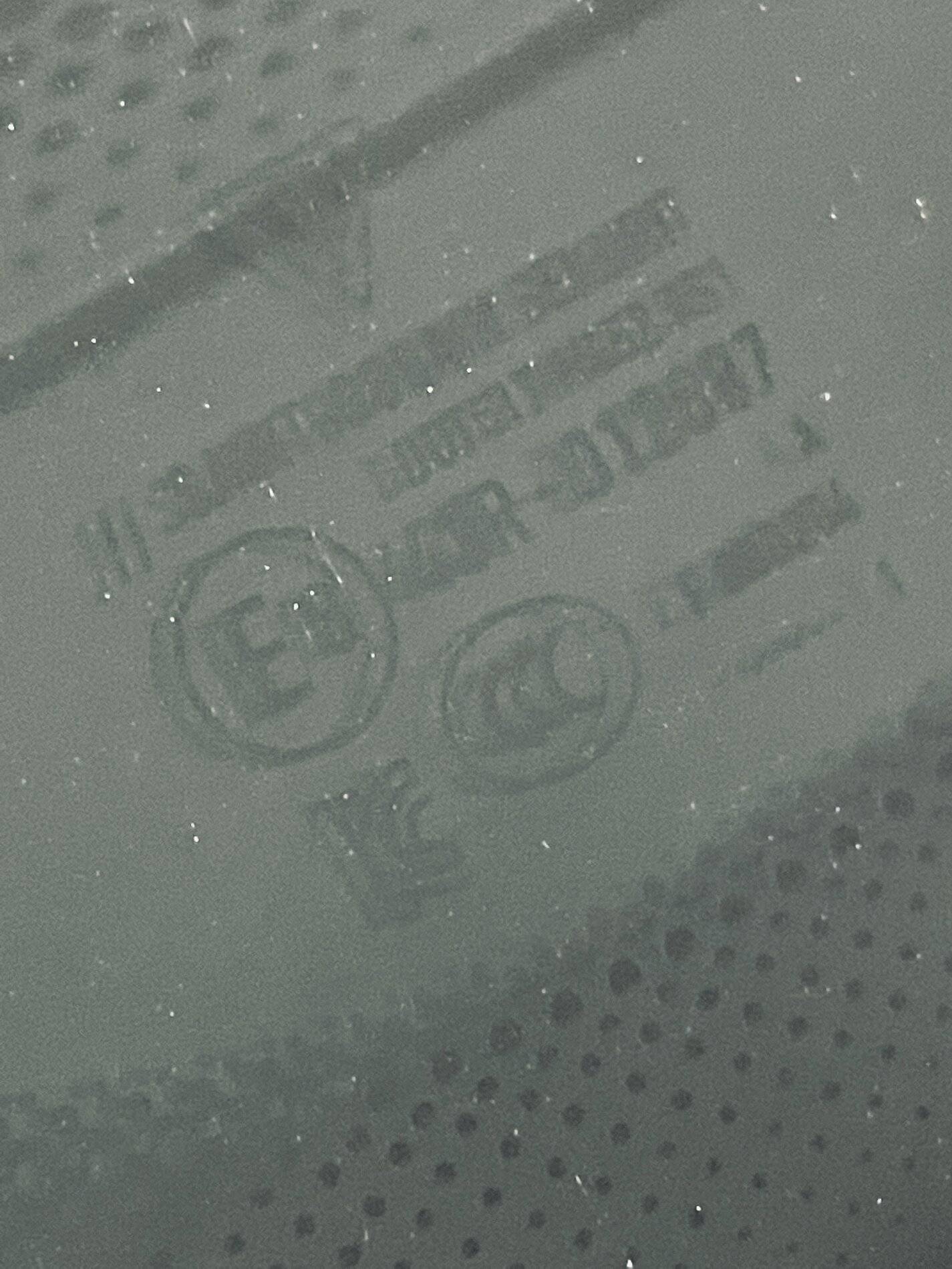

Mine is almost identical. The very bottom line is different. I’m not sure what that is. I also have the insulated glass option.

Best I can get with tinted windshield.
