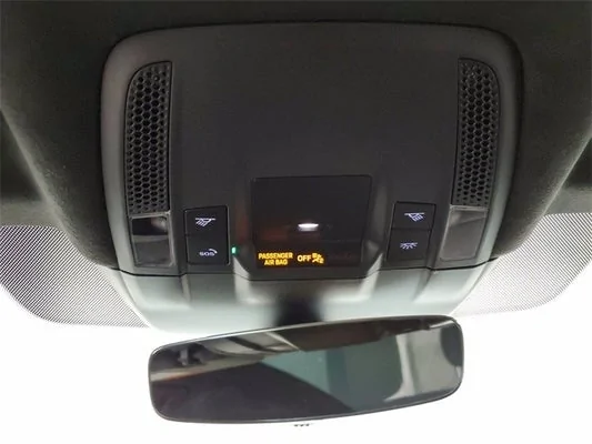

Are you sure he wasn’t the assistant to the specialist? You can easily see the difference in the front windshield. The optional windshield has a blacked out area above the rear view mirror (because that’s where the metallic cutout is). Like so:
Porsche Taycan Thermal windows 1625724472378

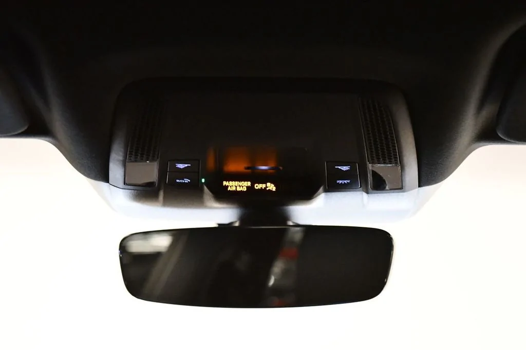

The standard windshield doesn’t:
Porsche Taycan Thermal windows 1625724328724

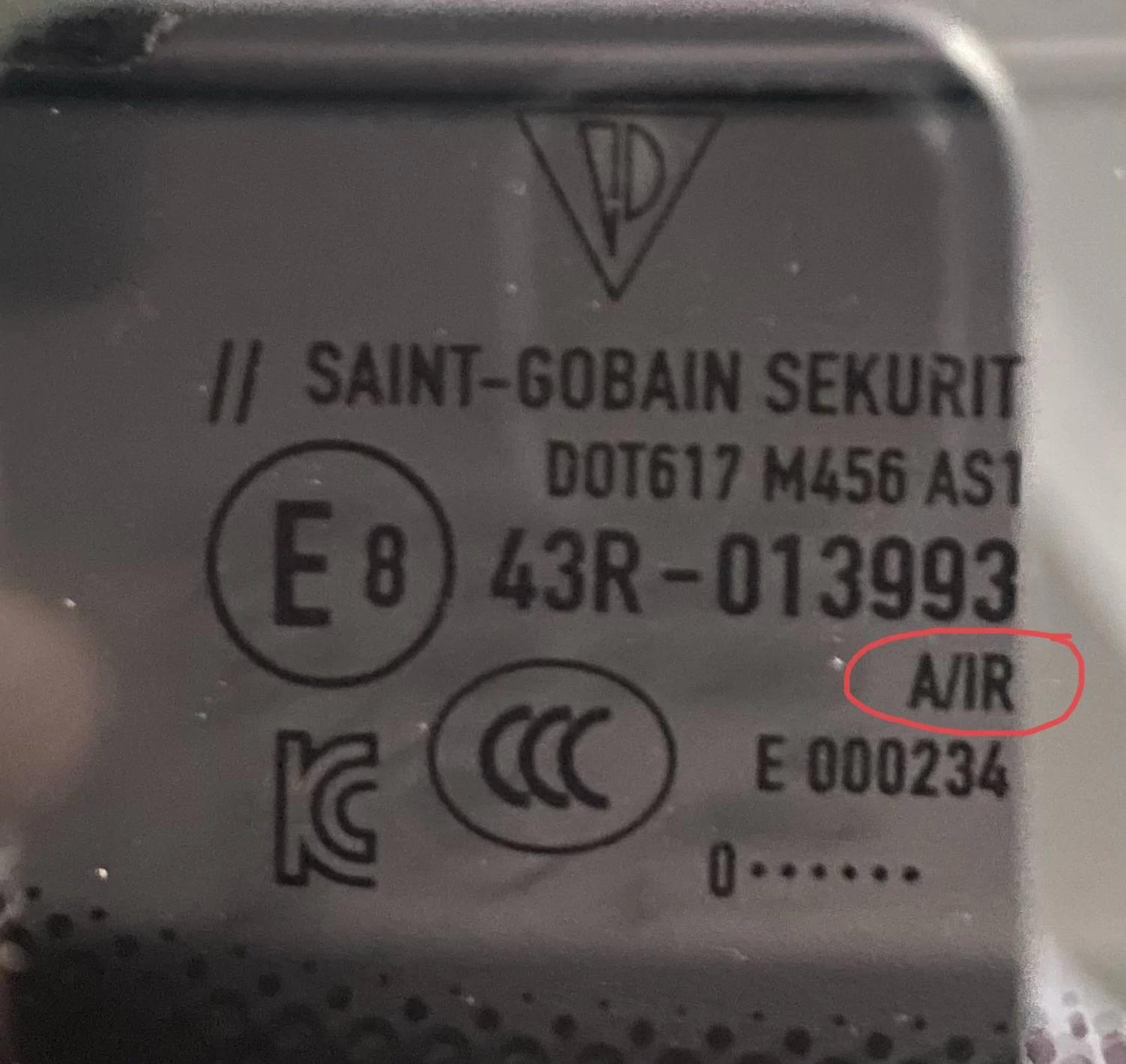

That's interesting. I didn't post an authority for the side windows only statement because I - like @ct-andy - was told this by my Porsche dealer. It is certainly possible, as there are many vendors who sell acoustic windshields to manufacturers (such as AGC). There is a way, supposedly, that we can tell (e.g., here).
We have a unique advantage, however, as we can compare cars (hopefully). My car DOES have the thermal and sound insulation option. In the lower left (passsenger) corner of the front windshield, there is a parts code. If someone (in the US) who does NOT have the thermal and sound insulation option can do the same, then perhaps we can settle this for certain. I will say that the A/IR code that I have circled in red suggests the possibility that, contrary to what some of us have been told, the windshield in the thermal and sound insulation is different. The “A,” I believe, stands for “Acoustic” and the “IR” for infra red or thermal. Let’s see if someone can post an image to compare!
Porsche Taycan Thermal windows 2622E6EB-5516-4586-9003-8ABED8F134AA

Standard glass in my RWD. My windshield has the 'A' but no 'IR'. Leads me to believe acoustic only.

Any chance you could post a pic? I’m interested in comparing other info, like the double slash in the top left of the pic @KensingtonPark posted which indicates the glass type as being Regular Multiple Layer.
IR is infrared-reflective.
