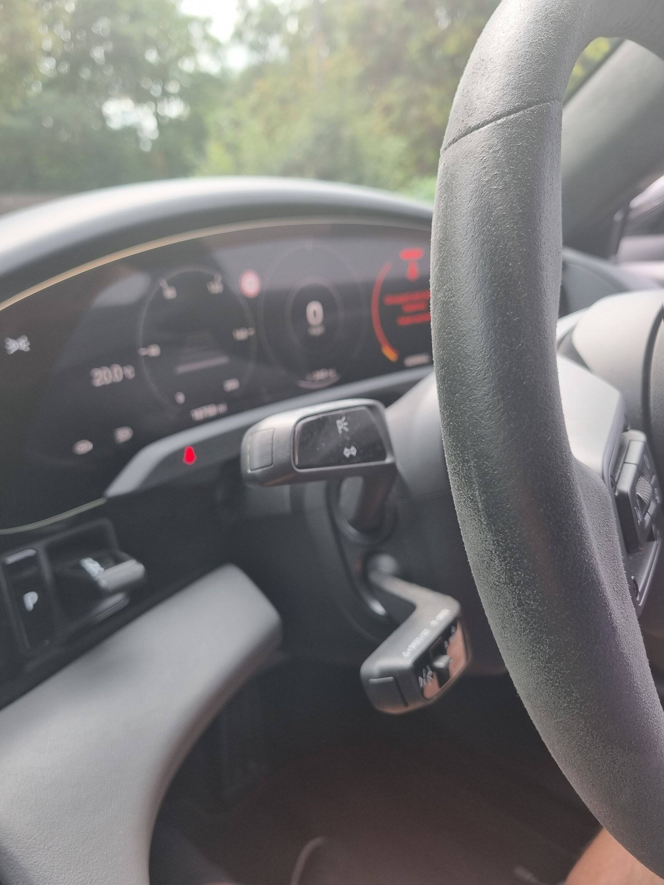

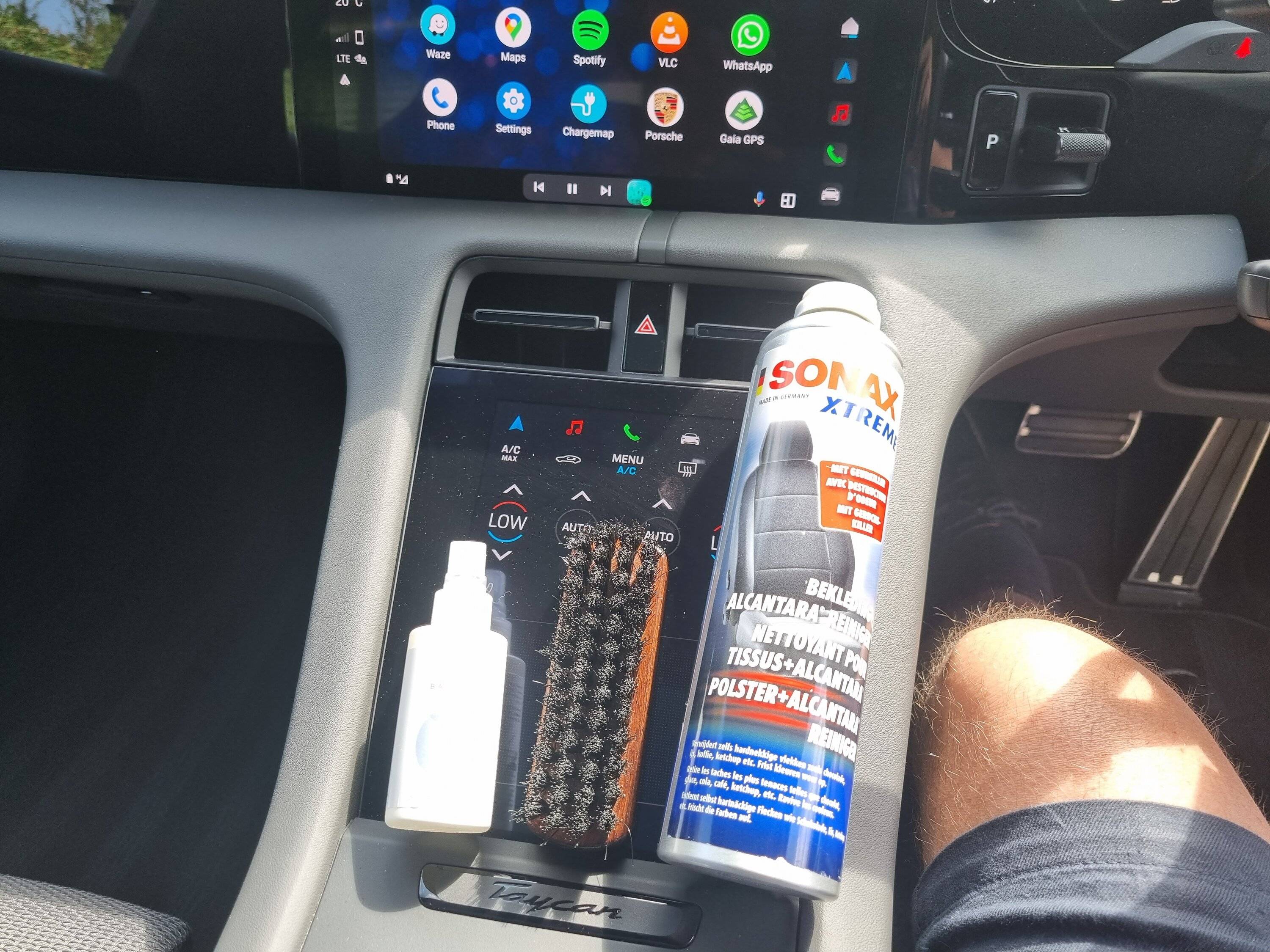

Sonax Xtreme has a faint citrus odour ( i think ) - it's bit hard to apply direct so I spraying it on a cloth.
The steps I took:-
  • spray Sonax on a cloth an apply
  • this gets through the shiny,compacted layer
  • brush in
  • apply water as a mist
  • let it soak in
  • remove dirty water with a cloth

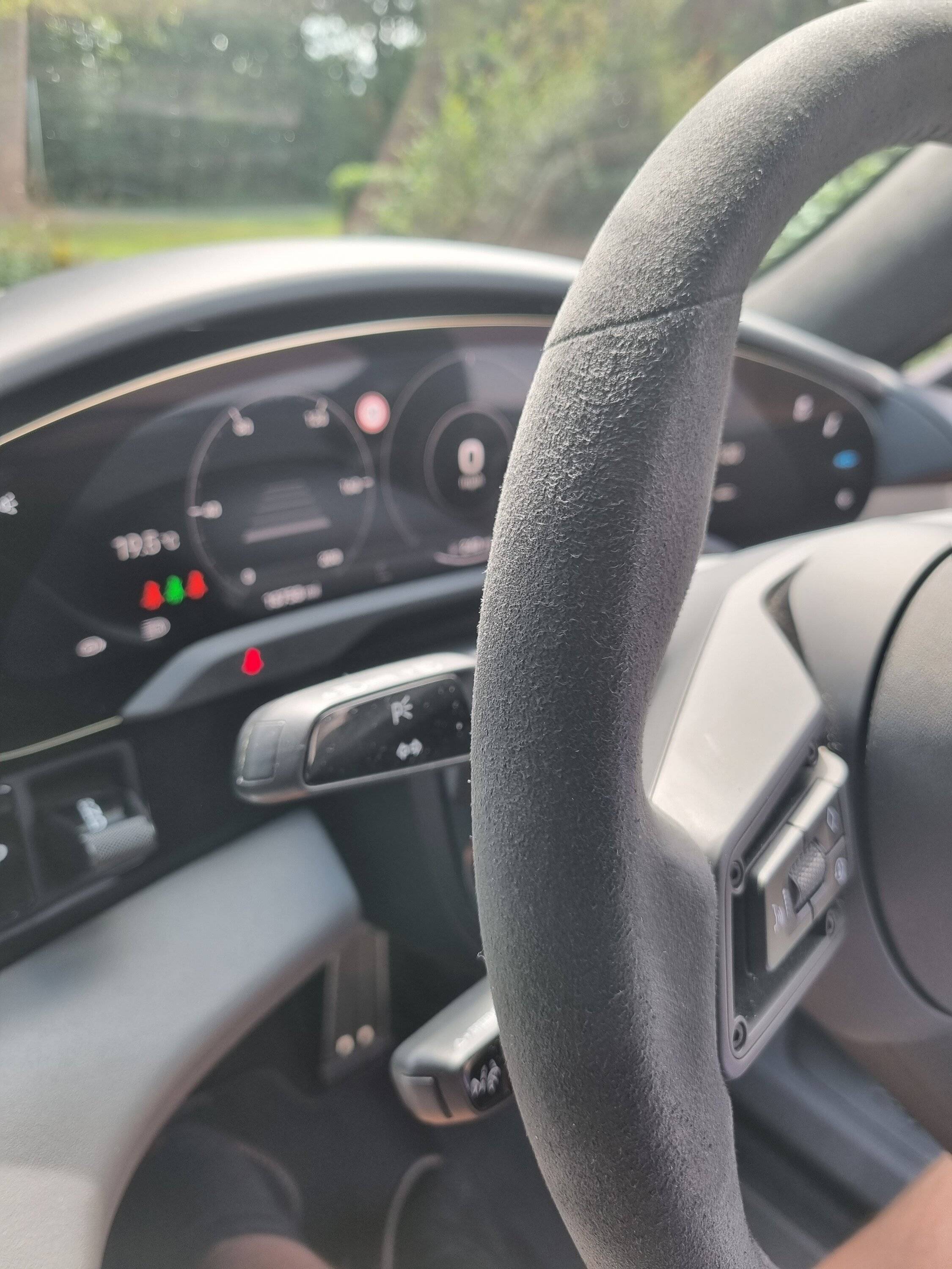

The cloth was pretty filthy at the end of this. The end result seems pretty good to me. Maybe the water isn't necessary but I figured there would be water soluble components as well as sonax soluble.
