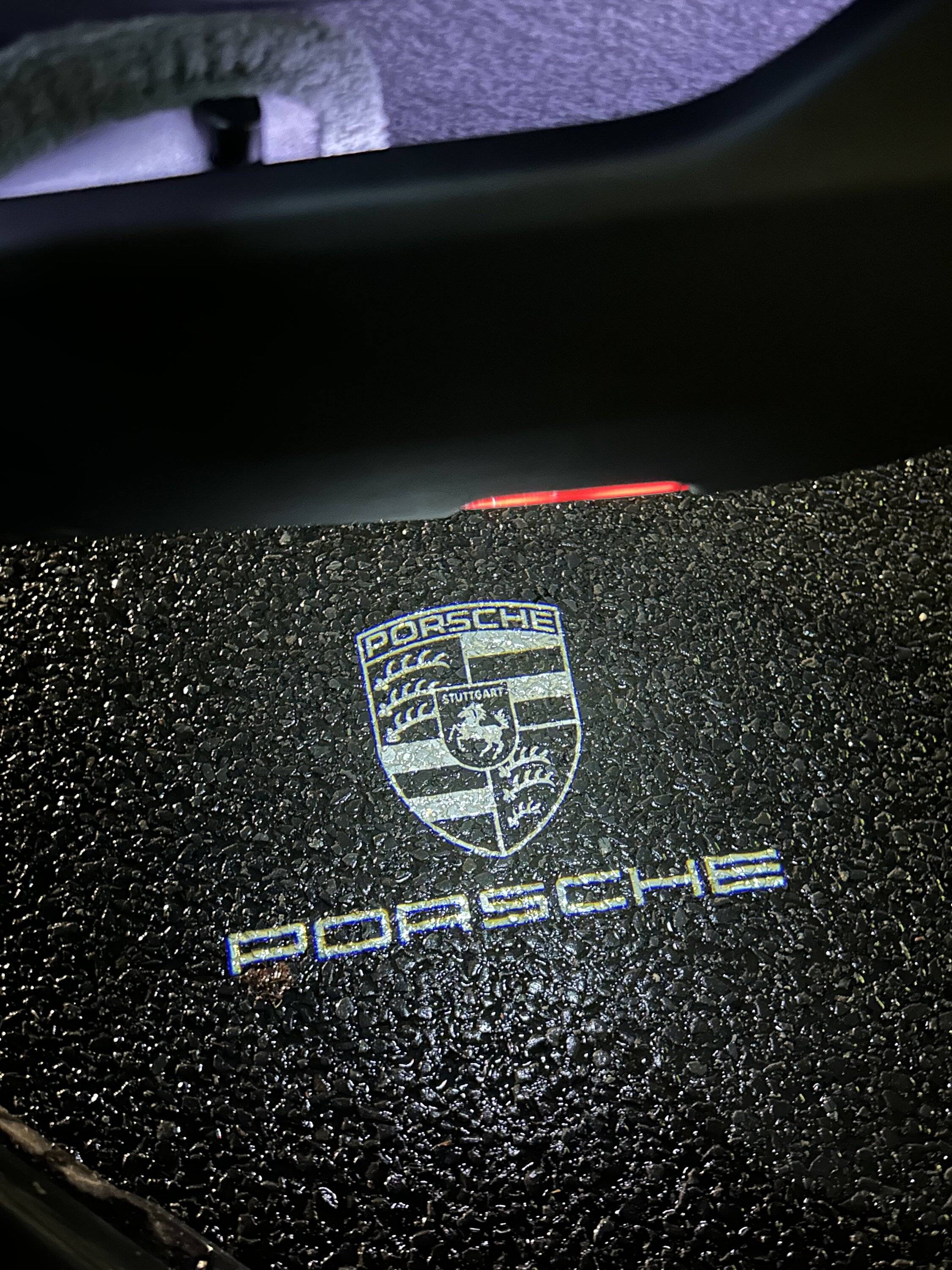

I quite fancy some of these but almost never park at night anywhere flat enough to benefit, I have a flint gravel drive :(
I'll take photos of them on a gravel drive when I get chance.
Though it's a prime opportunity to find smooth paths and show off at night :)
(I though the leather looked a bit "blackberry" under the interior light in the pic).

Looks cool. My wife's Audi has OEM projector puddle lights (came with the car) -IIRC they project "eTron". Personally I typically go for function over form, would probably look for a puddle light which lights up the ground better when the door it open.
To be fair the standard ones do a good job at that IMO...and the front ones of these do seem to clip the light a little lengthways...but I'm not standing in puddles at the extremities anyway ?
(I'm with you on function over form...mostly. It wouldn't matter how good a car was if it was absolutely fugly, I'd be unlikely to buy it).

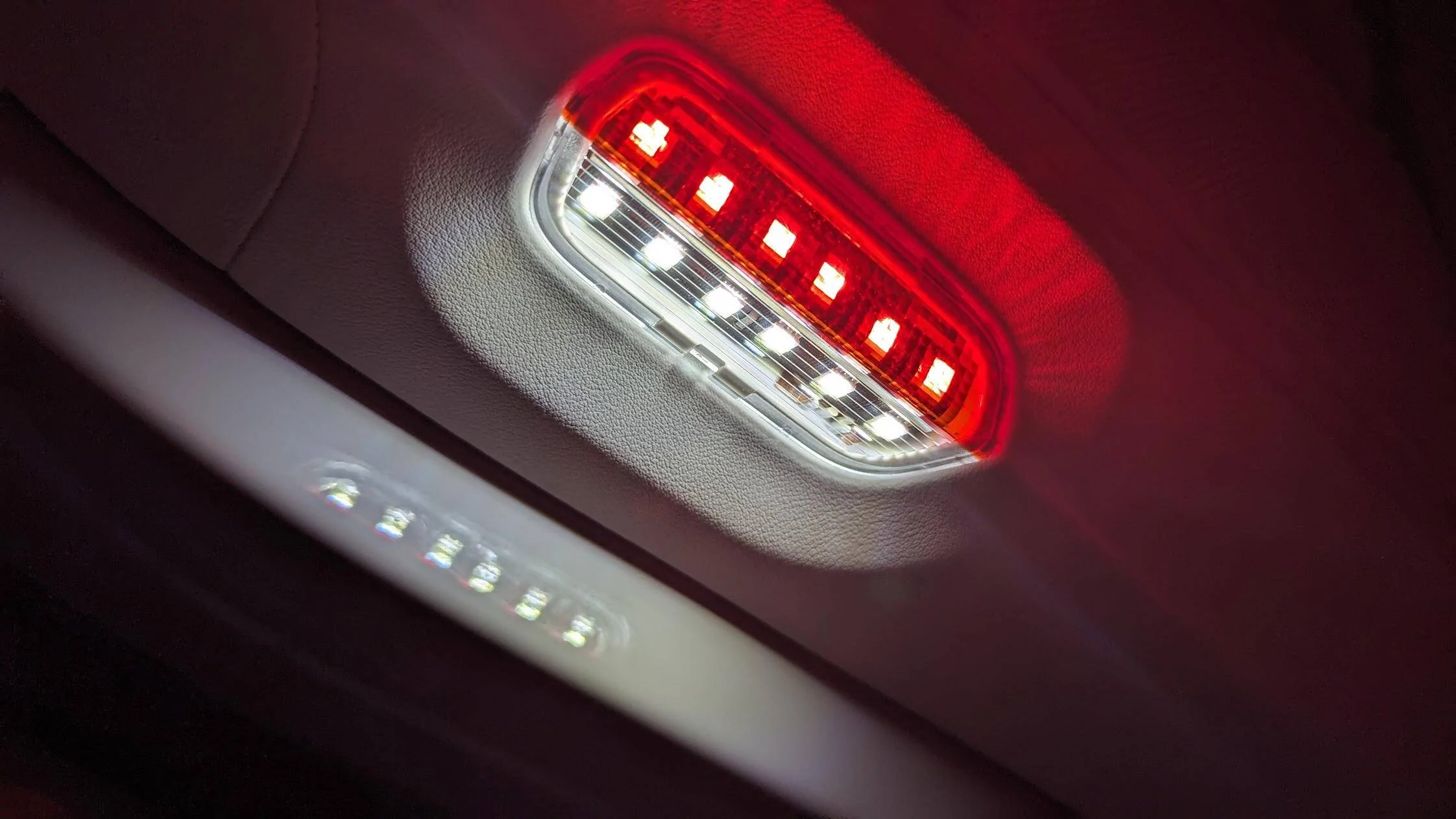

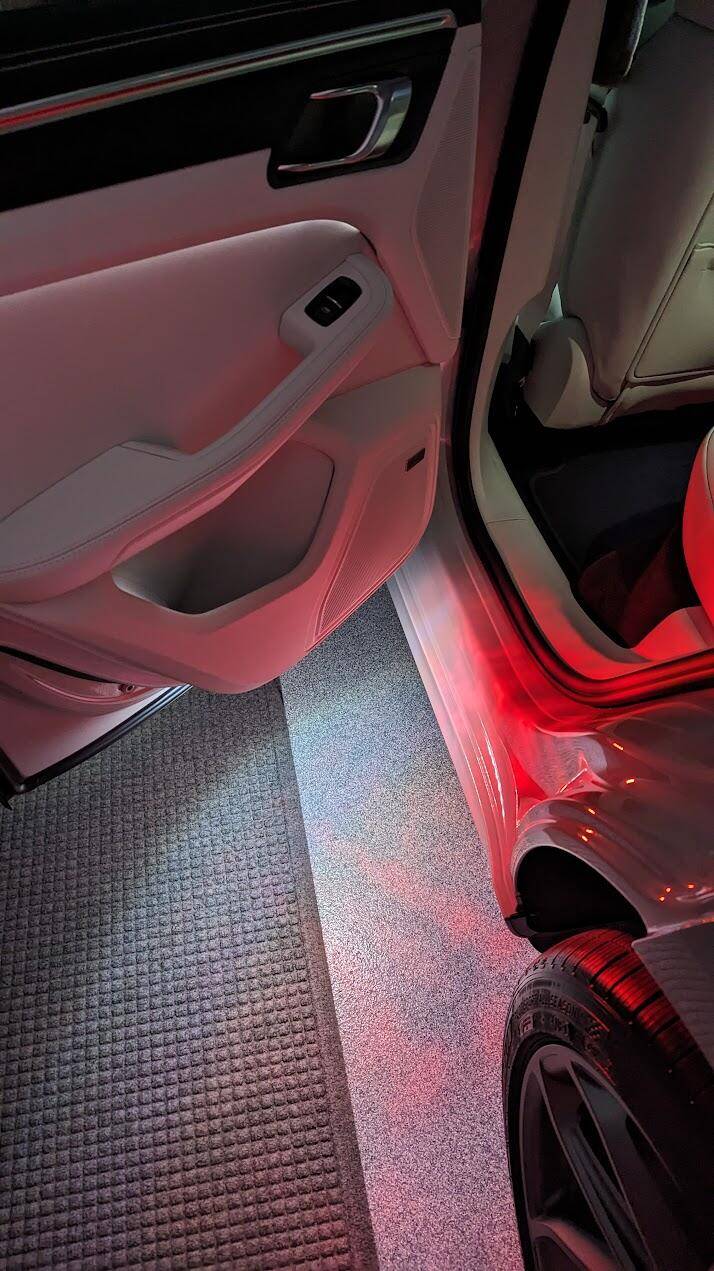

For max ground lighting I got these dual side bulbs (red/white leds) that fit into the halogen housing of the Macan. I am not sure if they would fit into the Taycan as I went for the AddCarLights for the front doors and kept original non logo lights for the rear.

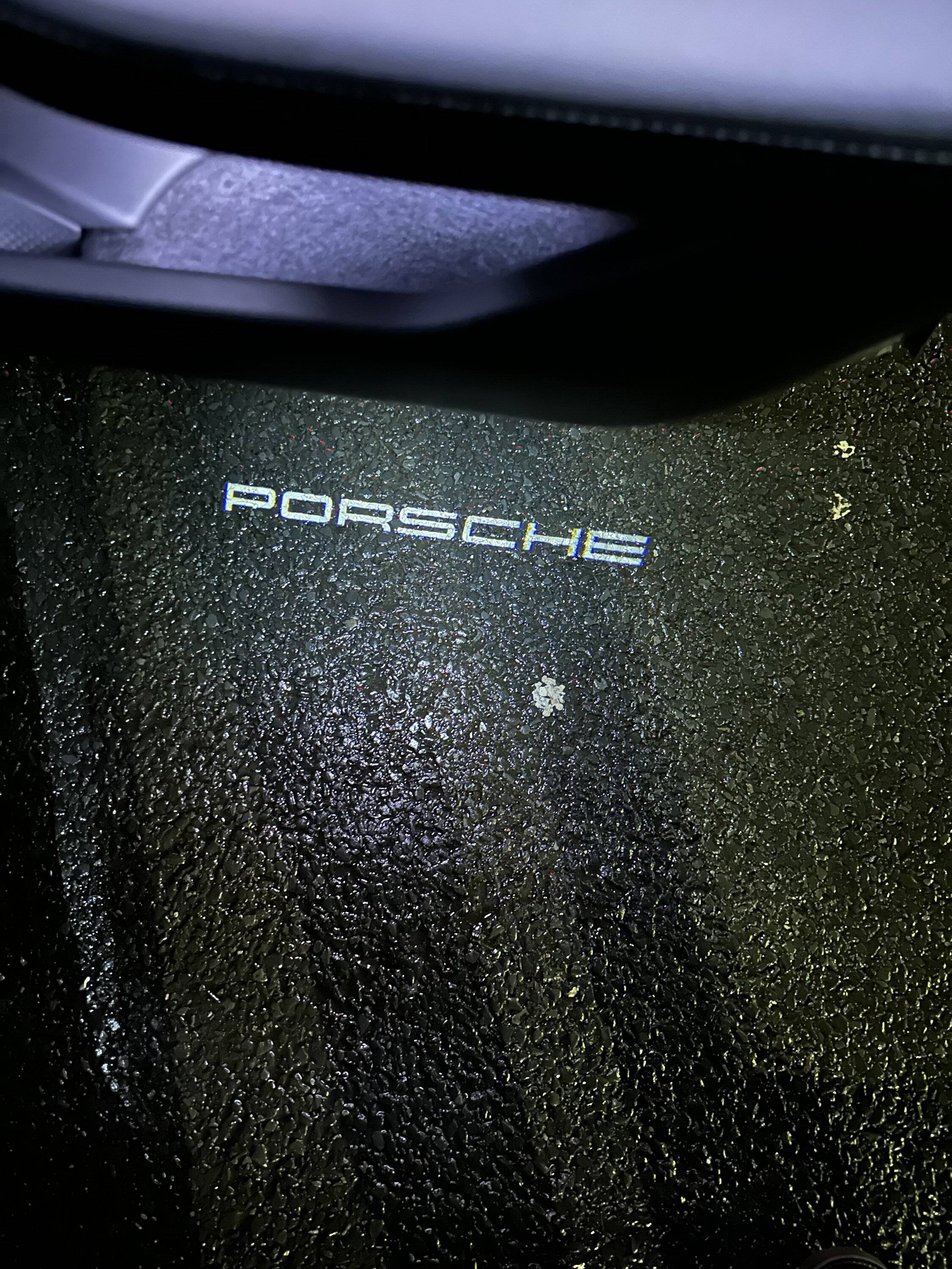

Which option did you go for? (Rear doors cut off the full emblem apparently).
senwar
Paul
Sep 10, 2023
244
167
Sheffield
MY24 ST GTS
Nice!
Same as yours - full on front, porsche on back. I like the simplicity of the wording but the logo ones did look good in your pic. I wanted these at build but couldn't justify the cost. Crazy to think how much is charged when they're literally just a small mod!
