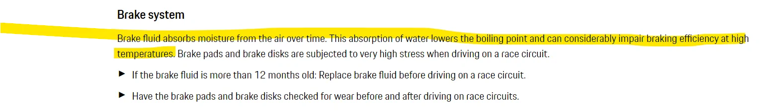

I just don’t get the change the brake fluid after 20K??
Don’t bash me but I have owned cars for 40 years now and never took a car in to change my brake fluid. Are they just looking for something to take our money? Seriously, change brake fluid, and pretty much visually check everything else seems to me like a money grab.
I guess I am one of the few that reads the manual. Different cars have different time periods for Brake Fluid changes. My Acura TSX was calling for 3 years, but Porsches like a Macan or Cayenne calling for 2 years, so this is consistent across all models. The reason is below (moisture buildup), but the overall statement is for checking Taycan before taking it on a race circuit and not for regular driving, since for regular driving you follow the Maintenance journal that calls for every 2 years, regardless of mileage.

Hate unnecessary spends and maintenance but my 20yr old daughter had an accident as she lost brake pressure on a big downhill. She got the Golf after her grandmother passed and I guess brake fluid changes had not been done despite the car being serviced... She was fine but shaken and needed a new wheel... I changed the fluid and its been fine since as it wasn't master cyl.
That TSB is interesting - exactly my symptoms. It is getting a software update in a week but the only user action to initiate teh learn routine could be "The routine is started if the selector lever is moved from P to D and back to P before charging, for example."

Just passed 20K after 15 months. Car has been awesome and no issues so far... I use mine as a daily driver and for some trips. In speaking to two different service advisors and doing a little research, it is recommended to do the brake flush after two years more so than the mileage. Some people have had their dealer test the fluid and then opt not to do the flush. When I took mine in at 18K for maint. my service advisor was fine waiting till the 2 yr mark.

I showed my advisor the TSB (since I have had the same brake pedal feel/travel issue) a few weeks ago and we did a brake flush. My car had about 18k miles on it and is about two years old. I'd say that the feel is more consistent now. I don't know that any software was updated.
