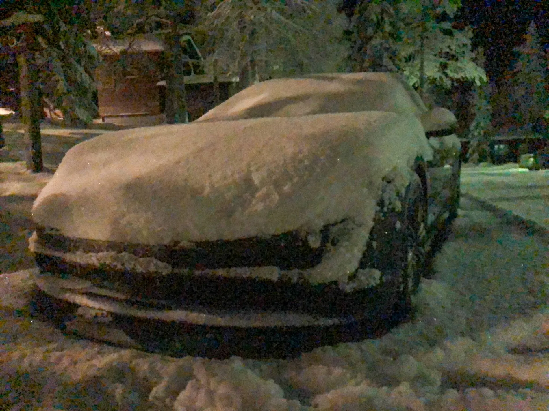

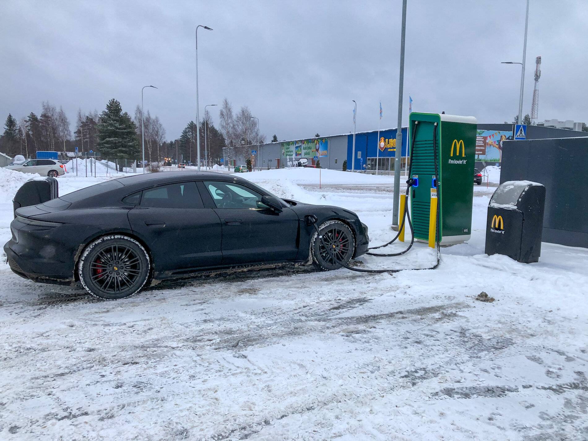

I promised to update how our road trip to Northern Finland for holidays went, so below some stats and observations:
Vehicle: Taycan 4S with Performance Battery+ (i.e. gross 93.4 kWh)
Tyres: Nokian Hakkapeliitta R3 (=no studs) 245/45R20 103R (Rear pair: XL) with 2.8 bars (40.6 psi) and wheels: Nitro Tourismo FF (20 spokes) = regular, not aero (see the attached pic).
Pax and cargo load: max 350 kg (skis went with our ICE Audi :whew:)
Driving mode(s): Continuously on Range.
Switched to Normal (=4WD and increased ground clearance because of snow) only when passing other cars - which I did quite a lot, have to admit... ?
Total trip: 871.4 kilometers (541,5 miles), charging only twice (= three legs) with average consumption of 24.8 kWh/100 km (39.9 kWh / 100 mi) and average speed of 80 km/h (49.7 mile/h).
1st leg:
288.4 km (179.7 mi), started with 96% SOC, arrived with 14%. Temperatures varied between +2 to -2 Celsius (37 to 28F). Driving conditions started with moderate to heavy rain, then turned to slush/snow and ended with dry skies and dry snow/ice on roads.
Average consumption: 25.3 kWh/100 km (40.7kWh/100 mi), average speed 87 km/h (54mi/h).
1st charging:
79,5 kWh / 1hr 6 mins, battery temperature 20C/68F when started charging.
2nd leg:
325.6 km (202.3 mi), started with 97% SOC, arrived with 9%.
Temperatures between -2 to -5 celcius (28 to 23F). Driving conditions nice dry skies and little snow on the roads.
Average consumption: 23.7 kWh/100 km (38.1 kWh/100 mi), average speed: 82 km/h (51 mi/h).
2nd charging:
76.8 kWh/ 58 mins, battery temperature 18C/64.5F when started charging.
3rd leg:
257.4 km (160 mi), started with 96% SOC, arrived with 16%. Temperatures between -2 to -10 celcius (28 to 14 F). Driving conditions sames as in the 2nd leg.
Average consumption: 25.8 kWh/100 km (41.5kWh/100 mi), average speed: 72 km/h.
Scattered obervations along the way:
- Taycan is a fantastic, steady and reliable winter car, at least in terms of driving dynamics! Even with a bed of slush it kept pushing (and pulling = 4WD :D) safely and steadily. The low center of gravity works very well.
- Remember to switch to ”Normal” when passing other cars/changing lanes, so that you have 4WD all the time (Range keeps it in front wheels and sport/sport + in rear wheels - as a default). Yes, when the car starts to be a bit out of control or when pushing the accelerator, it divides the power to all fours, but that may be too late in winterly conditions!
- Switched aircon between ECO and ECO Plus (always set to 23C/73.5F) at the beginning with 100 km intervals, but in addition to freezing my a** off with ECO Plus, it didn´t had any significant impact on the range when the battery was heated from driving (approx. between 10 to 12C/50 to 54F throughout the journey, apart from pre-heating to charge, see next). Personal note: I didn´t spend this amount of money to be freezing in my car with down jacket and beanie on at winter, hence steady 23C... :D)
- I used the Charging Planner to pre-heat the battery when approaching the charging stations so the charging could be performed faster (see above and below).
- Both chargers were 225 kW (and in conjuction with Mc Donalds´ - I´m loving it ?), but in these temperatures, the max that I got out was somewhere round 175 kW (even with warm battery).
- I don´t waste my (or your) time talking about the Charging Planner, Navigation or other similar utterly useless Porsche Software ”features” in this thread.
(You can only guess whether those chargers I wanted to use could be found in Nav or not...)
- Used Plugshare and the Finnish equivalent (latauskartta.fi) instead. Anyway, it was not that tricky as we only have a handful of quick chargers outside the metropolitan area of Southern Finland.
- Parking, rain, speed limit, ACC [EDIT: Active Lane Keeping, not ACC] and what other sensors were out of the game pretty fast when sleet started to come down from the sky. - Hint: keep de-icing spray and microfiber wipes at hand in the car. I cleared the sensors when charging the 1st time and everything worked since then (dry weather, no more rain/sleet/snow). However, this happens to pretty much every car in wet conditions turning freezing, so Taycan is no different (better) here.
- Active cruise control (distance radar) sensor is heated and it remained in operation throughout the journey despite of heavy rain/sleet/snow. This sensor was something that froze every time (even with heating) in my G31 BMW, so no complaints here!
- All in all, and in comparison to X-drive 530d BMW, in terms of driving experience so far -after this trip and pretty much in every type of weather conditions we can encounter here in Finland- Taycan is definitely a superb winter car - but not with a clear margin.
- When preparing as an EV driver should (pre-heating cabin and battery, using ECO/Range modes, leaving sufficient marging between charges, using extra strong anti-freeze windshield liquids, not accelerating like a madman, not packing granny to the ski-box, etc.) Taycan can absolutely be used as a winter car in the land of Santa Claus (and maybe even by him :D).
Happy to answer any questions.
Drive fast but safe!
-A-

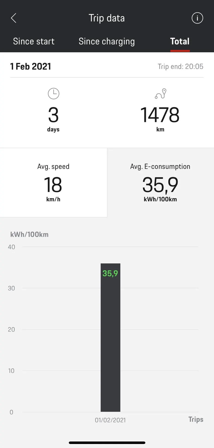

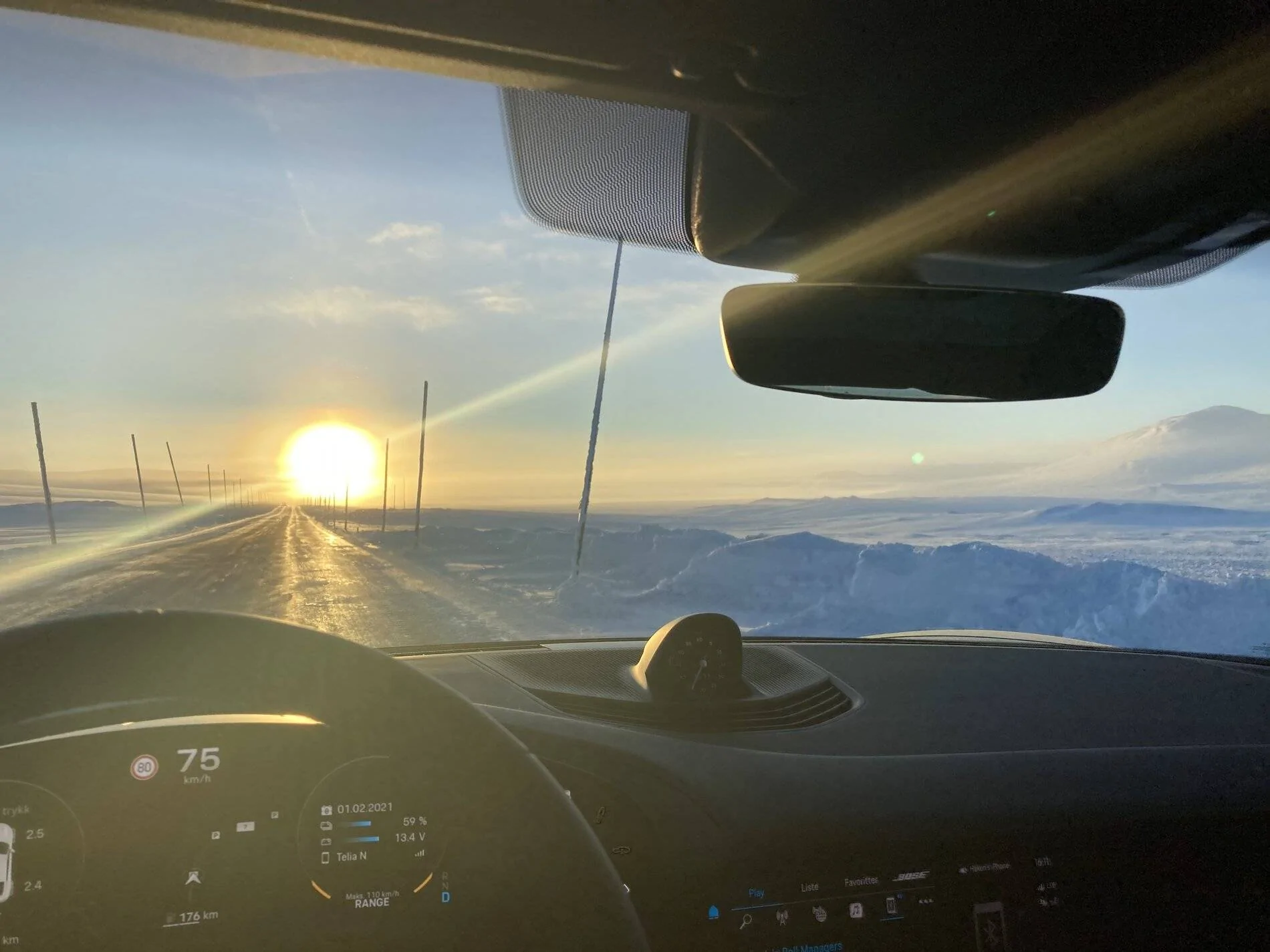

Back from another mountain trip, just thought I’d post a few snaps in case anyone contemplate visiting Norway in winter at one point in time (the virus does seem to be a stubborn one).

And for those old enough to remember; yes - this is close to where they shot parts of “The Empire Strikes Back” - also known as “Hoth” :)
Temperatures were around minus 12 to minus 22 celsius the whole trip. Charging was definitely impacted as it was very slow at the cabin with the Porsche “Emergency” Charger on 230v/6A (yeah, would be slow anyway - but _really_ slow this time), and also on the 150 kWh gas station chargers. This is most likely due to cold batteries and not being able to preheat them properly. The car doesn’t know about the charger, so I can’t find any easy way to program a preheat - and can’t be bothered with fiddling around with it anymore. I just hooked it up to a 50 kWh supermarket charger and went for a Nordic skiing trip for an hour. That, and the trickle charge at the cabin was enough for my return trip.
Halfway across the mountain all screens except the speedometer went black and dead for a few minutes (plenty of charge left). I guess it just felt like a nice place for a reboot. Can’t blame it.
The drive mode knob is mostly non functioning in the cold. Scheduled fix at the dealer in a few days. Apparently a whole day job.
And all the camera dependent gizmos are mostly out too; "dipped beam light", "parking assistance" etc. No worries.
Also window washer only working after a few hours of driving. My bad I guess, since I was out of the “extra strength” mix I made last time and had gone for the regular kind that’s supposed to work down to minus 25 - which it doesn’t on an EV anyways. And there was no way the Taycan was getting any of my Irish whiskey in the mix.
With temperatures being around minus 15 to 20C, the car really handles nicely. The non studded winter tires (Nokian Hakkapeliitta R3) has a nice and predictable grip, and it feels a lot better to do some “inspired” driving than in “warmer” weather (e.g. plus 3 to minus 5).
So once again, the car _drives_ beautifully, - I just have to ignore the little glitches and bugs that riddles the PCM components. I guess you just can’t have it all.... yet anyways.... :)
