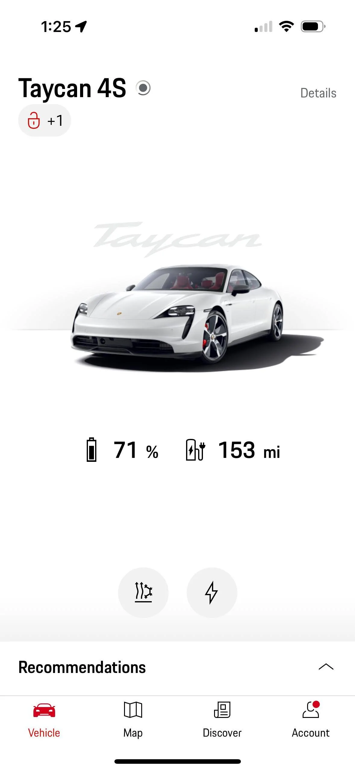

I have a 2020 Taycan 4S and have a few issue with the app. I can do the pre heating just fine but only the hvac and steering wheel will heat but not the seats. I used to be able to turn on seat heat but not anymore??
Also, the app doesn’t have the Porsche key icon so it won’t allow me to unlock the car or those kinds of key fob features.
What can I do to get the app for all the features??
thanks…

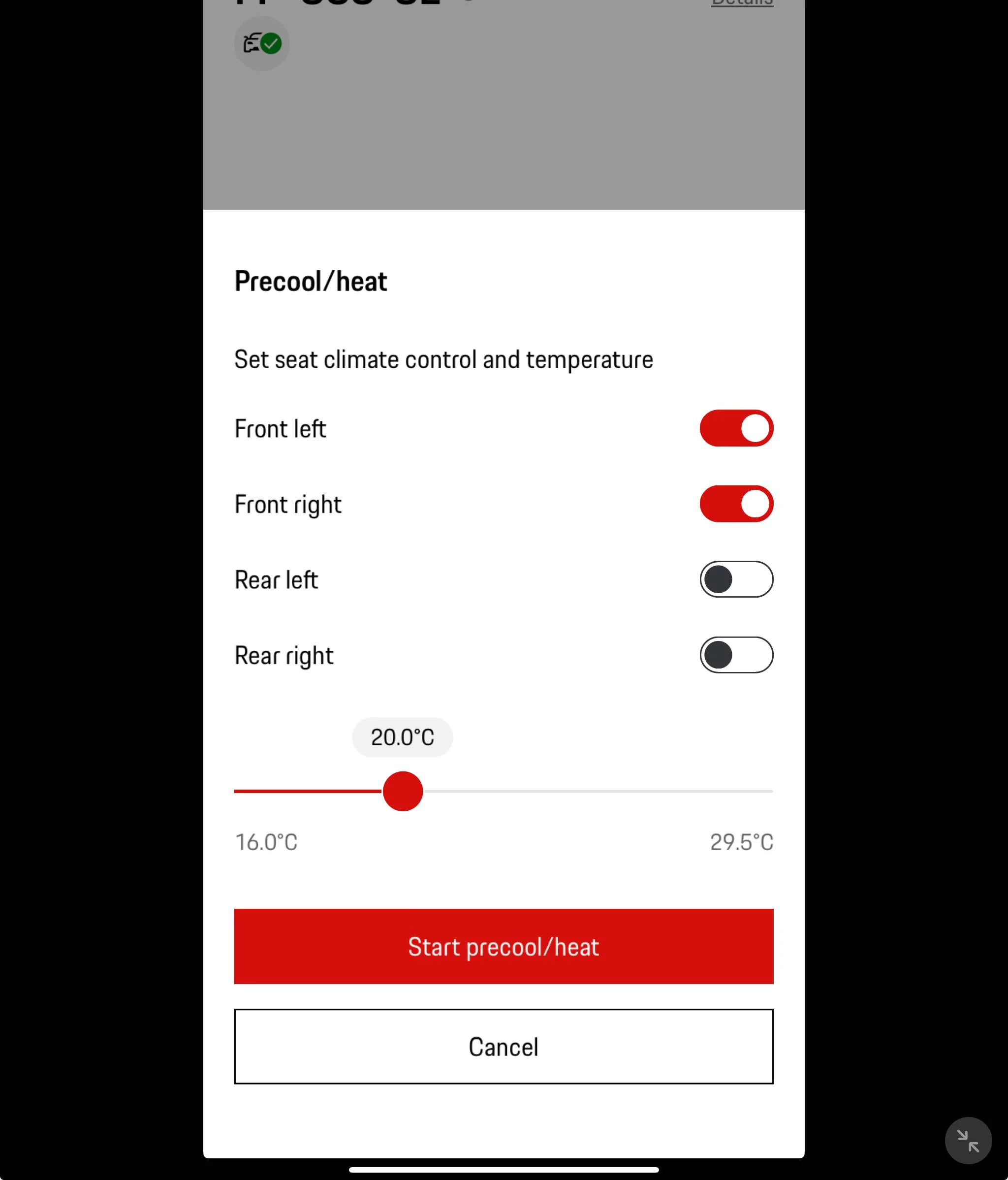

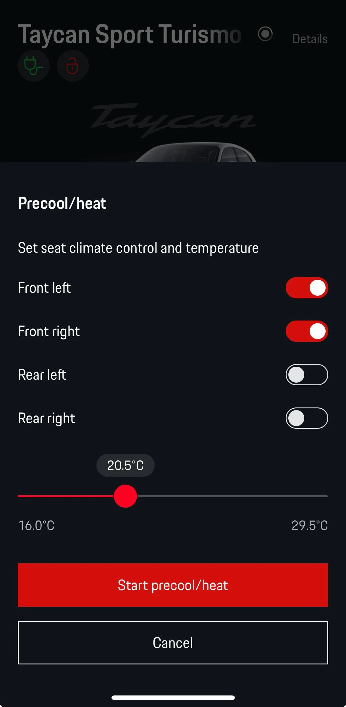

I still have the option to select seats that are heated, perhaps because I have the rear seat hearing option as well?

You are correct, my settings have also come back now!
This has not been visible for a long time in my app!

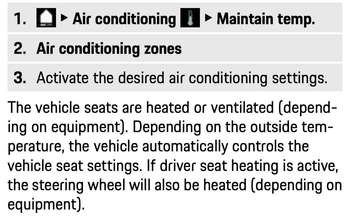

Actually, this is related to the seats heating or ventilation.

Is that not air conditioning zones rather than seats?
Not sure since I did not have that for a long time. It might be? Need to test that in the next couple of days since we are on route to France shortly and it’s cold here. Minus 25 degrees C and the car is properly frozen and covered in snow.
