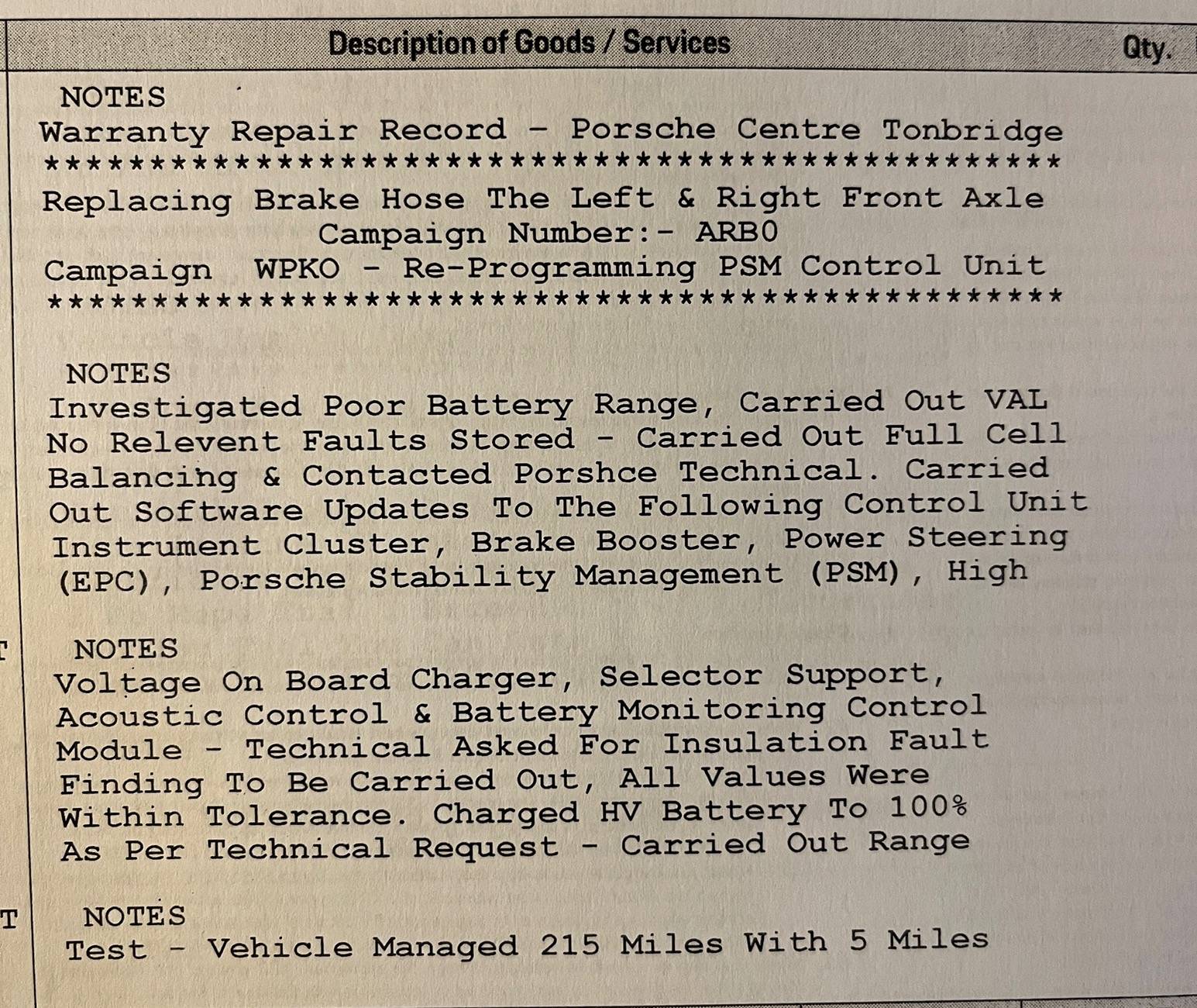

Well I’m currently stuck while they figure out if the battery went wrong because of a fault in the car (they won’t fix it under the battery warranty if so) or the mysterious drain and “anomalous isolation readings” are battery alone. It’s a constant to and fro between my Porsche centre and Porsche uk (and Porsche Germany). Four weeks of occasional tests and sending data while my car mostly sits in their car park. The frustration is that it’s completely driveable and useable for shorter journeys even with this issue.
writingpeter
Aug 7, 2024
44

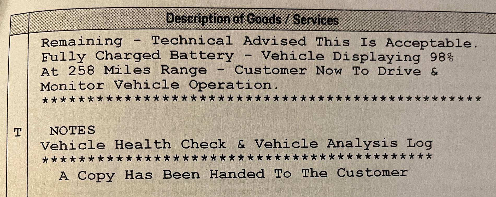

Two months later and the Taycan is back home! Apparently all fixed. The solution? A complete reinstall and upgrade giving my 2020 Taycan 4S the software of the latest 2025 model. The latest battery management software has (according to them) completely reset the battery cell that was previously “out of wack” (initially by 6% and at its worst by 23%). Now it’s completely balanced with the others. Road tests show a real life range of about 220 miles; it’s reporting 258 from 98% (which for an old car with 58K miles is considered pretty good by Technical.)
It’s a different car now. Software updates to just about all systems plus the brake recall means it drives and recuperates like 2025 models - massive improvement in braking. The journey back from the Porsche centre always took 10% charge previously- today the same journey took 6%. Apparently steering, PSM and everything else is also upgraded- less noticeable but it does feel a bit more sporty.
The key symptom I was seeing previously of the battery being heated to 30C most of the time (which I personally think was causing the huge battery drain while parked and reduced range) has now gone. It first began after a new heater and pcm upgrade. Now the 2025 software seems to have resolved it…. I hope!
Apparently my car may be quite rare right now: a 2020 4S running 2025 model software. I’ll report more on what I notice if anyone is interested!

Thanks for the information and details from tech report. First case I am aware of that apparently a software update and cell balancing themselves fixed problem of losing SoC daily. Perhaps updating "Battery Control Module" software, the ecu that sits at the top of the 'E-box', was the primary fix for the battery problem.
They claimed it took just one drive after the update for the batteries to rebalance themselves.

The whole suite of software updates to my car were kinda a last resort suggested by Technical before resorting to an expensive battery rebuild as they couldn’t figure out what was causing the strange behaviour. Looks like it may have been a software issue all along. But I’m not sure they’ll do this with a normally functioning vehicle. I think this was a “try and see what happens” update. From what they said, I’m not sure the software is designed for this model at all. The tech people were literally fist bumping each other at the unexpected success of it…

Did you find any new user interface with the new SW? Did the displays change to show the 2025 displays or just stay? Do you have any idea if the updated all the Software in all the 100+ ECU’s or just the BMS software?
