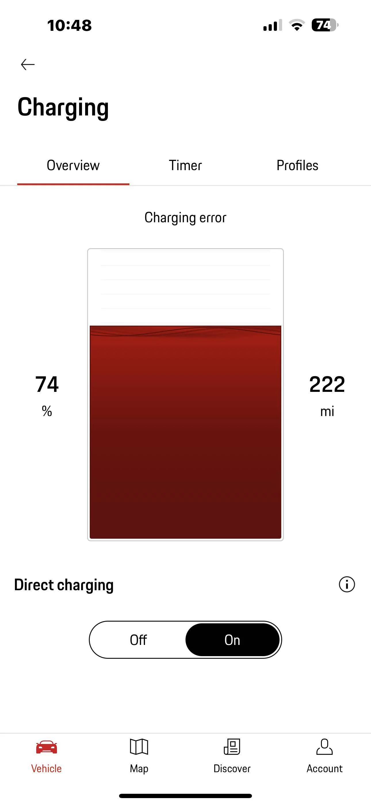

My 22 Taycan isn’t charging right after one year. I took it to the dealer and he confirmed that the settings were right and said my likely issue is at home. Is there a diagnostic test to determine if the device is working properly before I have to hire an electrician?

we're going to need more information and perhaps a picture of the PMC+/PMCC - that being said it could be a LOT of reasons - did the dealer test your vehicle or also test your PMC+/PMCC?

is the charger showing an error on screen?

an error like this is not settings based - it's an electrical fault - sometimes cleared by switching the circuit breaker off and then back on.

Thanks for all the troubleshooting questions. I’m on a 40amp line in a new construction home (1 year old). The power was fine until last 30 days.
j just tried the right side port and the charger functioned perfectly. While the left was wonky. It never finished the charge and reported a charging error. Net net is right side is working while left isn’t.

Mine started doing this after a year also. I believe it is heat related.
Trying switching to "50%" charge rate by pressing and holding that button after resetting the power to the unit.
It will take longer to charge, but will avoid the error.

If you can charge car with both ports at a public AC charger (non-Porsche), then it is unlikely the problem is the car.
An unreliable EVSE might work intermittently, depending on temperature, etc. Does it consistently work on one port and not the other, including on days with different temperatures?
Porsche TSBs about their EVSEs essentially advise dealer to recommend running them at 50% power. Not a lot of dealer diagnostics for the EVSE.

In summary....
There is a known issue with the Porsche product that is related to under sizing of the cable, causing it to get too hot, causing the fault you're seeing. The solution they have instructed is to limit the charge current (increasing the time). They are not admitting this a product warranty issue at this time.
