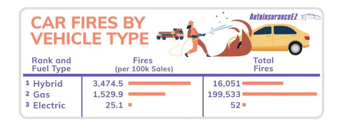

So I re-read the Car and Driver article, and they are actually questioning where the statistic of "x,xxx Fires / 100k Sales" actually came from and which year it may apply to. While the "Total Fires" adds up to a number roughly equal to the total in the image, without defining the meaning of "100k Sales" (is this yearly or total?) it is hard to understand the meaning of the statistics. I'll look into this further.
Original Post
Some interesting facts garnered from Perplexity.
“The exact number of auto fires in 2024 has not been finalized, but estimates suggest the trend remained consistent with previous years. Between 2018 and 2022, U.S. fire departments responded to an average of 215,096 vehicle fires annually. In 2021, there were approximately 174,000 highway vehicle fires reported, and this figure has shown relative stability in recent years.”
And from Car and Driver
Question
Are electric vehicles more prone to fires than gasoline vehicles
Answer
Electric vehicles (EVs) are significantly less prone to fires compared to gasoline-powered vehicles. Data from the U.S. National Transportation Safety Board shows that gasoline vehicles are 60 times more likely to catch fire than EVs, with hybrids being 138 times more likely For every 100,000 vehicles sold, EVs experience about 25 fires, compared to 1,530 fires for gasoline vehicles and 3,475 fires for hybrids.

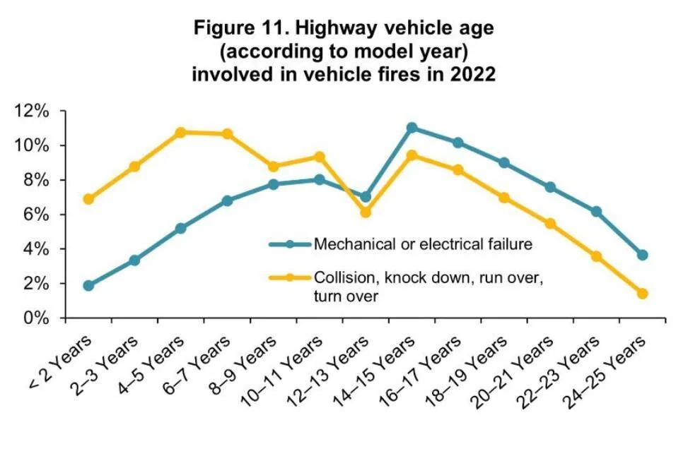

The statistic about EV fires compared to ICE fires has been, in multiple variations, going around for the past 2 years. I have never seen it carefully supported. Among the problems, the NFPA report on vehicle fires doesn't include the words "EV" or "BEV" or "electrical vehicle.":
https://www.nfpa.org/education-and-...search/fire-statistical-reports/vehicle-fires
Even one of the online articles (with the title "You're wrong about EV fires") admits:
" The NFPA analysis even goes out of its way to mention the lack of data on EVs and makes no claims about the frequency or likelihood of EV fires."
Even when you see statistics (and the article had a graphic with some statistic), I note the following (agreeing with at least two others here):
1. Age-adjusted statistics would be better than comparing:
(a) an ICE fleet that has (in the US) over 200 million units, many of which are 10 years + old and used less, are modified, have repair issues, etc.; and
(b) an EV fleet that has an average age of probably 3 years or less, and is sold to mostly affluent homeowners, and whom appear to drive fewer miles.
The available data (see graph) shows that age of vehicle is strongly correlated with fire incidence.
2. Severity of fires matter as much as frequency.
3. Does it really make sense to compare number of fires with sales? That's what is in one of the graphics. That doesn't really make much sense. Comparing number of fires with number in fleet, or number of miles driven in the fleet, or some similar measure makes sense. EV sales are, relative to the size of the fleet, very large. ICE sales are a fairly stable fraction of the fleet. Thus, a statistic measure fleet effects compared to sales is going to be distorted with BEVs.
I would very much like to see real data, supported by actual research, on this question. If somebody finds it, please post it here.
