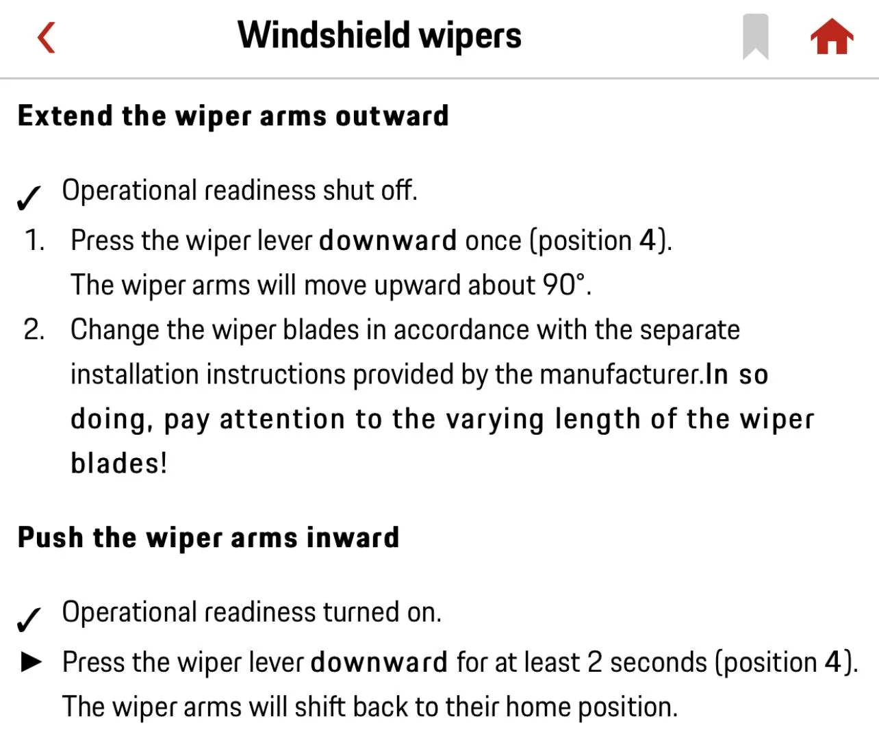

As the subject is specific to Taycans in cold climates - here are two engineering flaws…curious if anyone has a work around or if I am just dumb.
1. Any snow that collects on the hood turns into a solid block of ice if you don’t clear it quickly as there’s no heating system underneath to melt it like on an ICE vehicle.
2. When we have a car outside in a snow storm I can’t seem to be able to lift the front or rear windshield wipers off the glass. The mechanism doesn’t seem to allow it at least not in any obvious manner.
Invariably they freeze to the windshield so when you preheat the car, the top portion will melt but all the snow below them has to be physically removed or it freezes as well. This also means the wipers themselves have to be cleaned repeatedly to get the frozen ice off so they can actually do their job.
Odd and imprecise engineering vs the Porsche standard of excellence esp in cold climates.
Any suggestions? Curious how others handle this when a garage isn’t an option.
Does this help? Same process as changing the wiper blades, except leave the arms up and folded out while parked in the snow. From the Good To Know app:
Porsche Taycan Taycan in cold climates - your experience? 0FB5A31D-5A3D-4D85-A285-B558FF67790A
Meant to say thank you earlier.
This worked like a charm!
Grateful for your response!
