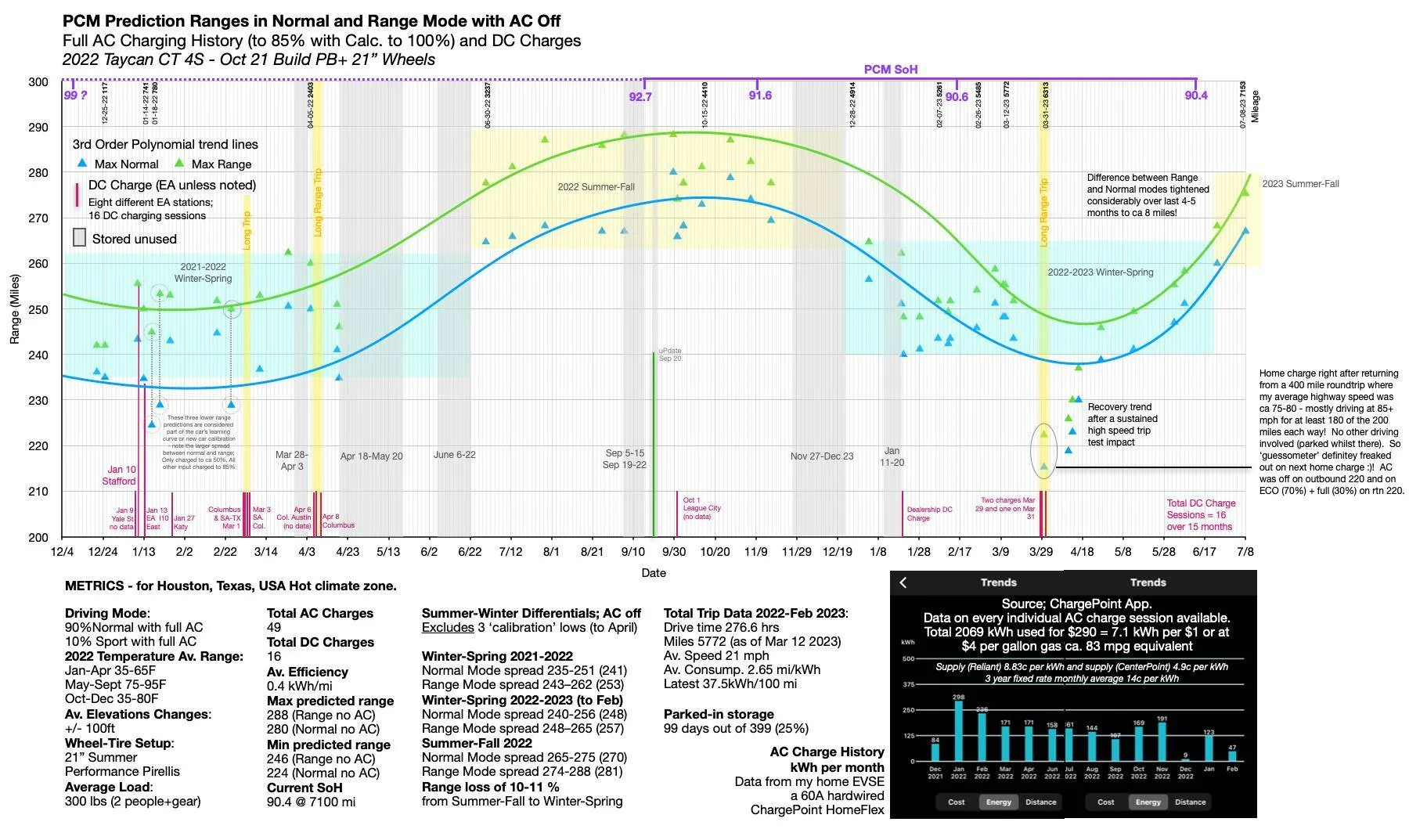

unmentioned in any of the replies is that my range and energy efficiency are better during the hot summer months than they are in the cooler winter month.
For ref., I've posted my analogous information in this chart in multiple threads over the last year plus and continuously updated here:
#1
- one more for the road I guess :)
Porsche Taycan How well does Taycan handle hot climates? Screenshot 2023-07-11 at 1.34.03 PM

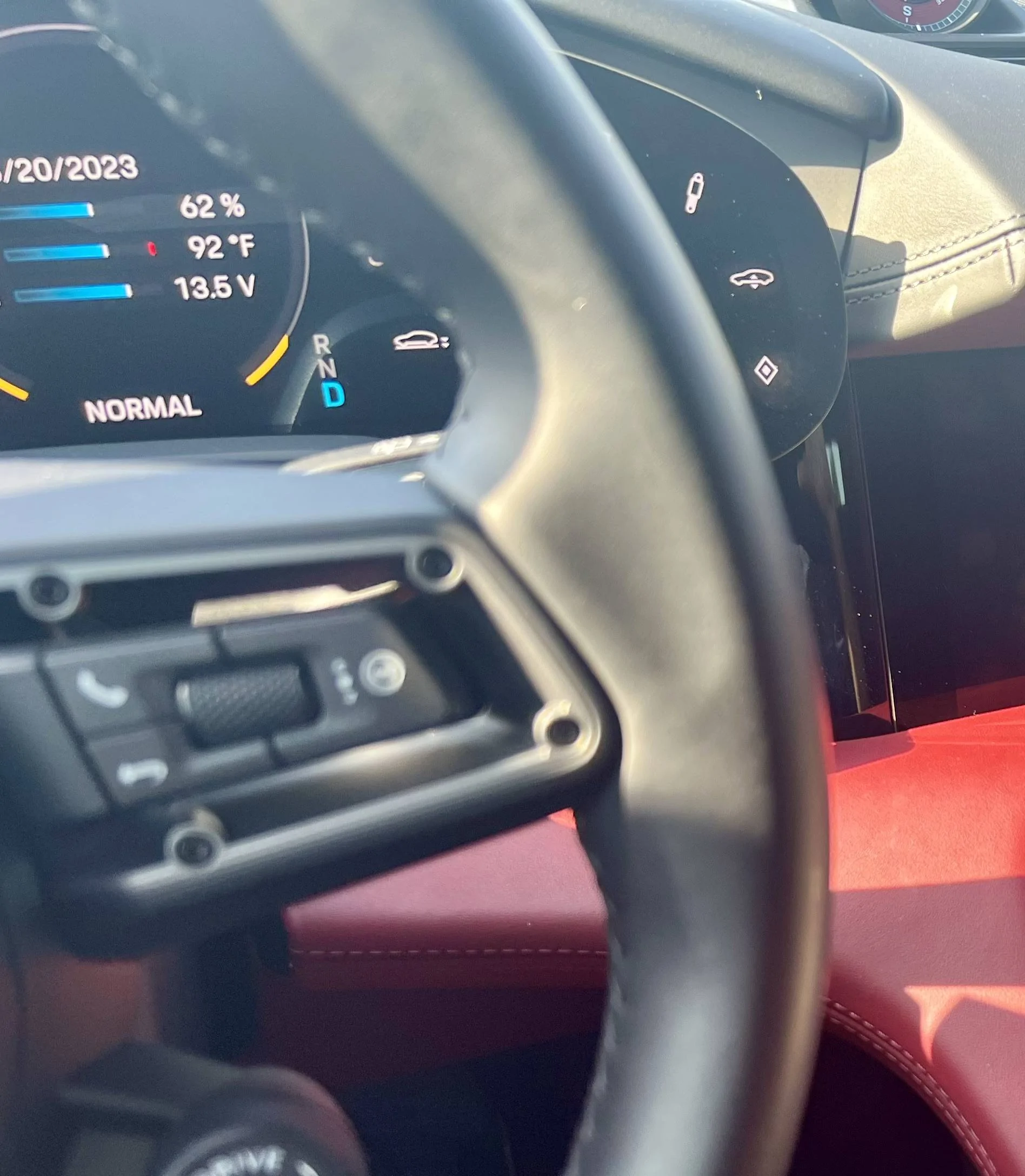

In regards HV battery temps - here is a pic of mine hitting 92F in a 110F day driving around Houston last month - can't recall ever seeing it higher but yes max. temp managed by the PCM:
Porsche Taycan How well does Taycan handle hot climates? IMG_2025

Thanks for sharing your visualization of your efficiency data! I don’t have the skill to plot mine but I’m sure the pattern of my 2020 Turbo is very similar. During this very hot month of July, my morning estimated range has been between 238 and 244 miles on an 80% overnight charge. That implies a range of between 297 and 305 miles on a 100% charge during the hot summer weather. In a cooler month like January my morning estimated range would be between 218 and 224 miles on an 80% overnight charge. That implies a range on a 100% charge of between 272 and 280miles.
If my Turbo is a bit more efficient than your 4S, I’d guess the majority of the difference can be explained by the difference in wheels. I’ve got 20” Turbo Aero wheels and I’m pretty sure they are more efficient than the 21” wheels you have. I doubt differences in humidity might have anything to do with it but Scottsdale AZ has far, far lower humidity levels than Houston TX (I lived in Dallas for 30 years and traveled to Houston quite a bit so I know all about summer humidity in the Great State of Texas). Thanks again for sharing your data. I think you and I both agree that the Taycan handles hot climates very well right?

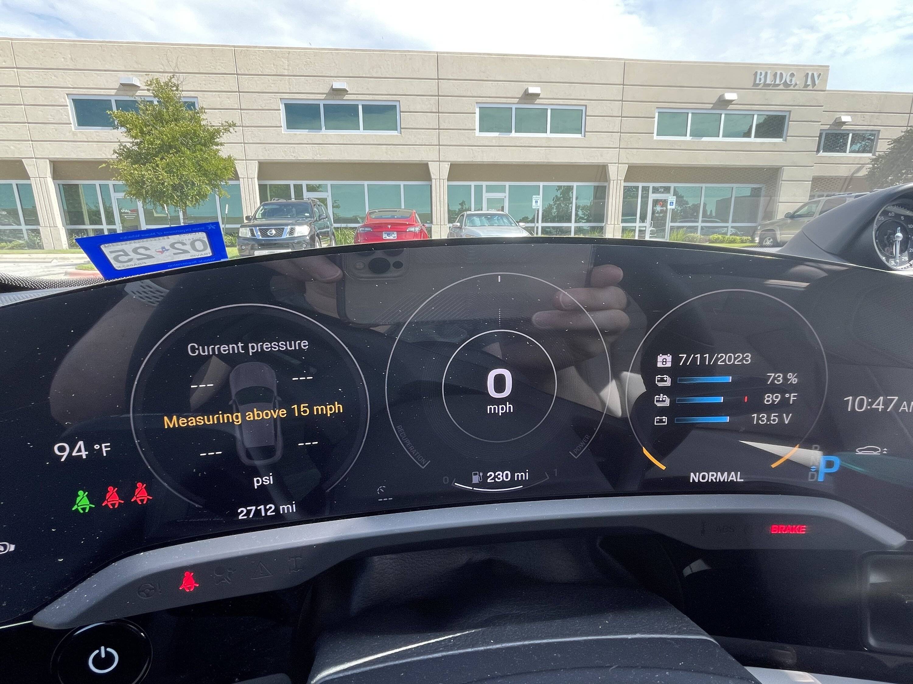

I have been sitting in the car, waiting for my son for an hour and a half. AC has been running, battery temp is still holding below ambient.
230 miles of range at 73%???
I get 230 at 85% on my GTS. DFW, so we're in roughly the same climate.
I'm a pretty aggressive driver though, I live for jackrabbit starts...
That is really impressive for the CT 4S.
You and I I think ‘birds of a feather’ as almost identical range predictions and driving style! :)
Oh I drive fast when I can. In any vehicle I quick accelerate from stop signs/stop lights if possible. Most of my driving is around the Austin suburbs, so 45mph speed limits, which does wonders for range. When out on 183A, going 85 range drops pretty quick.
