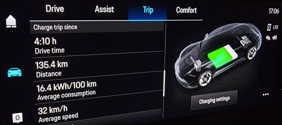

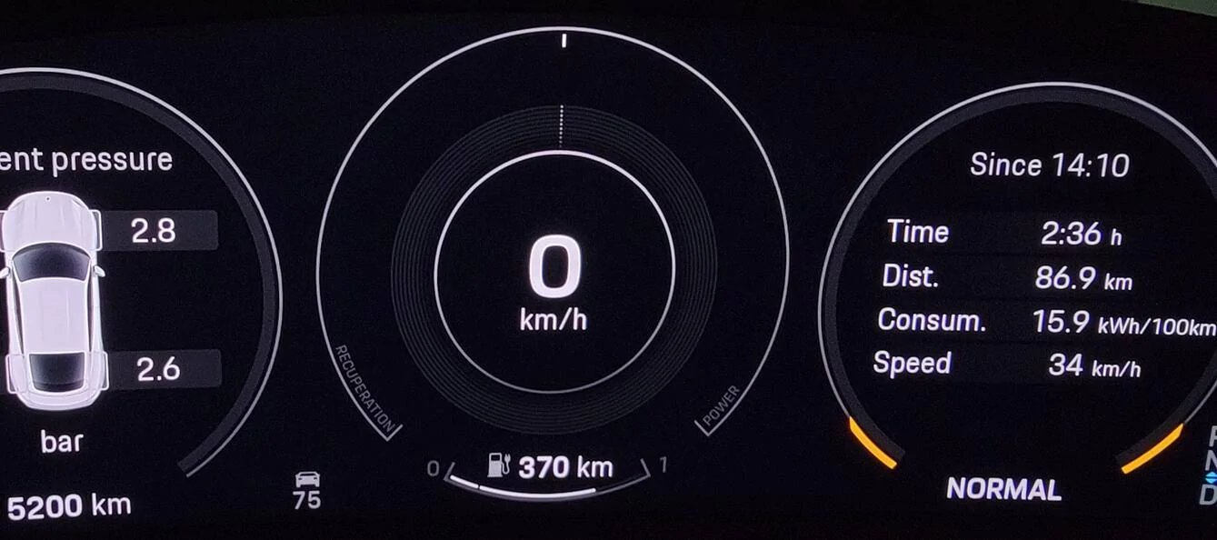

Anyone getting over 300 miles per “tank” as this suggests? My 4S is on order and I would LOVE to get that kind of range !
In that weather, easy:
Porsche Taycan Taycan outperforms EPA range estimate by the widest margin in Edmunds EV Range and Consumption Test 1613090994915
Porsche Taycan Taycan outperforms EPA range estimate by the widest margin in Edmunds EV Range and Consumption Test 1613091065293
505 km is 313 miles with mixed city and city highway driving.

That is truly an awesome range figure @feye, however, 32kph is 20mph. My Taycan cannot travel at that speed once it leaves the driveway. It's a Porsche for Pete sake... :cool:
What do you suggest? Mount a plow in front of the car to clean the city roads of all the ICE snails?
