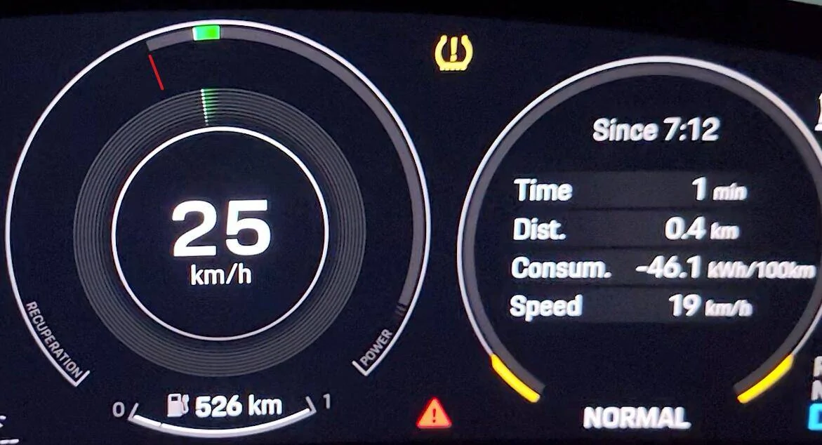

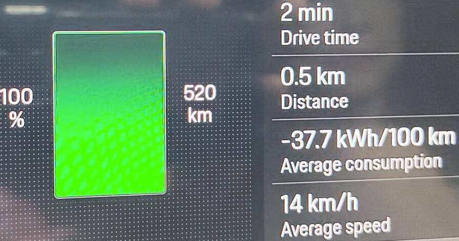

I only have 0.5 km downhill, but SoC stays 100% all the way down. On the power meter you can see, I have still quite a bit of regen left, which I gave me the negative consumption.

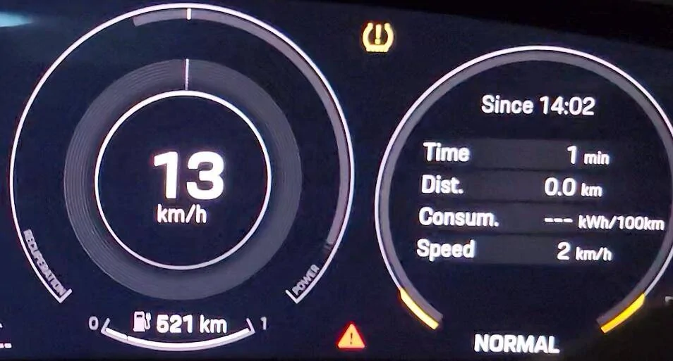

Another time I left with 100% SoC.
Porsche Taycan Taycan Secret Tips and Functions 1630582764661
At the top, I had 521 km range
Porsche Taycan Taycan Secret Tips and Functions 1630582867123
But at the bottom of the hill with negative consumption, I had 1 km less of range. Funny way how this BMS works... :)
I'm confused. I don't see you regenerating power at all, which to my recollection would be the green arc moving counter-clockwise from top dead center.

A lot
No, you had 100 meter less range as you don't see the decimals.
520,4 will show 520 where 520,5 will show 521... ?

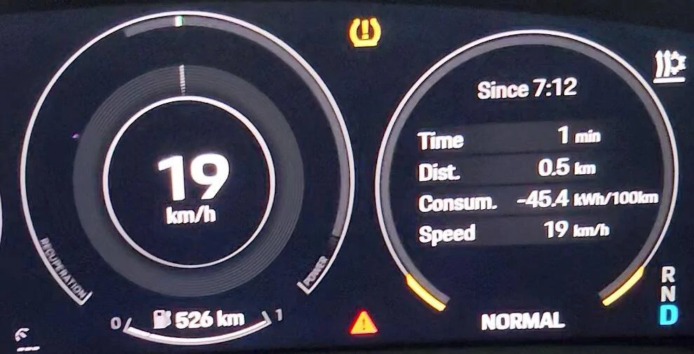

I am not continuously breaking when I drive down. Here is another one showing recup.
Porsche Taycan Taycan Secret Tips and Functions 1630626930379
Red line would be max recup. Not much, when the battery is full.
Porsche Taycan Taycan Secret Tips and Functions 1630627359104

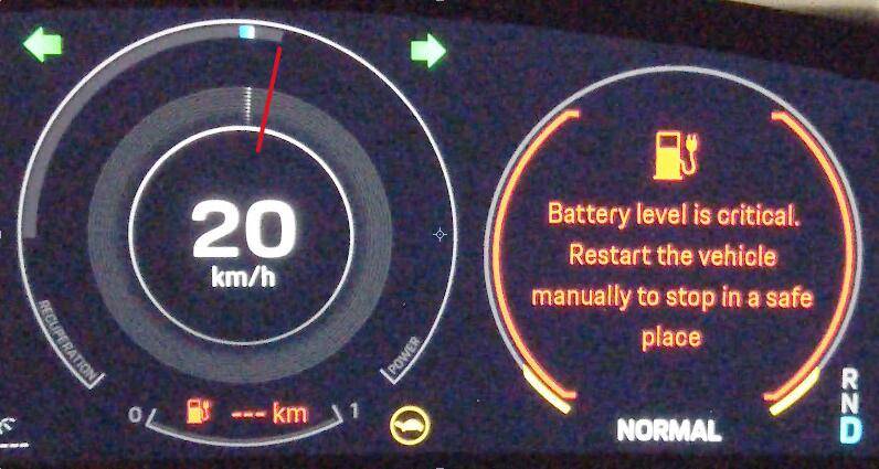

Reverse is true with empty battery in turtle mode on available power.

I love that @feye has run the car down to the point to be able to show the turtle mode acceleration power limit.
