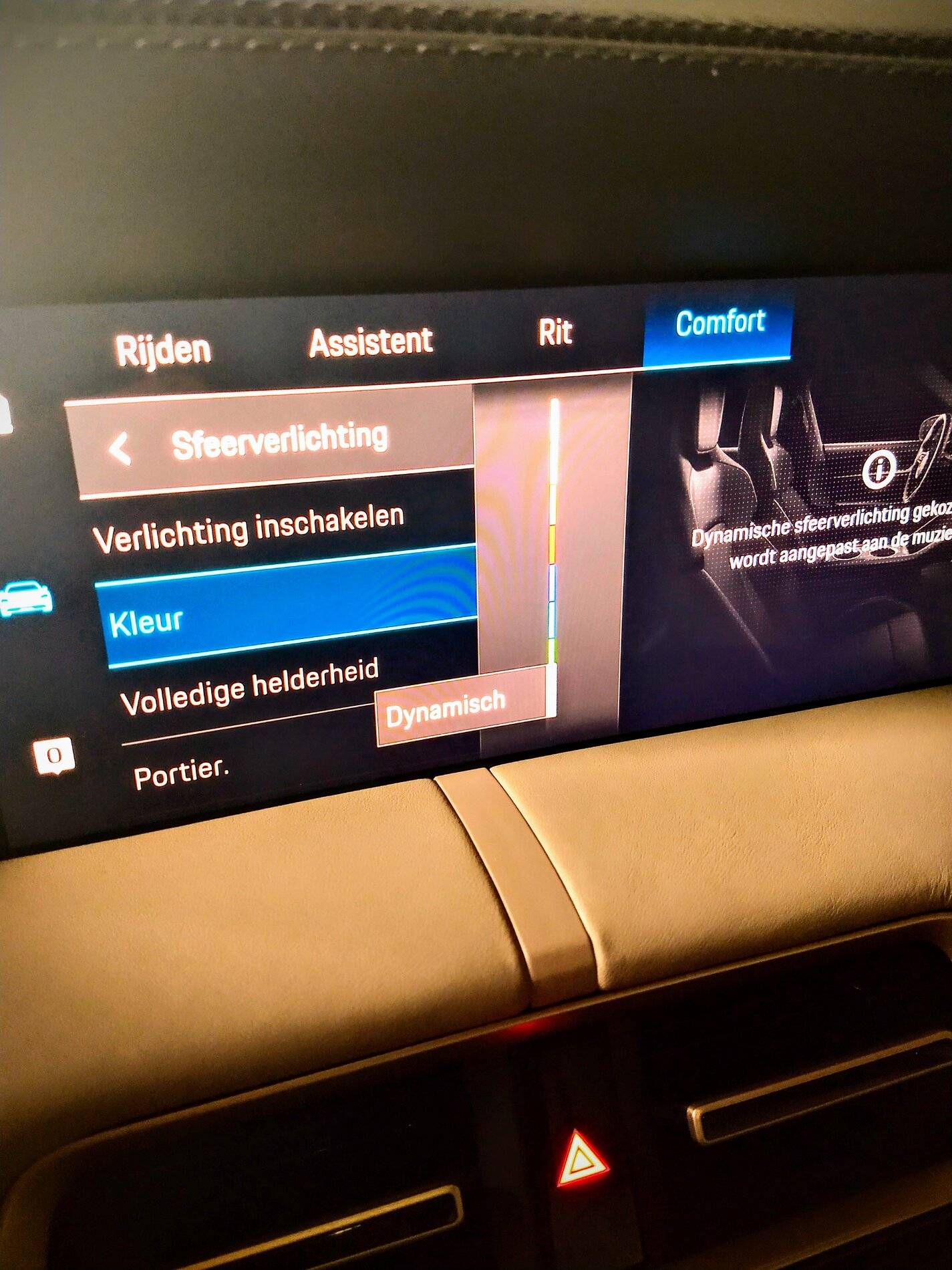

  • News on Passenger Screen is gone. Icon is there in center, but it doesn’t seem to work. (Not that it really worked before the update.)
  • No Dynamic Lighting Option. However, I don’t know if I ever had Dynamic Lighting. It isn’t there now.
Otherwise, the update was great. Not sure I even care that much about the above.
OK, I just discovered that Dynamic Lighting is not where I was originally told it would be. It is in the Media section when you press the “...” in the lower right corner. So I do indeed have the Dynamic Lighting! So scratch that one off.
Media section?

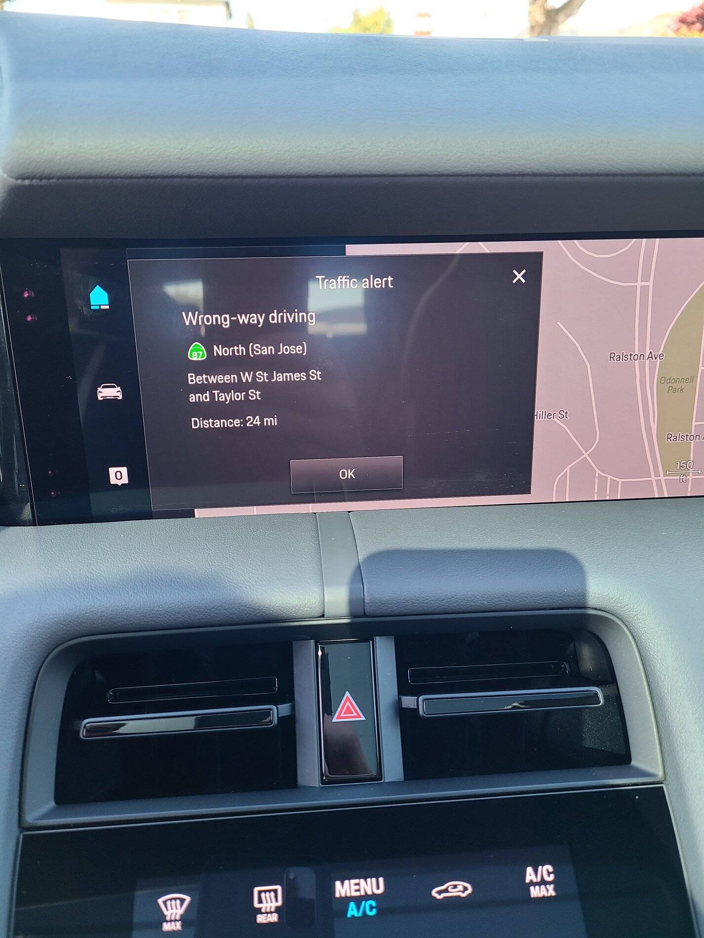

One more new bug after the update. While driving and without using navigation to any destination a warning popped up about a traffic alert 24 miles away!!! Totally random and it has never happened before.
This isn’t a bug. It’s a safety feature.
I had a similar warning during a test drive with a MY21 4S
chrisk
Dec 3, 2020
975
1,025
Safety feature? That was 24 miles (39km) away from where I was. It is even a differently county. And I was neither driving towards that direction nor had a destination in my navigation in that area.
I have never seen a warning being so off in any other car or phone navigation app.
The only safety issue is in this case was the useless warning itself forcing me to read it and figure out what it is while driving.
F16HTON
Feb 18, 2021
166
233
Hawaii
992 Carrera, Taycan RWD
Every Audi, VW and Porsche navigation system I have had (since 2002, 12 cars) has had this traffic alert feature and I would get traffic notifications of wrong way vehicles hundreds of mile from my current location.
I would turn off the traffic notifications because they were not of real use to me. Perhaps they may not have been active by default you Taycan before and with the new update they are active by default now.
I'm not sure if you have the "good to know" app, but it is an interactive online manual for your car you can refer to.
The "good to know" app states the traffic notifications are the responsibility of the broadcasting companies and Porsche cannot assume responsibility of the completeness or accuracy.
Perhaps with the new software update, Porsche has changed the broadcasting company? That may also be an explanation of why they began coming up in now, when they have not in the past.
Either way, it is absolutely not a bug or issue.
