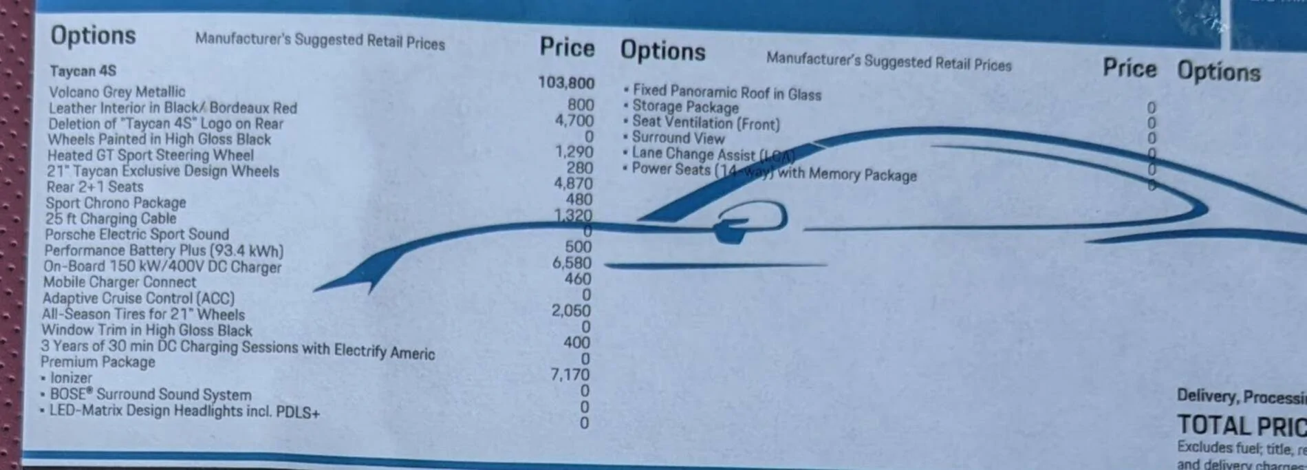

Here is the window sticker for the 2021 4S I test drove. It does not have Power Steering Plus. I guess that explains it?
Porsche Taycan Taycan steering feel Screen Shot 2021-11-25 at 8.23.29 AM
Certainly would improve things markedly when fitted. Note that it is also available as a Function on Demand (no prior hardware factory fit required) which can be paid for or used on a subscription basis and downloaded for a trial basis on demand. It should (of course) be standard - this is a Porsche for heaven's sake!

I see so it is a software feature. I guess it changes the power steering boost mapping. Nice that you can try it before buying it! And yes it should be standard (like a lot of others).
