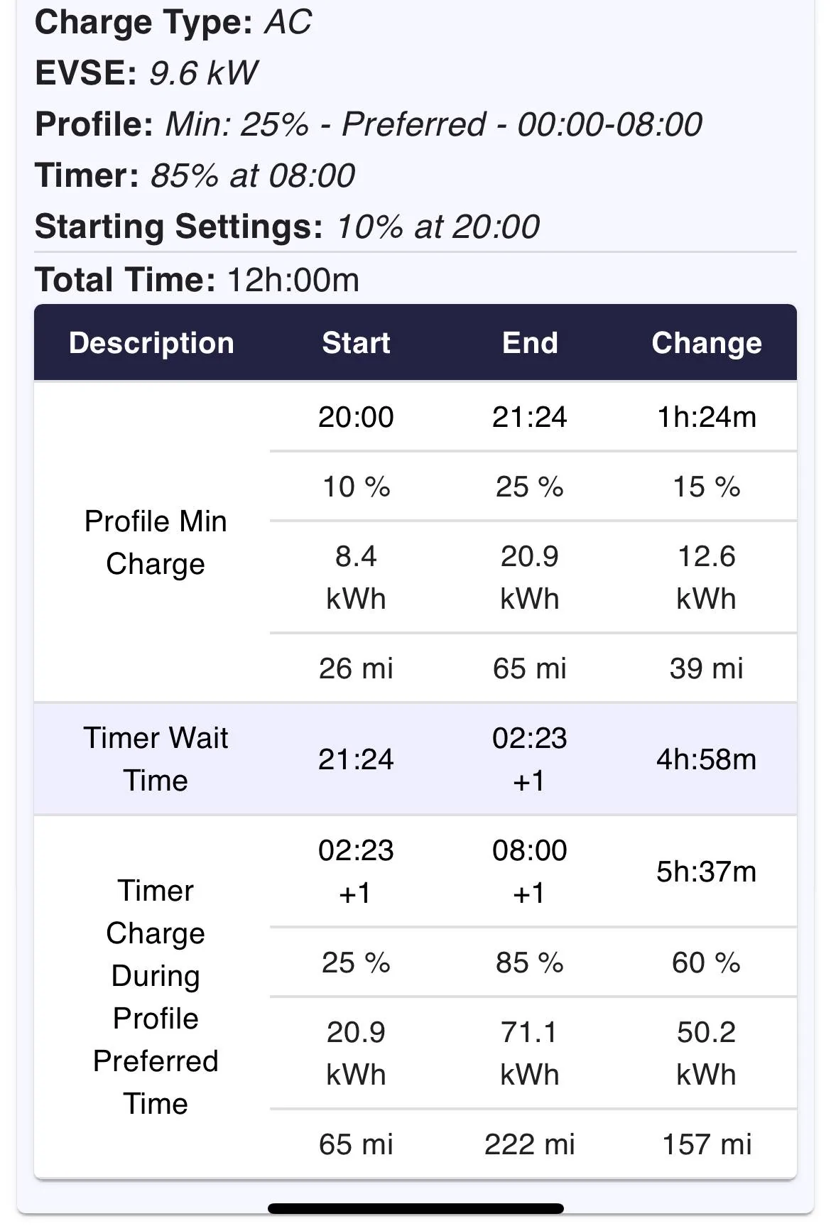

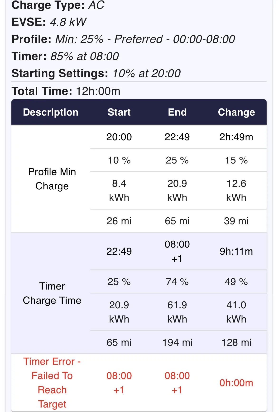

First, you don’t need a profile in this case.
Only the timer.
The car will always charge to a 25% min in all cases and the timer will control the start time. Because your profile min is 25% and the preferred time ends at the timer departure time, the profile has no effect. You would use preferred time if the window was different than your departure time to force it charge to the timers target charge earlier than the timer would otherwise select.
One possible cause is the detected EVSE power is not sufficient for the timer.
Please list:
  • Starting charge when plugging in
  • Plug in time
  • Expected EVSE power
  • Actual displayed power when charging

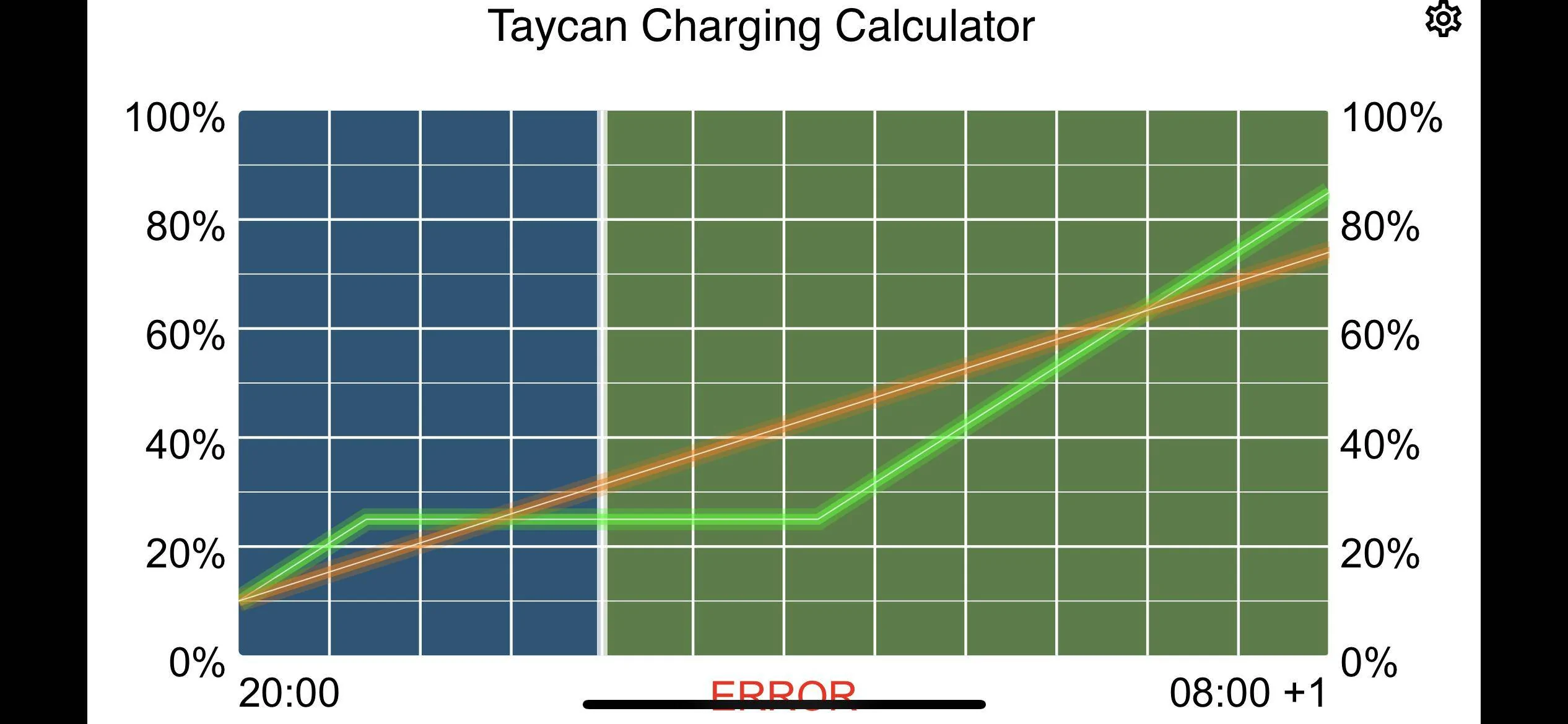

As an example, the below graph shows plugging in at 10% at 8pm using your settings with two different EVSE units. The green is 9.6kW and the orange is 4.8kW.
The green doesn’t start charging past 25% until almost 2:30am, well within the preferred times. The orange just charges the entire time without reaching the target. The shaded area is the preferred time from the profile.
Porsche Taycan Taycan Timer 4F4E7F44-DE5B-4D2B-8752-C6CF2D2D73A8
Green charge info:
Porsche Taycan Taycan Timer 94FA68BD-E87A-4FB5-A22F-D70DA2509D14
Orange charge info.
Porsche Taycan Taycan Timer E090AF4F-2663-4489-B5A1-3F61D20492A1
