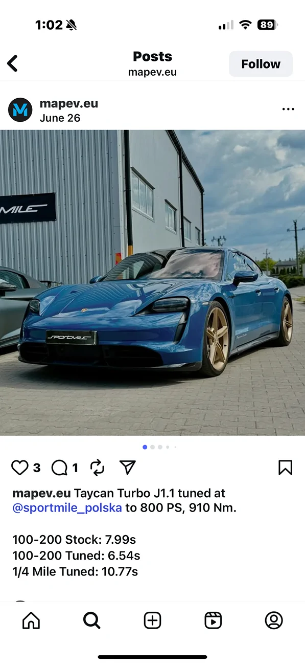

The short answer is- faster.
It may be an American thing, but we are used to knowing and comparing 0-60 and 1/4 mile and trap speeds on every car. Of course knowing that the numbers quoted are only in ideal conditions, but at least they’re numbers we can wrap our heads around because we’ve been looking at and comparing them our whole lives. 100-200 km/h doesn’t translate.
Yes we know faster is better. But those numbers are literally foreign to us.
The answer to your question about a 2021 Turbo is that it’ll be faster. Cost and power differences are seen here: https://www.mapev.net/taycan-turbo/
If you look at the torque chart, that directly relates to the acceleration you will feel at every speed. The biggest gains will be felt starting at around 30 mph and above.
You will also be SIGNIFICANTLY faster from any roll as you get full power all the time.
Either way you’ll notice the 120 hp gain over launch control and 175 more than normal.
Maybe .2 faster to 60 and half a second in the 1/4 mile if I had to guess.
Found a gen 1 turbo from their instagram:
Porsche Taycan Taycan tuned: 950 hp through software tuning IMG_4219
