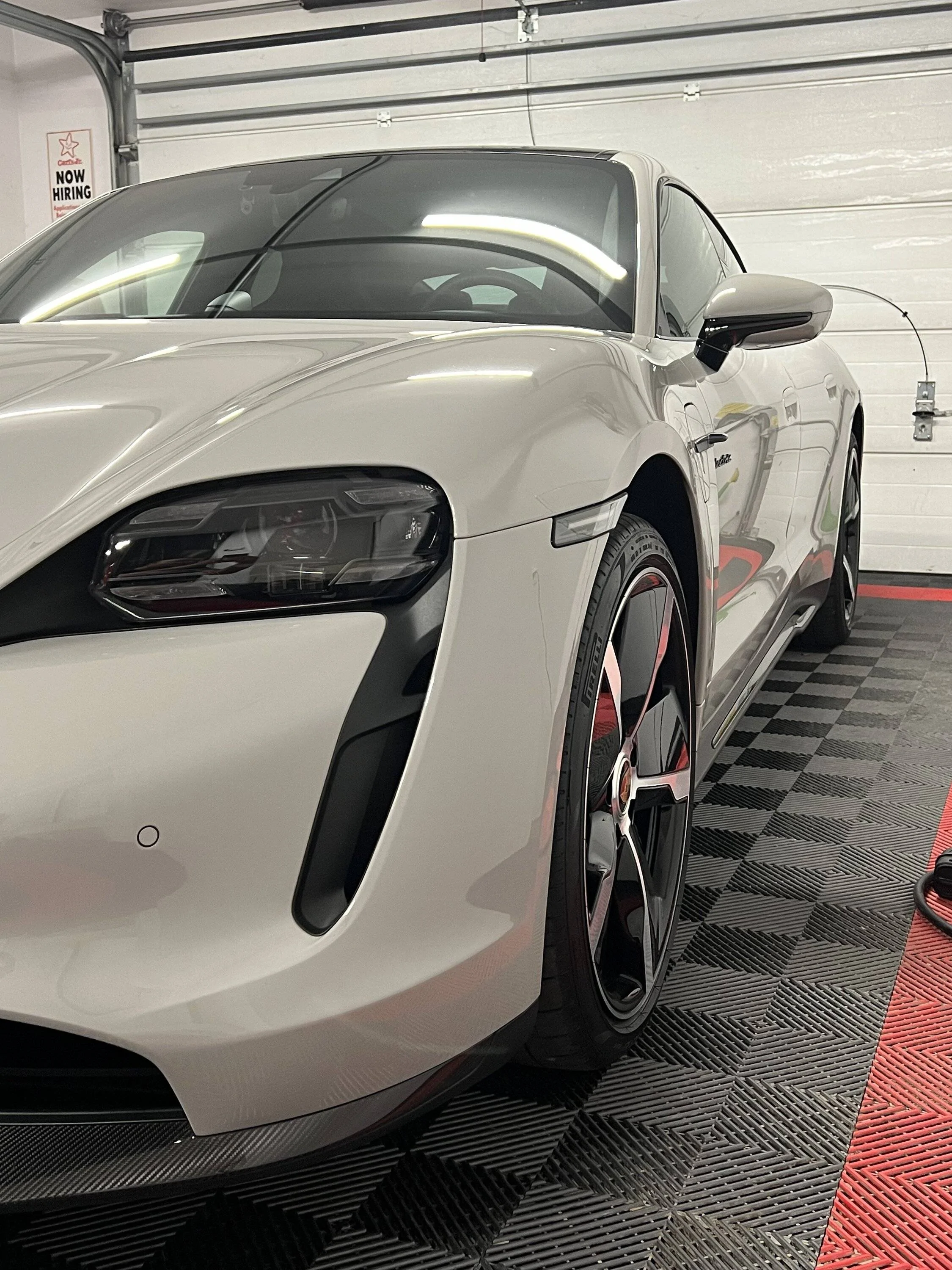

I recommend Racedeck free-flow tiles as the water sits below and eventually evaporates, while you always walk on a dry floor. I have it at home.
I can’t see the rest of that “now hiring” sign; is it for water evaporators?

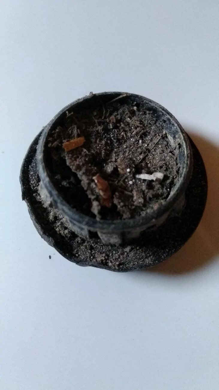

Just got a Taycan a couple days ago, mainly been driving in the rain so far and noticed abnormal amounts of water under the car on my garage-floor. I'm talking like 2 buckets full of water. Thanks to this thread I looked at the drains as mentioned in the video/pdf, I only seem to have the 2 in the middle instead of 6 in total, and both were totally clogged!
People who dont keep their car in a garage may never be aware of this.
Its a 5 minute job, no special tools required.
I've now cleaned them and took the membrane out for now, giving it time to rinse out the rest of the dirt over the next couple days/weeks. Then I'll probably put the membranes back in as the water did get out fine/fast once the dirt was removed (dirt obviously doesn't go through the membrane)

I’m sure you have 6. Front, middle, and rear of the battery. The front and rear pairs are have a different don’t protrude on the same way so they’re easy to miss. All the plugs are identical.
JAGMAN
Jun 13, 2022
216
159
RI, USA
‘22 CT4
Also, I think there are some redesigned plugs. But I can’t find the part #.
