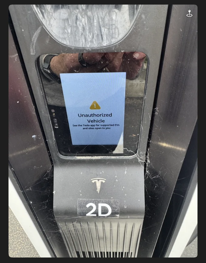

As to charging the Taycan, I've tried two SC3 and two SC4s in my area. In every case either an "unexpected error" is reported by the Tesla App or "unauthorized vehicle" from the Tesla App.
The Taycan always recognizes that a charge is being initiated but not current ever passes into the car.

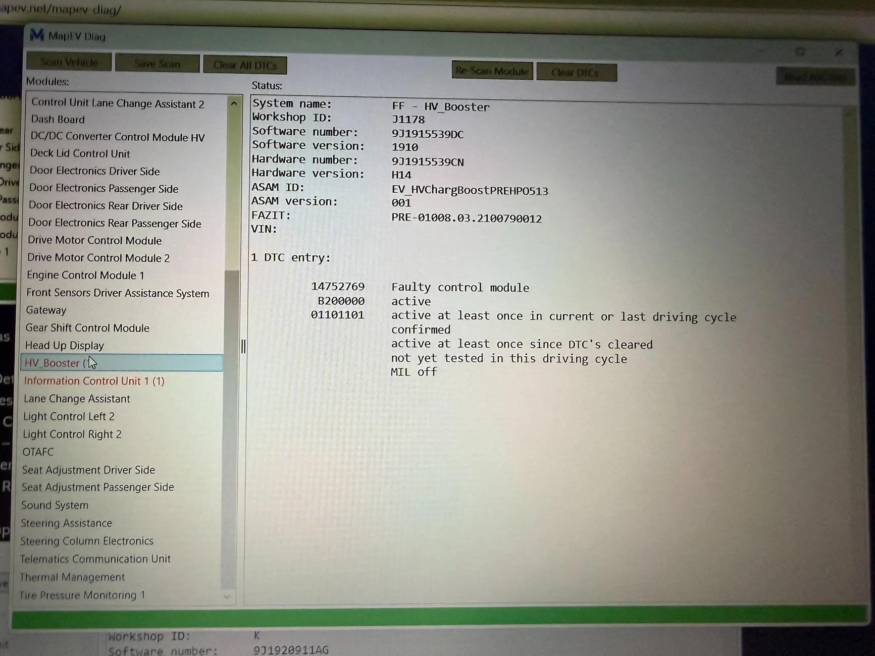

Coincidentally I just sent my car to the dealer regarding the same problem after I discovered an error code with the build-in code scanner in tCan-Pro MapEV software:

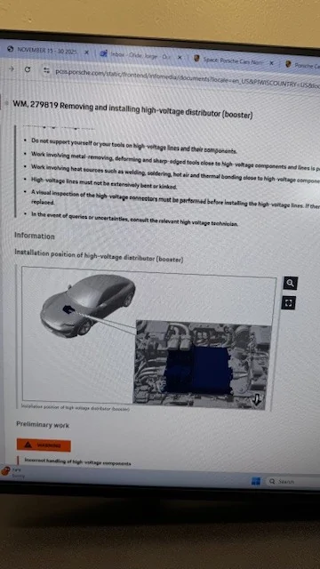

After seeing my error code screenshot the dealer was able to find the problem and is currently replacing the high voltage distributor (booster). This booster is supposed to step up 400V coming from a tesla charger to 800V that our cars can accept.

I strongly suggest anyone having problems with SCs to run a diagnosis to confirm it's not your car.
I will take my taycan to a SC once I have it back and report here.
Just FYI everything is covered under warranty. They initially suspected my adapter being the problem, but after a successful charge with the adapter on a macan EV loaner they confirmed it was my car

Hopefully they could find the issue for you. I think the high voltage booster issue also explains why EA / EVgo charges fine while some other chargers (ie EVCS and tesla) doesnt work on my car, likely because they aren't running on 800V.

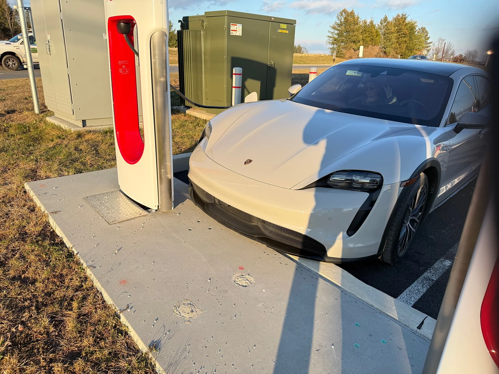

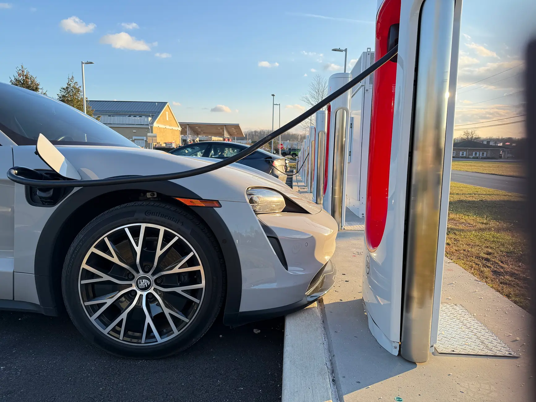

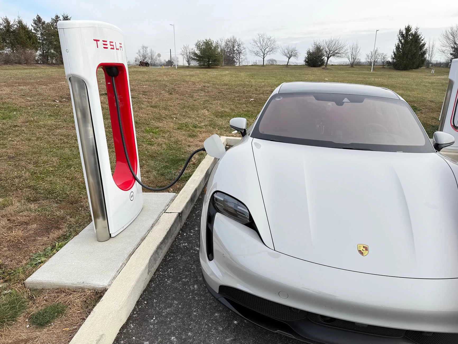

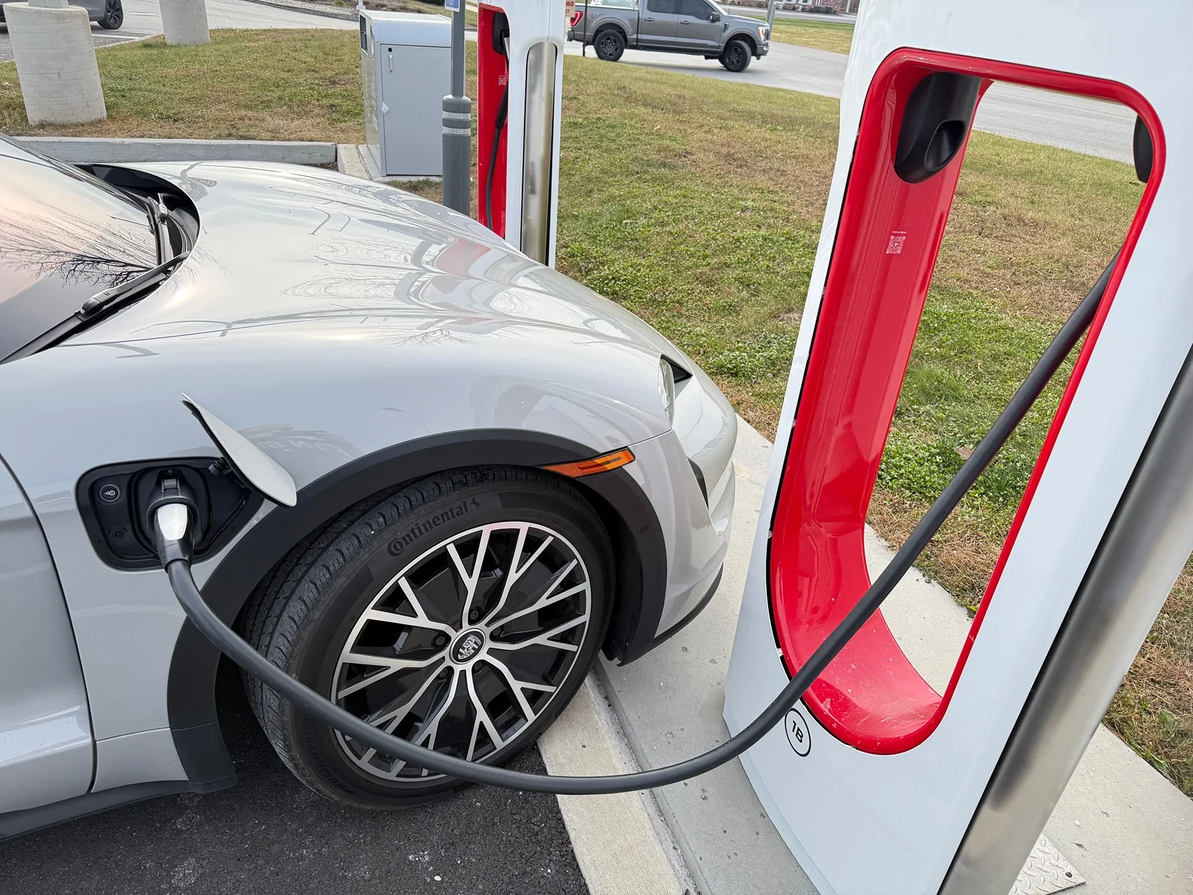

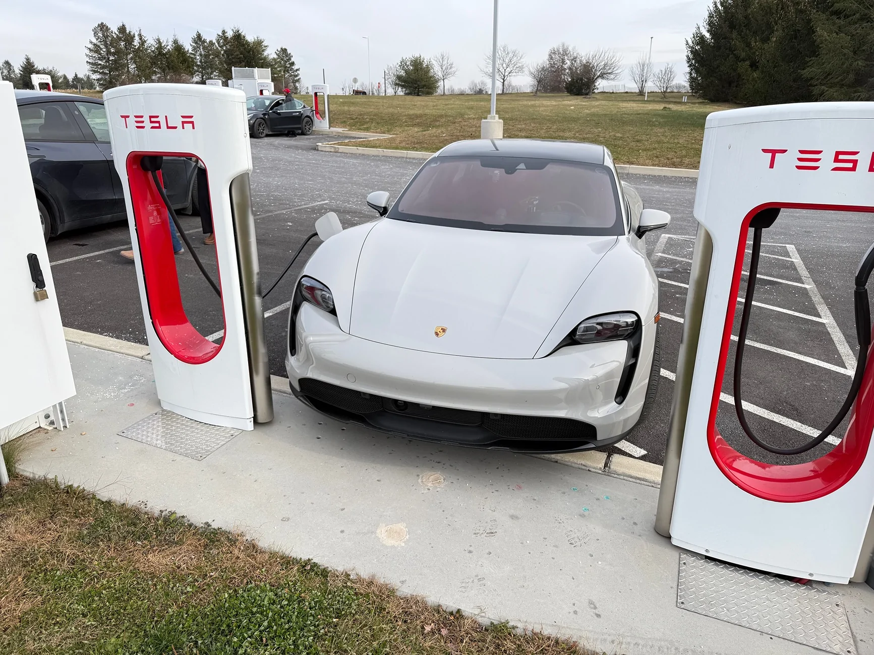

A couple pictures from a 16 stall V3 Tesla Supercharger in Quakertown, Pa. I charged there twice while visiting family and friends. On the first time I lifted the front to clear the curb to be able to connect. The second I was able to pull between 2 stalls and then the one side stall opened up and I moved to that location. Bottom line is I was able to connect at each location and charging started within a minute. Rate was $0.55/kWh.
that makes me queasy! How did you know the highest lift point would be enough?

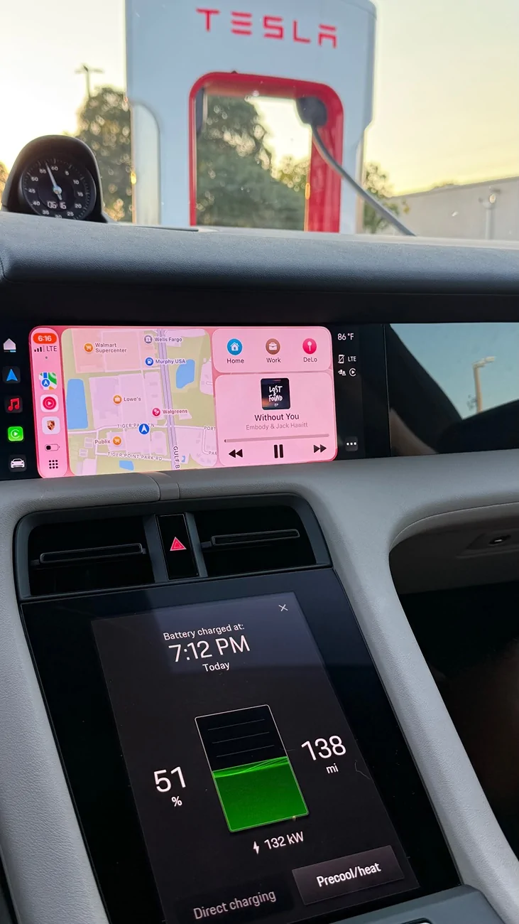

It’s been a game changer for us. After some bad EA experiences we seldom took the Taycan out of town. Got our adapter a couple of weeks ago and did a test charge earlier this week at a supercharger about 30 minutes away. Everything worked as expected. Did a 250 mile each way road trip requiring two supercharger visits this past weekend. Saw a low of 105 kWh and a high of 140. We are in SC and there are very few non Tesla DC chargers in our area but plenty of superchargers so we are thrilled. 👍🏼

To my count, Godzoo is the third member of this forum whose reported that their Taycan is unable to use the Porsche adapter with Tesla Superchargers.
I'd guess that this is a problem with specific, probably older Taycans rather than some Tesla app/charger issue. On SC4 chargers, the screen indicates that my Taycan is an "unauthorized vehicle" even though the multiple Tesla SCs I tried locally were authorized to charge Porsche EVs.
Perhaps the handshake data provided by my Taycan is somehow corrupted or aberant? If so, that would seem to be a Porsche issue.
