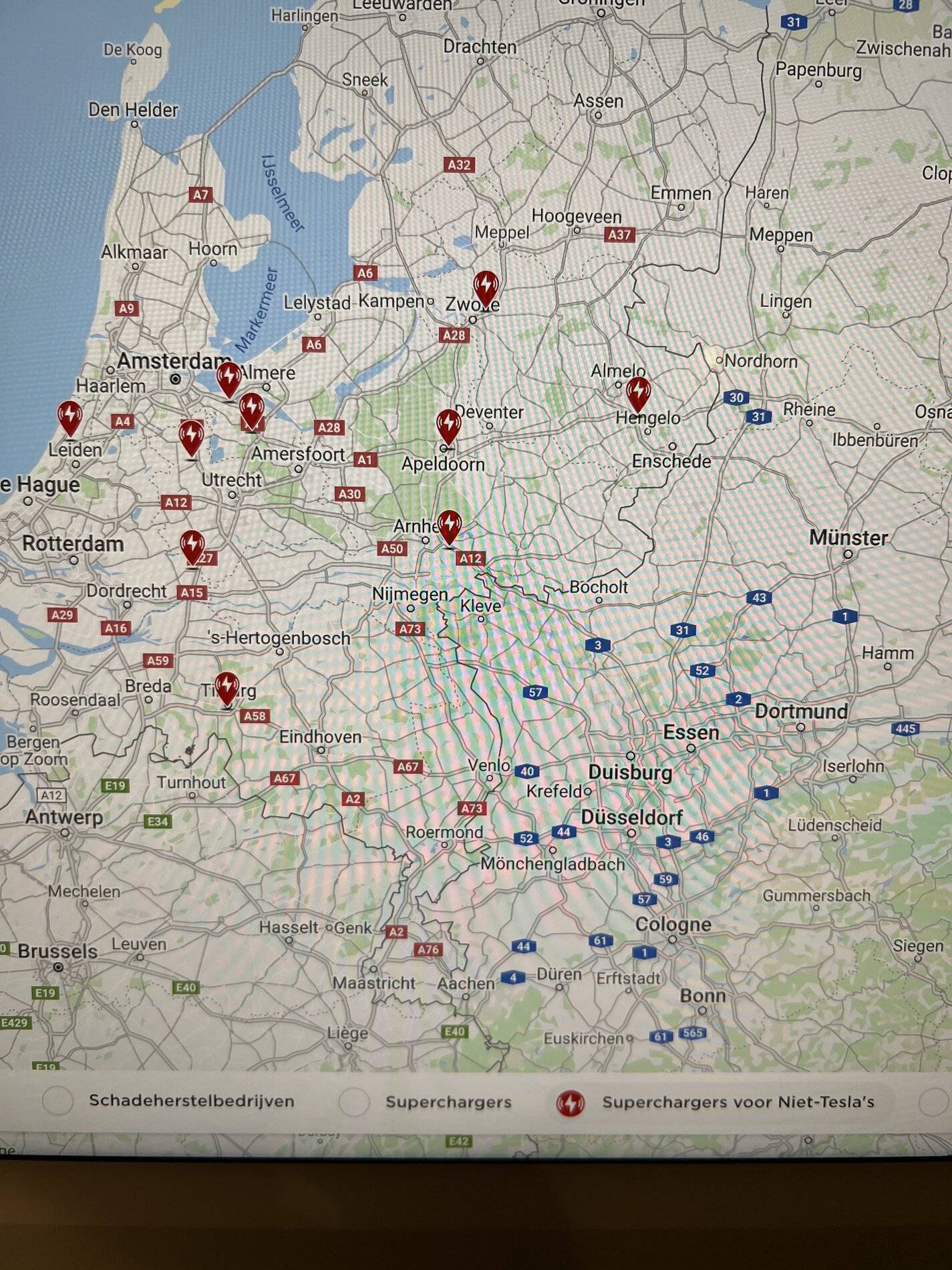

Teslas in the US and Korea have their proprietary ports, I think. I would love to know how Tesla would open up their chargers on said locations to other EV brands.
adapters and new charging stations with both wires

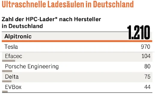

These are installed HPC charging piles per manufacturer in Germany. T already not relevant anymore!
