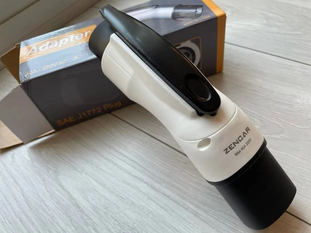

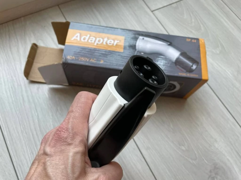

Just thought I'd contriubte -- I would imagine this product is available through Amazon in both USA and Canada.
It's a knock-off of the Tap, no brand-name ("Adapter"? "Zencar"?) and Amazon's sales page listed very little information about it. Cost about $199 CDN or $170 US, including s&h.
When I finally received it, I didn't have my hopes up. But after examining the unit it seems very well designed / built for the price. Amps are limited to 40A, so that will be something I need to consider.
I'll be trying it out this weekend on the Tesla L2 charger near my house, I'll let you know how it goes.
