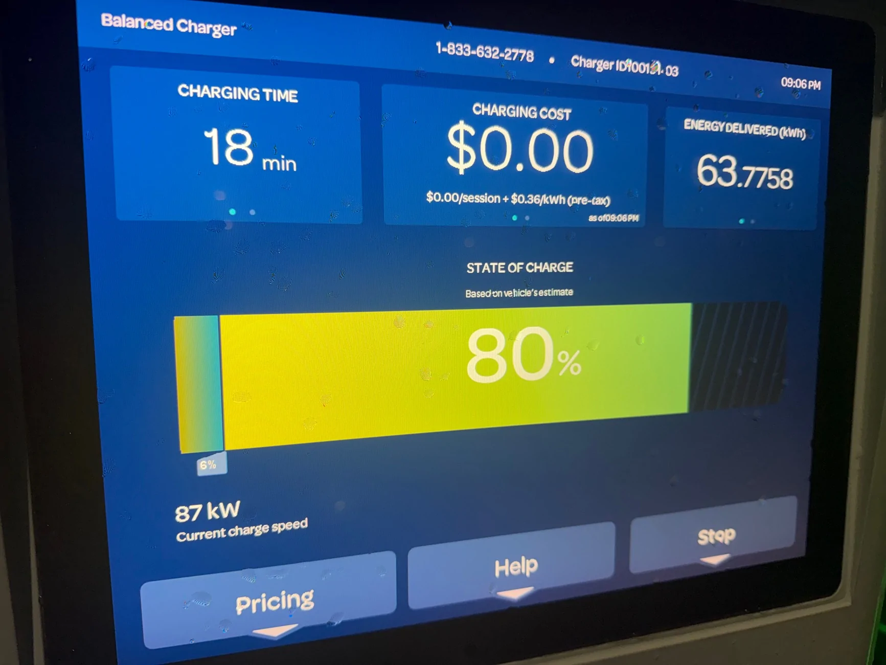

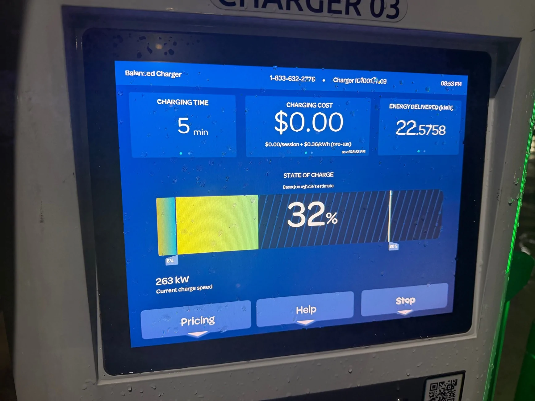

Yesterday, I drove 500 km with the Taycan, accompanied by a business friend who drives electric, too. (VW ID3 and Volvo)
He was literally enthusiastic, seeing the meter rush up to 243 kW in seconds, topping at 263 and maintaining the plateau until 40%.
Despite all the Chinese rumors about their cars charging up to a gazillion kW, the Taycan still is a charging monster out there.

And charging from 10-80 % is absolutely possible in 21-22 minutes.

I'm So jealous. I don't know what's up with my car, but I can never get >65kWh on 30mins of charging. I've used multiple EA stations. Sometimes at 3 in the AM when I'm the only one there. Doesn't matter if I start when my SOC is <10% or 30%. Sometimes it will start fast (265kw), but then slow down drastically, other times with will charge at a moderate rate (170kw), but hold longer. Either way I always end up around 55kWH to 62kWh. Even when precondition. The battery temp also usually stays under 109F.
This to me indicates that your battery friendly option might be turned on. Since without it being on, the battery reaches 130F+ like it is nothing.
I have done it both ways. When off, it will charge at 250 but only for a short time, maybe 10%. When turn on, it will max out at 200. But realistically 150. What’s funny is that no matter my starting state of charge it usually finish at 85% after 30mins.

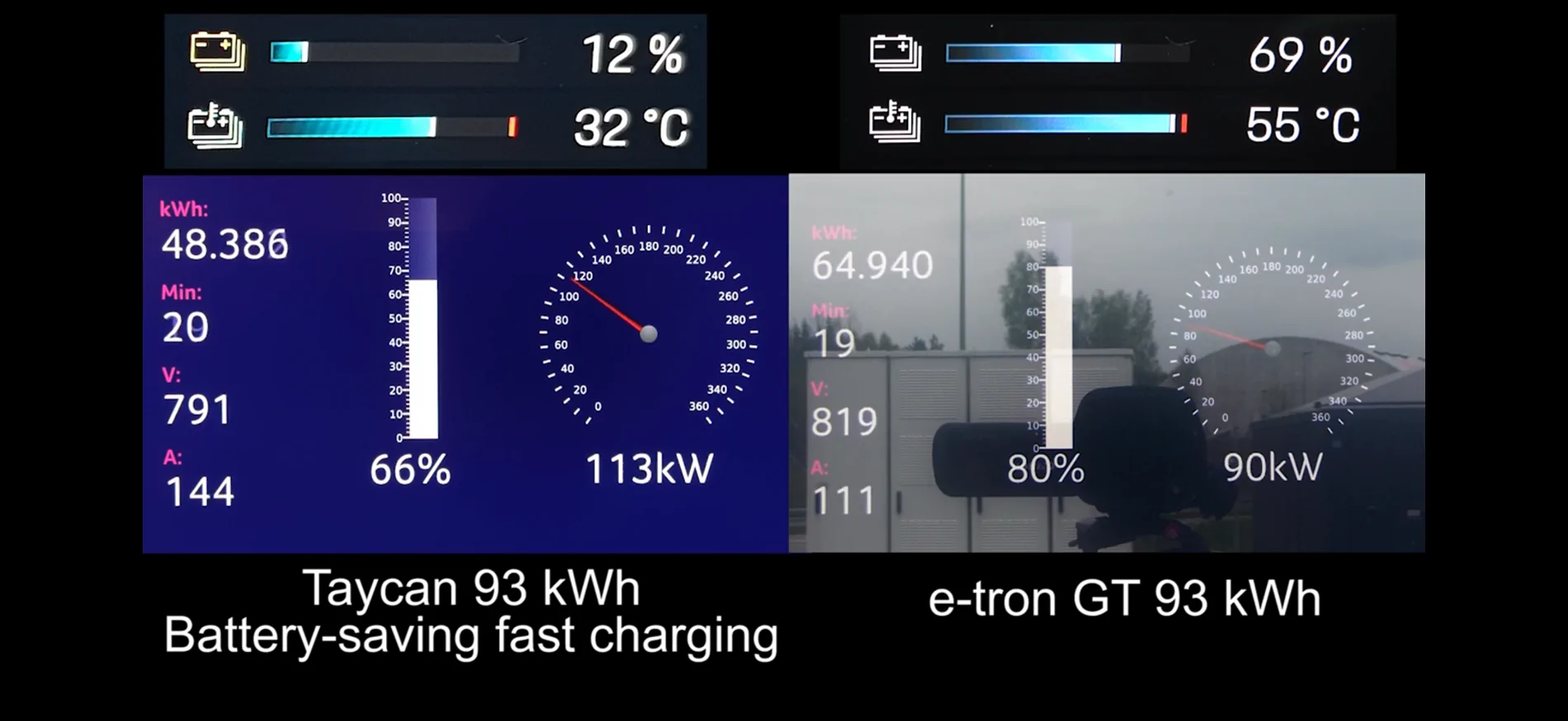

Ok, according to Bjørn's test, the full charge (95-100%) will need equal time.
It's really interesting, that eco-charging hold much better/higher kW above 80%.
But reaching 80% with fast-charging, eco-charging has only reached 66%.
As I stop charging around 80% most of the time, it would be significantly faster with full speed charging.
When the stop-over will be at least 30 min., there is indeed no need for fast-charging and eco-charging is as good.
Significantly fast by how much, 5 minutes? at 20 min mark Friendly is at 66% and non Friendly at 80%, and that margin is even smaller if you start at higher than 10% SoC. For 5 minutes, is it worth cooking the battery and other components? Then as you start driving with baked 130F+ battery, where do you think the energy will be going fast, to cooling it, so the 5 min advantage will evaporate in lost SoC faster than you know it since all systems will be in aggressive cooling mode.
