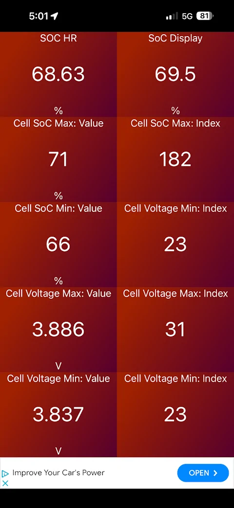

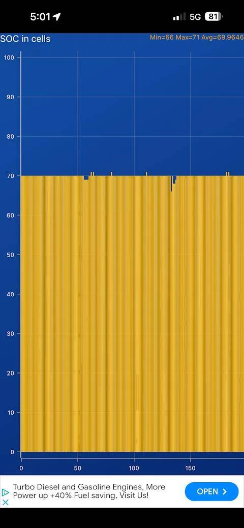

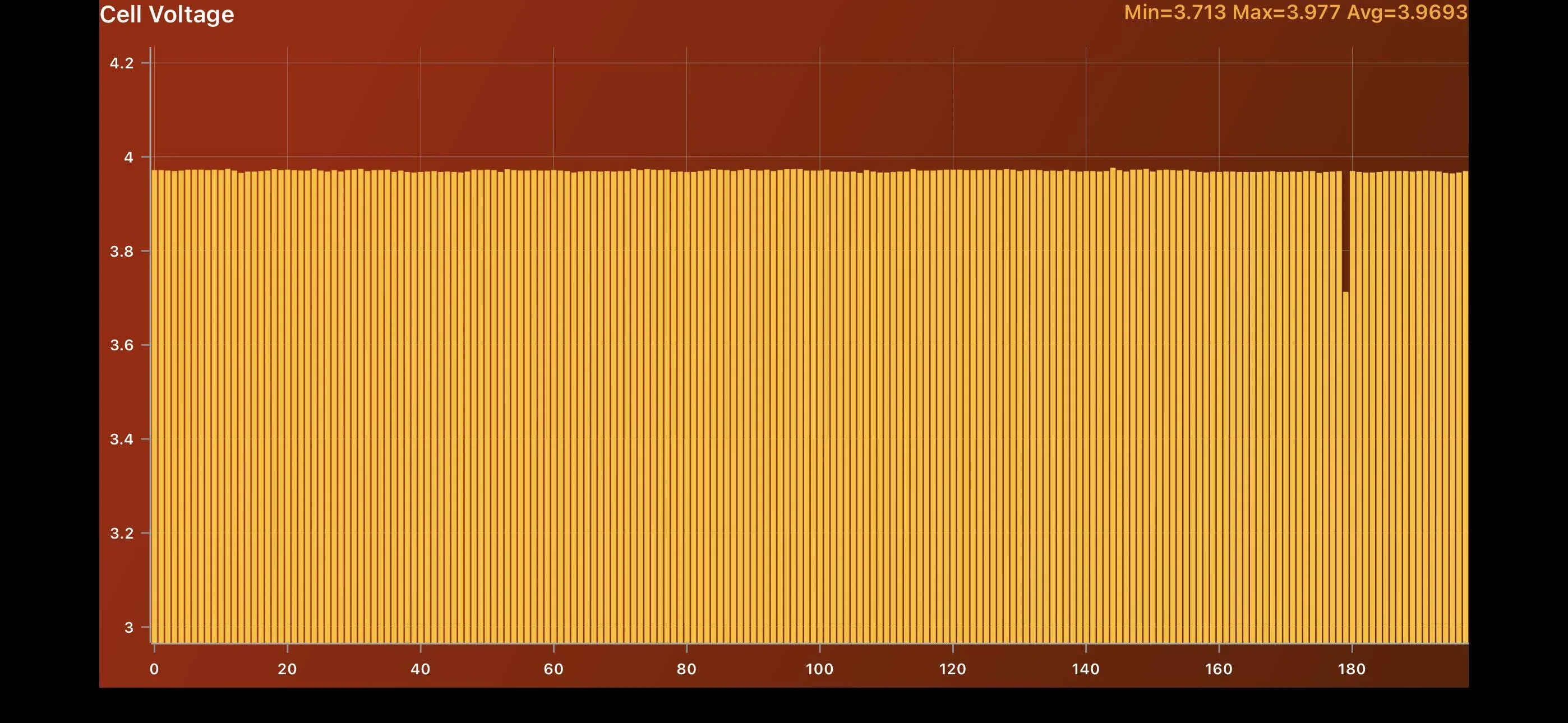

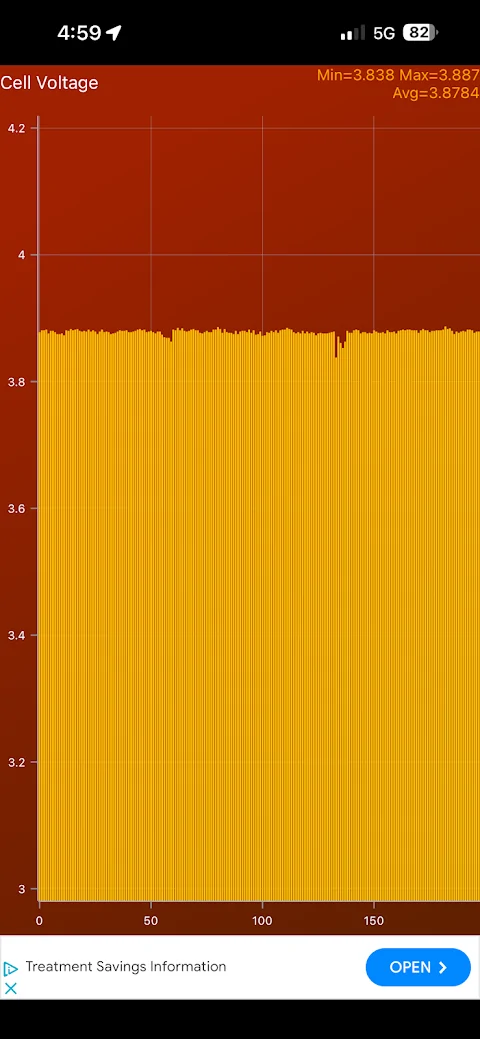

.... today I plugged in the VGate - and find this cell reading ..... any thoughts on this?

Doesn't look good, though I doubt you'll get the dealership to act on these readings. What I'd do is try @Vim Schrotnock algorithm to force the BMS to recalibrate at the bottom end: charge to full, drive/discharge to ~10% SoC, let sit overnight at that low state. Then charge again and re-take measurements.

In your picture of the cell volatages , how long time had the car been standing idle?

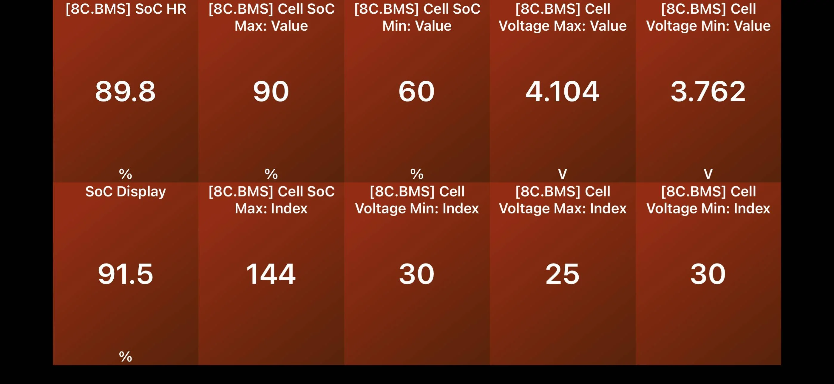

Looking at your data about max and min voltage your cell deviations seem to indicate about 0.05 volt, which do not sound too hefty to me. I had a reading of close to 0.35 volt before my battery collapsed. But still something to keep an eye on!
