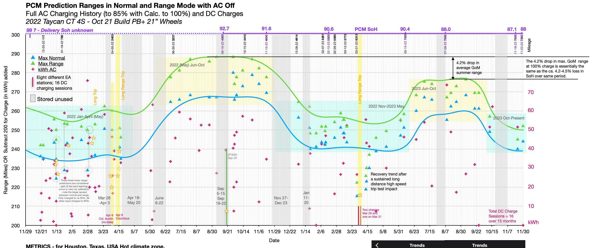

I purchased a 2021 CT 4S in June with 4k miles. Today I have 14k miles. When received, I was getting around 235 miles on a full charge. Normally I charge to 85-90%, however last night I charged to 100% and only got 201 miles. Am I experiencing battery degradation? Is there anything that can be done about it?
As stated by others above you will see seasonal variability (and ultimately of course some level of battery degradation is to be expected.
I've attached data from my car as an example of AC and DC charging history and predicted ranges displayed by the PCM - bit messy I know - please just ignore the data with crosses and stars - the Green (max range mode AC off) and Blue (Normal range mode AC off) triangles are the PCM's 'Guessometer' max. predicted ranges after charging to a theoretical 100% (I typically charge to 85%).
Point here is that there is a very clear annual Summer-Fall vs Winter Spring change in averages - the 'seasonal' average change is ca. 10% i.e. you'd typically see a 10% loss in range in winter vs summer - absolute amount clearly dependent on your climate (and other factors).
In my case being in an 'extreme' hot climate I also in fact am seeing slightly accelerated degradation (reduction in SoH) as compared to cars being operated in cooler climates.
