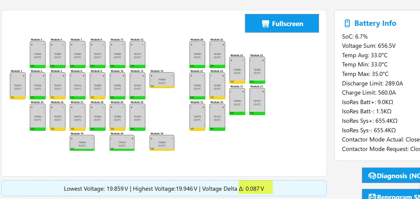

My '22 turbo was getting 200 mi @ 80%, then dropped to 190, then 180. So I decided to rebalance the cells for the first time (drove down to 0% and 1 mile remaining), then it went back up to 190. The second rebalance was by accident since I didn't have enough juice to get home, it went down to 0% and a negative 2 or 3 miles remaining (turtle mode). Just charged to 80% today and got 202 miles. I highly recommend you rebalance the cells.

When you get a chance I'd love to hear how you did that (if it's more complicated than driving to 0%) and the source for that process (read it online, in the Porsche owners manual, etc.).
I ask because I asked my dealer about rebalancing after seeing another thread on this and was told the car does that automatically and you cannot rebalance it manually. The dealer has given me bad info several times so I'm interested in your experience.
Follow the instructions on the first page of this thread.
I took this after driving it down to 0% and waited 6.5hrs per instructions on the first rebalance process. As you can see, they're way out of balance. This is when the range dropped to its lowest in 3.5 years.
Porsche Taycan 4s - 2021 Battery degradation : 84 % 1758318568996-7i

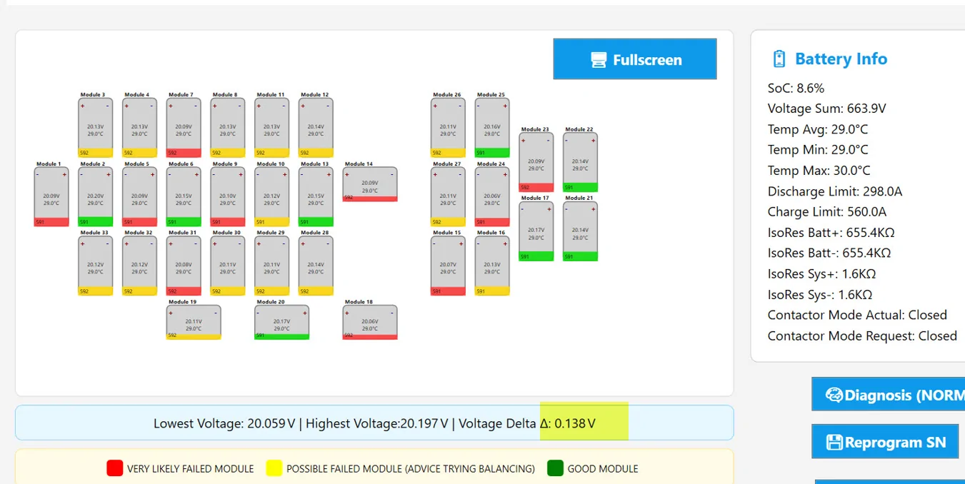

This is the from the second rebalance 2 months later on 9/6/25. The cells stayed within specs per Kris, the developer of the software.
Porsche Taycan 4s - 2021 Battery degradation : 84 % 1758318753533-kx
I pay more attention to these when the SOC is at its lowest because when they high, I think they mask the imbalance.

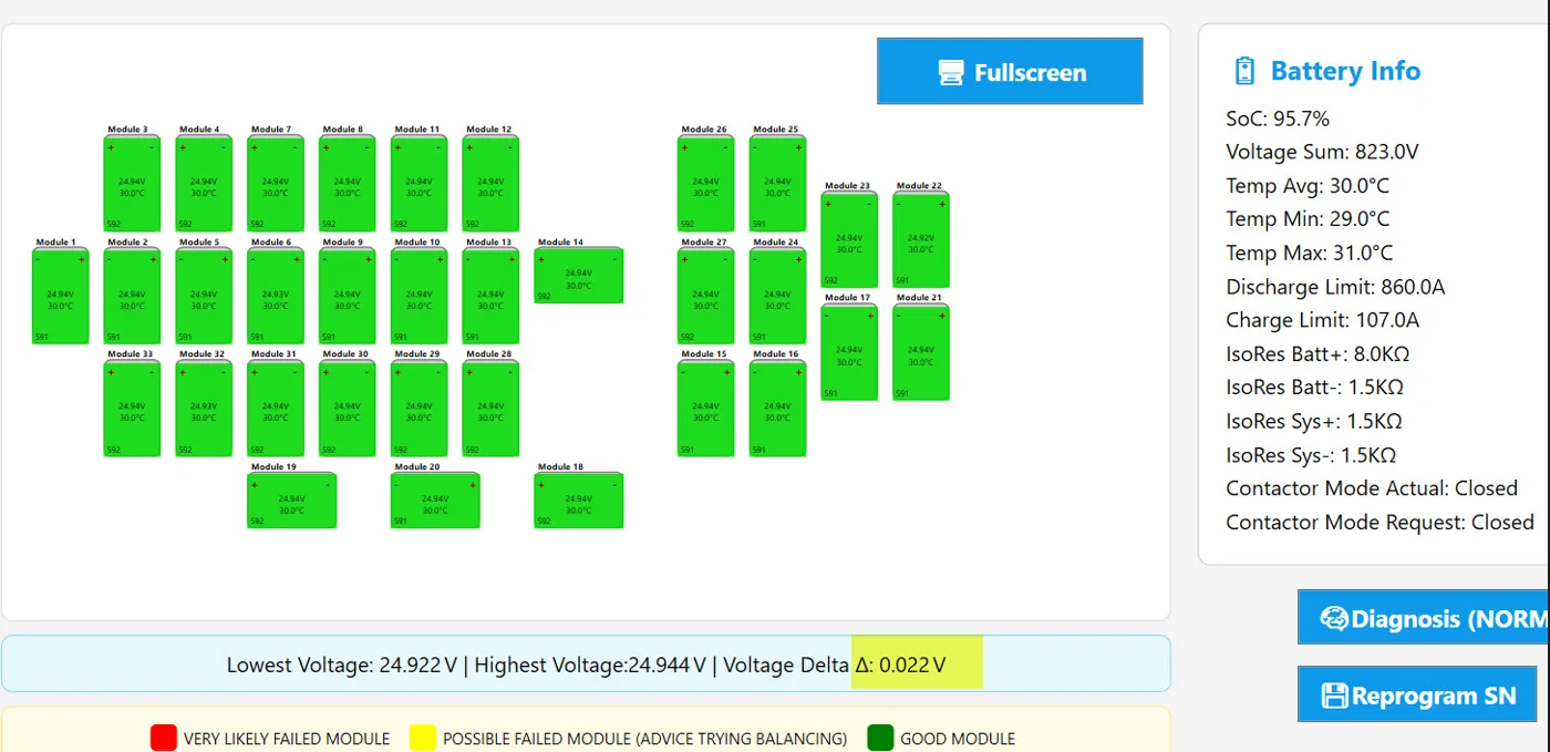

After charging to 100% and waited 6.5hrs.
Porsche Taycan 4s - 2021 Battery degradation : 84 % 1758319081126-pt

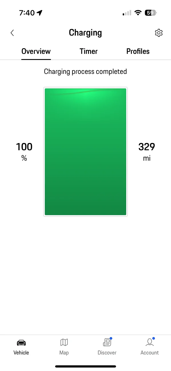

I have a 2020 4S (from new) with 10,000 miles of mixed driving. I charge at home to 100%. Please see range from overnight charging:
Impressive! Does the range drop as soon as you start driving?

I mean as soon as you start driving when you have a 329 mile range showing: does the range fall to something more realistic? Presumably you never actually achieve 329 miles on a charge - ?
Tcar20
Jul 31, 2020
Boston
it does start to fall immediately….but I have done 311 miles (at or above highway speed limits) on a single charge.
